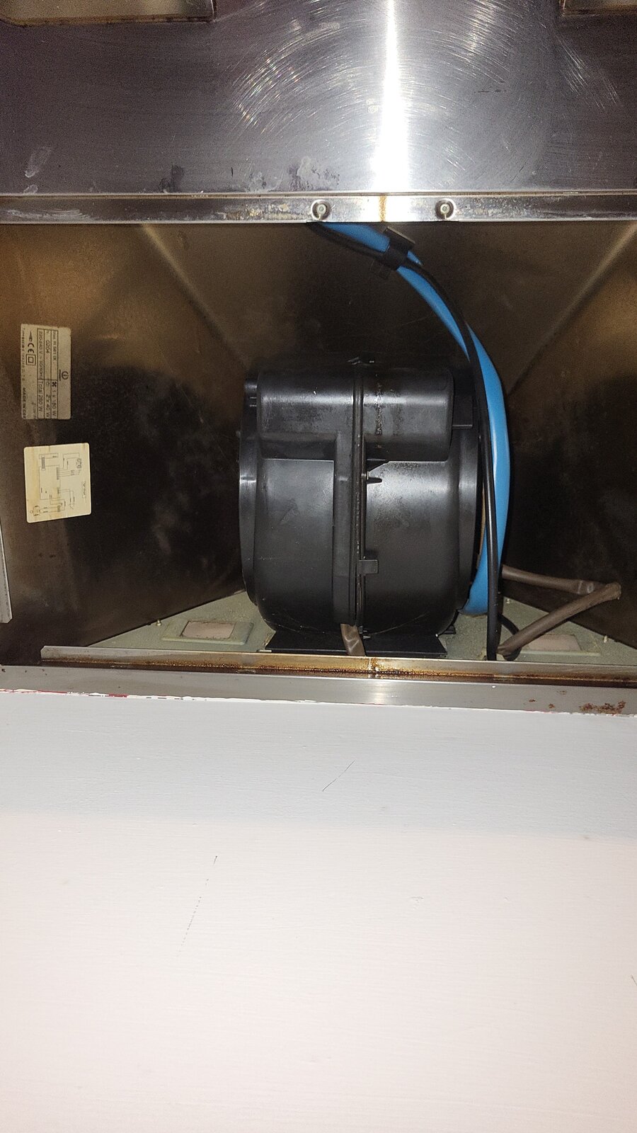

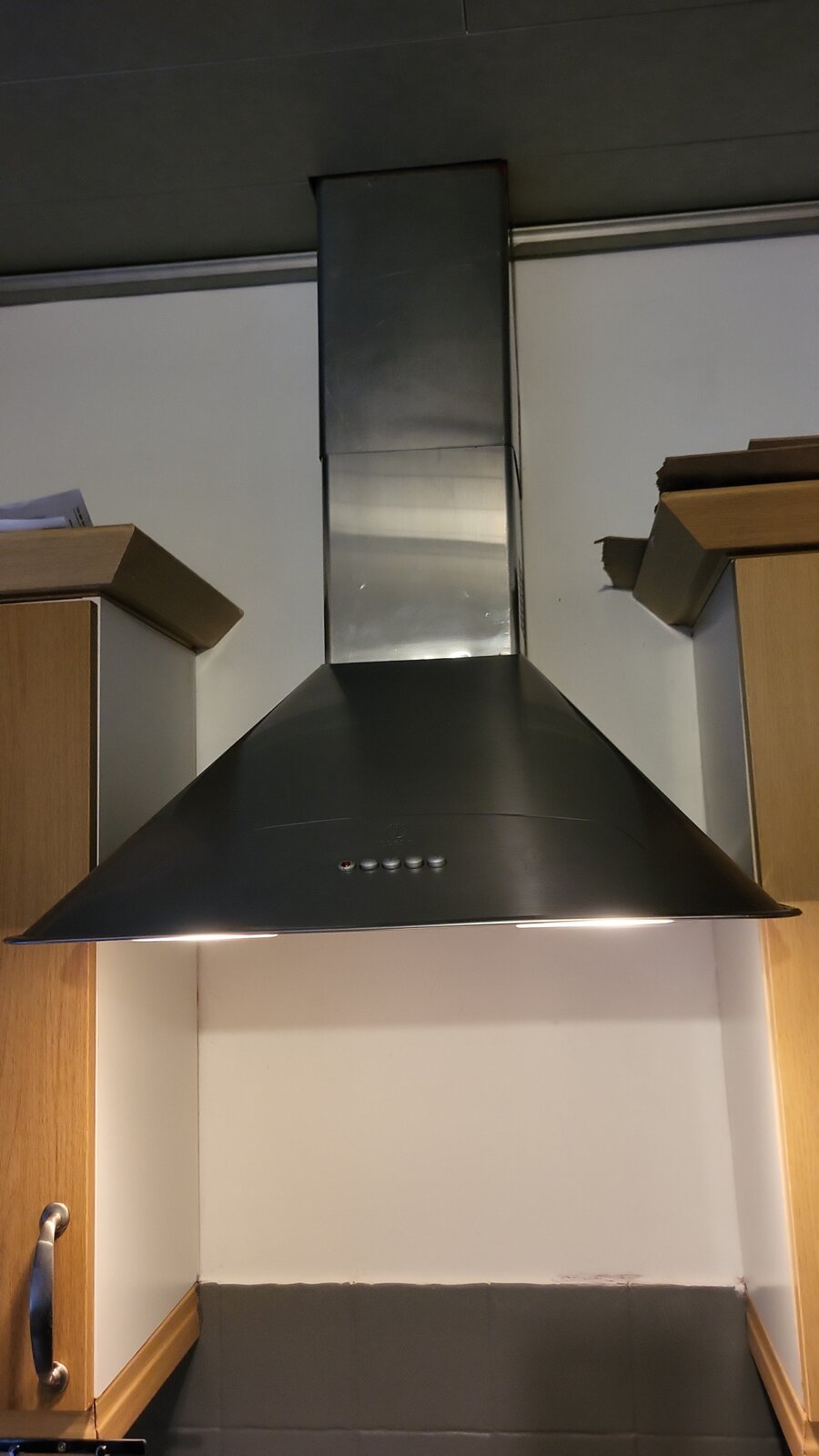

We have moved into a new property and the cooker exhaust hood has failed and only the light comes on.
So we were thinking to buy a new one.
The current one is a exhaust hood that operates on a recirculating system, meaning it filters and recirculates the air rather than venting it outside.
Indesit H 561 IX​
The Indesit H 561 IX is an exhaust hood with a height of 810 millimeters, a width of 600 millimeters, and a depth of 515 millimeters
So we wanted to get a new one that will work. So do we need to make sure that a new one will operate on a recirculating system as I think the current one didn't operate on a extraction though the chimney etc?
We can't do more on the width but can a little on the depth.
Can anyone help with some links to some on argos, wikes etc that would be a suitable replacement please?
We also need to make sure we get one that comes with the carbon filters or they can be easily bought atleast alongside it and anyother essential parts that are needed so we don't find ourselves fitting a fan and not able to operate as it doesn't come with all necessary parts.

Guessing we would need someone to put a hole through the wall for an extractor event.
With gas you have combustion products so no real option, you need a vented cooker hood, so either switch to electric, or vented cooker hood, I cook with a induction electric and to be frank hardly ever turn the fans on, use the lights, but not fans, the hob has auto boil/simmer option so can set it so once it has boiled it auto turns down, so very little steam. Gas has not got the automated controls of electric, it lacks a lot, child locks which are standard with most induction hobs, slower than induction, and can't turn down as low as induction, however you can use them with a wok, the wok's for induction hobs are too heavy.
But main point is burning gas produces water, and of course CO² so no option with gas need a flue on the cooker hob.

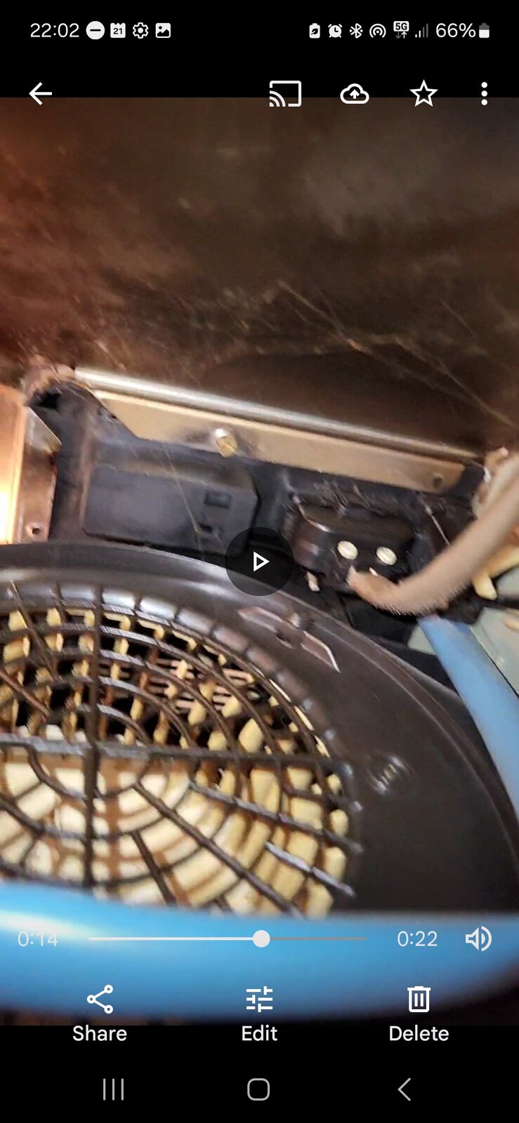

Are you sure there is no vent through the wall behind the chimney. I can't really see how that one would act as a recirculating one. Looking at the picture the fan impeller and motor bearings may just want degreasing and lubricating rather than a new assembly.

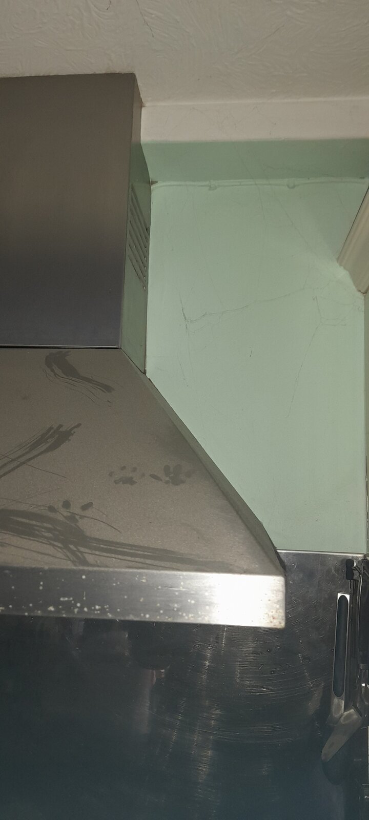

Thanks. The chimney is almost at the other side of house. Although the boiler is right next to the cooker hood and the boiler is vented outside so maybe the cooker hood is vented with the cooker hood?
How can I check to see if the cooker hood is vented?
How so I degrease and lube the current cooker hood?
The boiler can’t share its vent with anything else.
Looking outside is the answer
Sorry but if you need to ask those questions then I would suggest you perhaps get an electrician to look at it.
Loosen/remove that stainless chimney and post a picture of what is there.
Thanks. Tried to move the chimney ie the upper part near the top and wiggled a few things around under the hood and all of a sudden the extractor fan started to work again. The noise started and you can feel the air inside of it.
Would love to know if it's connected to anything external out of curiosity but now it's working again I'm scared to move anything on it again

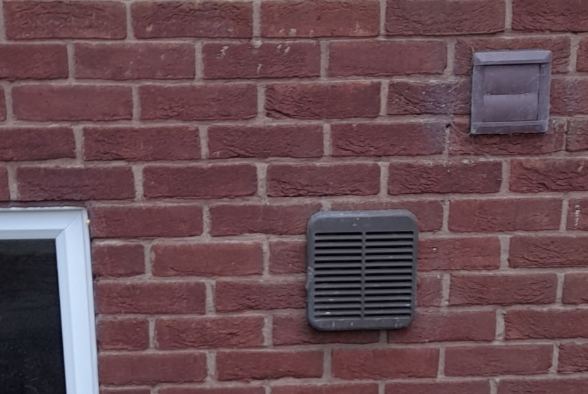

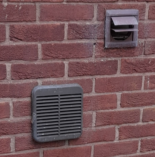

I do see your point, if not broke, don't try to mend it. But any vent must some where go outside. Often there is some sort of flap, my house 1717067313174.png with fan not running and 1717067360198.png with fan running and inside 1717067525507.jpeg one can see the duct going to outside wall, the flaps in centre picture show it is doing as designed and sending air outside and no filters are blocked.
