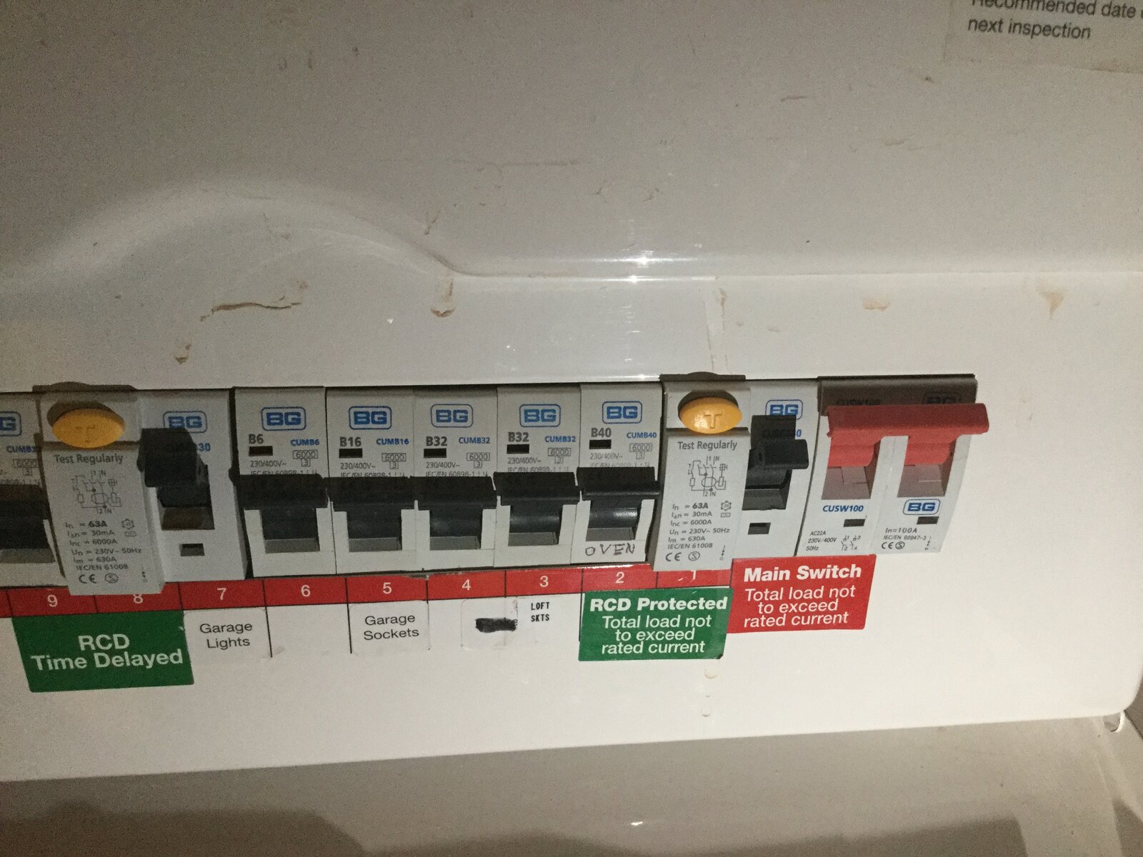

What circuit in your consumer unit is the fused connection unit a part of ? Can you show us some pics ( full consumer unit showing all circuit breakers)

Ok here’s a picture of consumer unit, oven written on breaker switch, the hob and oven are wired to a 13amp spur switch which is then wired to the consumer unit, this is all becoming clear to me now that maybe someone has used a 13amp spur instead of a cooker switch? so can I assume that it’s safe to replace this 13amp spur with both hob and oven wired to a suitable cooker switch?
Is the fused connection unit connected to that circuit marked " oven" ?
If you flip that breaker to off ,what no longer works in the premises ?

If, per terryplumb's question you can confirm that breaker labelled 'oven' is supplying the oven+hob, (via that 13A FCU ('fused switch') then yes.

If, as seems to be the case, the 13A FCU is fed by that B40 (labelled 'oven') then it appears to be RCD-protected ... but who knows what cable has been used for the circuit?

And get them to look at the consumer unit / labelling as that doesn’t bode well for the rest of the installation either
