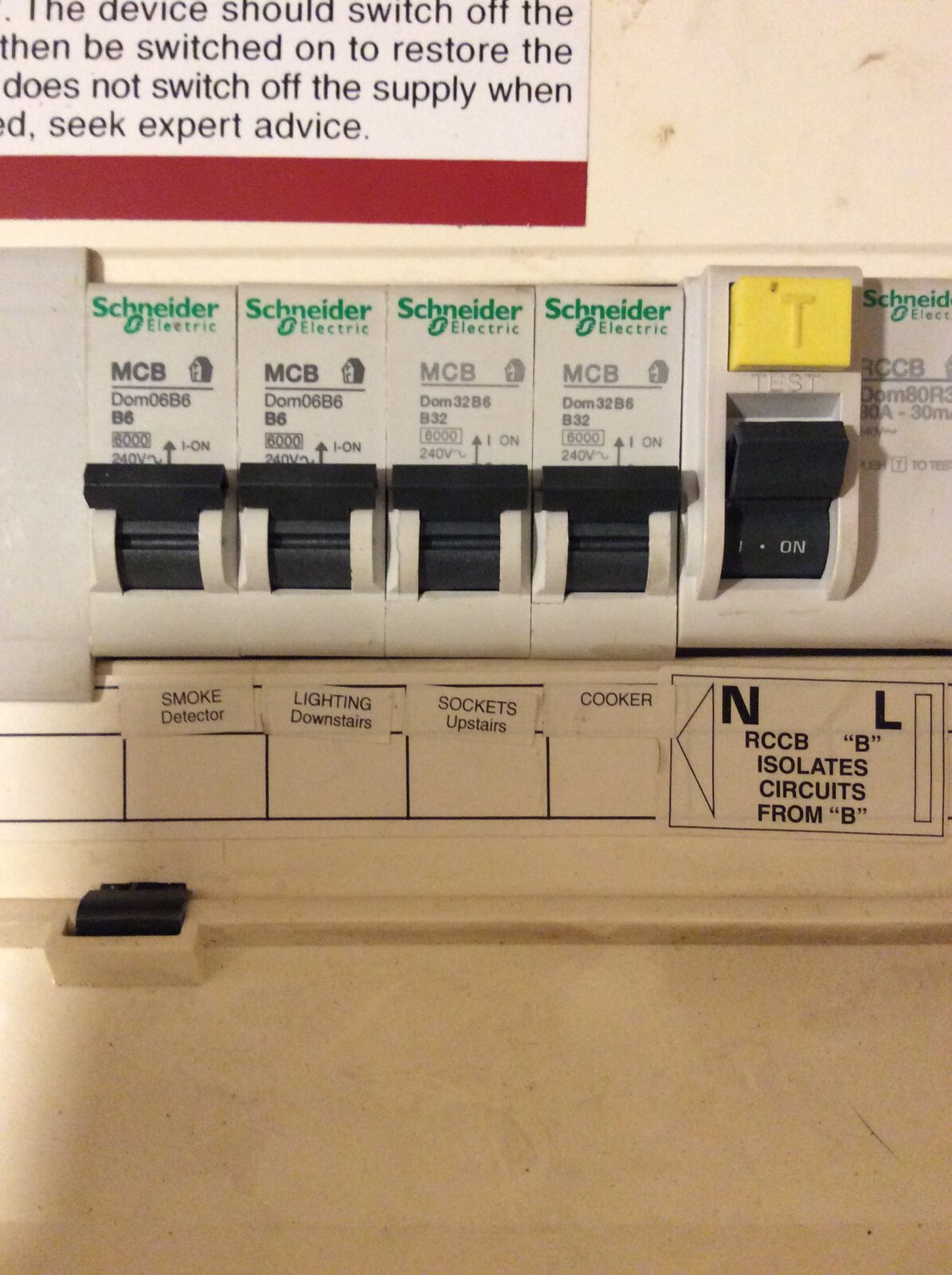

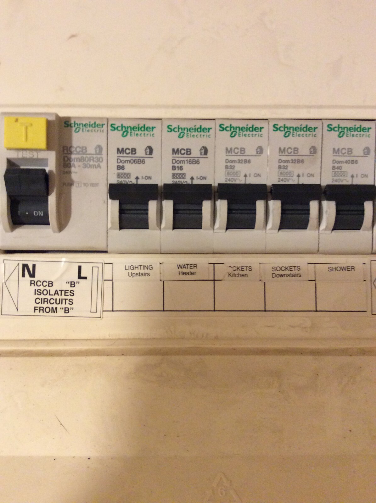

My cooker has a dodgy element in the fan oven ( I use the top oven now) However when it trips the upstairs/downstairs lights go off I am no electrician however this seems bonkers to me ! Any info advice would be greatly appreciated
show us a photo of your consumer unit, with the flap open, close enough to read the incriptions on, and labels over, the individual breakers, please.

Yes I’m sure I was in the living room watching tv with lights on I went to check the food upstairs lights were off and so we’re the kitchen lights and cooker the fridge was still on which is plugged into a socket.
As you say you are no electrician & cannot work out the problem it is difficult for anyone to say from your pics. other than something is not as it should be & you should call an electrician in.
Use the oven to force a trip, and then
(Without resetting anything)
So we can see what has tripped.
