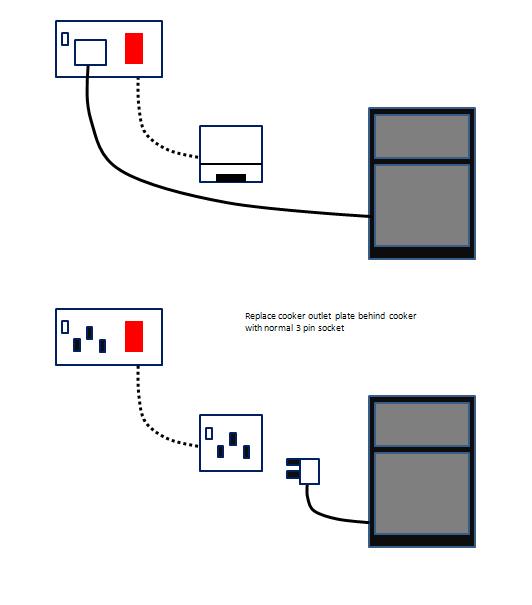

I'm not at home right now otherwise a photo would be easier, but this is a diagram (no laughs!) of what I currently have and what I want to do.
I'm a bit worried that there will be a load issue. Is it ok to turn the existing (dormant) outlet from the cooker switch into a 3 pin plug socket? Will the cooker be fed too much power?
Like I have said before the power is needed to the cooker only for the timer/light etc not for cooking as it is a gas cooker.
Simon
Simon
What you propose is fine - provided the plug is fused to the correct level as per manufacturers instructions and you feel confident in changing the fcu to a socket.
As for load - a clock and a sparker are not going to trouble the scorers.
No.
Think about it - it's already plugged into a socket which is on the cooker circuit.
And what's the rating of the fuses/MCBs supplying all your other socket circuits anyway?
