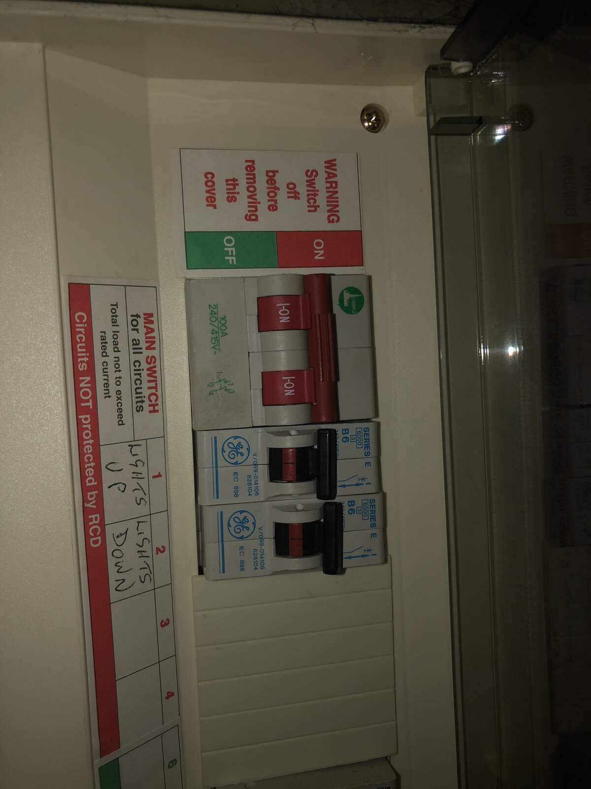

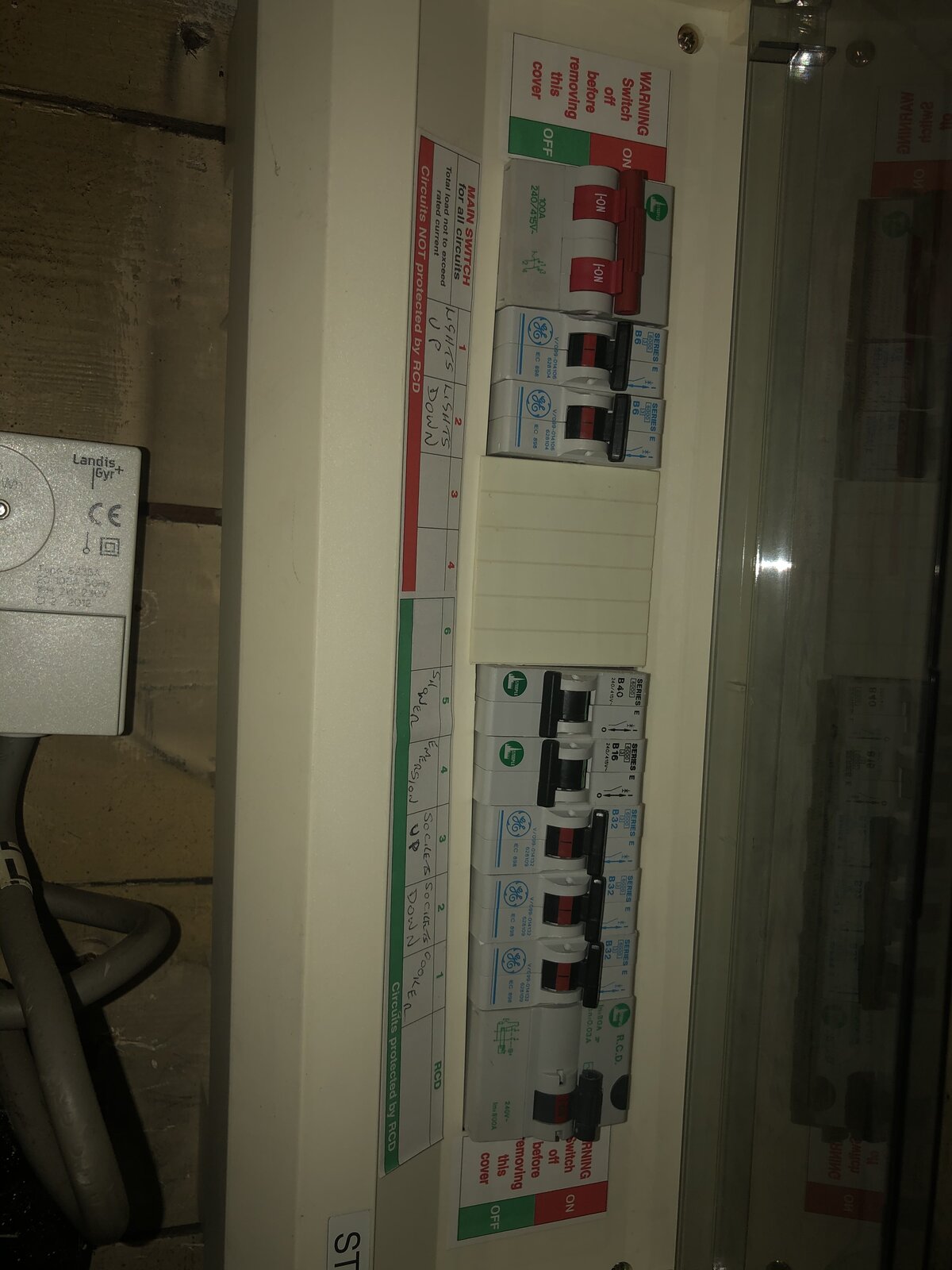

Hi,
This evening while making tea, the electric tripped out, the oven now has no heat so I suspect that was the issue.
We have a free standing cooker/grill/oven, there is 1 wire that connects to the appliance.
On my fuse board (I suspect that’s not the correct name for it) their is a switch for cooker and an unlabelled switch. It was this unlabelled switch that needed re-setting.
Is my cooker wired through 2 switches or is it likely it has been re-wired in to a new switch and the old switch not taken out?
By the cooker there is 2 switches and a plug socket, 1 switch is for the cooker, the other switch for the plug socket. Is it possible the cooker switch on my fuse board is for the plug socket?
Pics below.

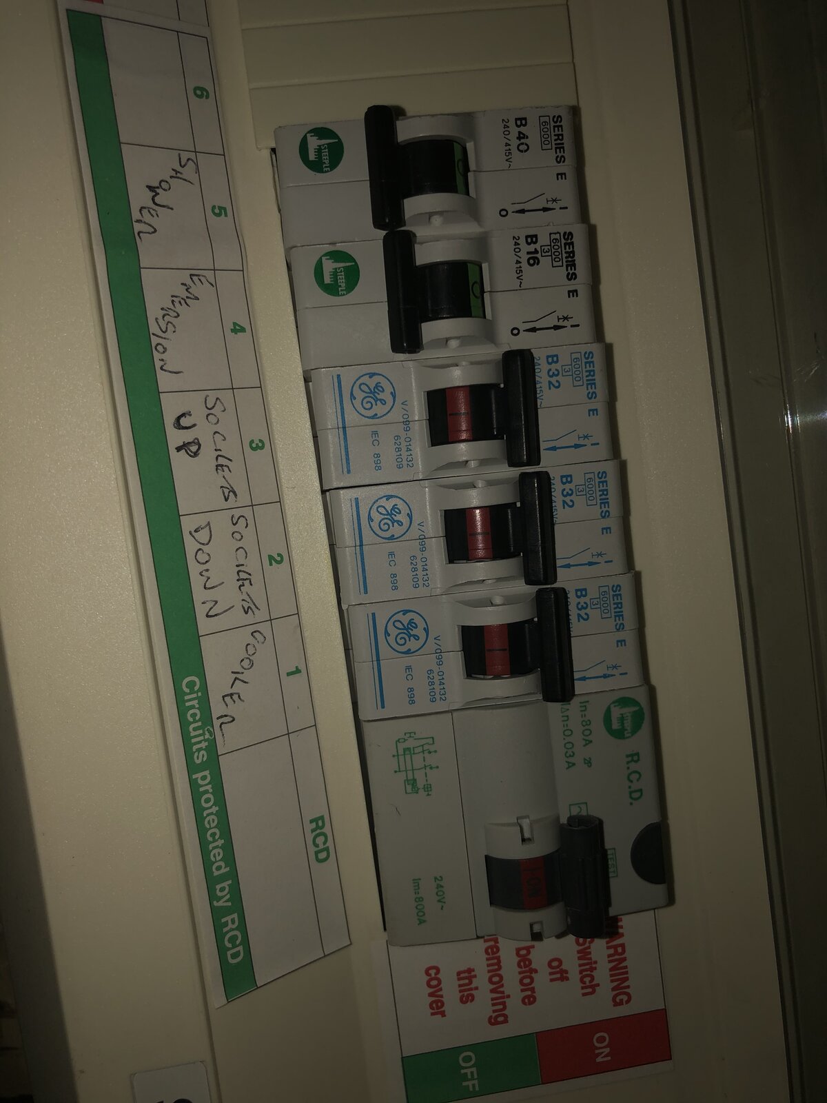

The device To the right of the MCB' marked cooker,is an RCD. That RCD supplies / protects all 5 of the MCB's on the left of it.
If by unlabeled switch you are referring to the one marked RCD, then that will trip if there is an earth fault on any of the five circuits protected by RCD with the green strip underneath. If this trips when the cooker is being used it normally indicates that one of the cooker elements has failed and created an earth fault.
Ok, I didn’t realise they done different things, I thought it was just a bigger version capable of more power.
So if an earth problem occurs the RCD trips, if it’s another problem the MCB trips?
Just out of interest, from the pic, is there enough info to see what my cooker is rated at?
Actually it's the other way around.
MCB's will trip when there is an overload and their current rating is exceeded.
RCD's will trip when there is a tiny earth fault only milliamps
No idea what your cooker is rated at, you would have to consult its instruction manual or rating plate to determine that. However, the MCB it is connected to is rated at 32A as is printed on it.

An RCD trip is quite common when the heating element in an oven or grill erodes with age. It is a replaceable part.

Looking at your set-up, it appears to be installed at the time the 16th Edition of the Regulations were in force (typically due to it been a standard 'Split-Load' Consumer Unit with a normal Mains Switch for circuits not protected by an RCD, whilst other circuits considered more 'Risky' (as someone else has already mentioned), protected by an RCD).
The 16th Edition was, I am fairly sure, introduced in 1991 (although may have actually came into force around 1992) and remained in force until 2008 (when the 17th Edition was introduced).
Therefore, a good, although fairly rough estimate, would date it at around 15-30 years old.
If anybody has an idea of when the style of your Consumer Unit, MCBs and RCDs were introduced, they may be able to narrow it down a bit.
