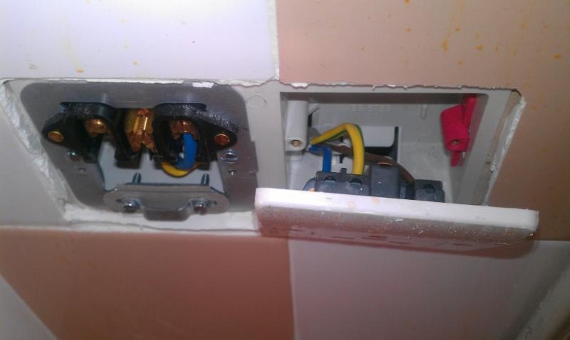

Hi again,
Can someone give me a little more advice please. Have a look at these photos:
Judging by these, is there now any way I can power a cooker hood and if so how?
They seem connected but why would they just not use the existing [now blanked off] socket instead of putting the new one in to power the cooker?
the one on the left is a cooker connection unit.
if you look at the bottom of the plastic faceplate there will be a gap for the cooker cable to come out of
if you have a 32a mcb for this circuit at the fuseboard (I didnt check the rest of the thread thoroughly enough) put both of these cables into the supply side of an FCU as planned, and then your new cable into the load side, job done.
