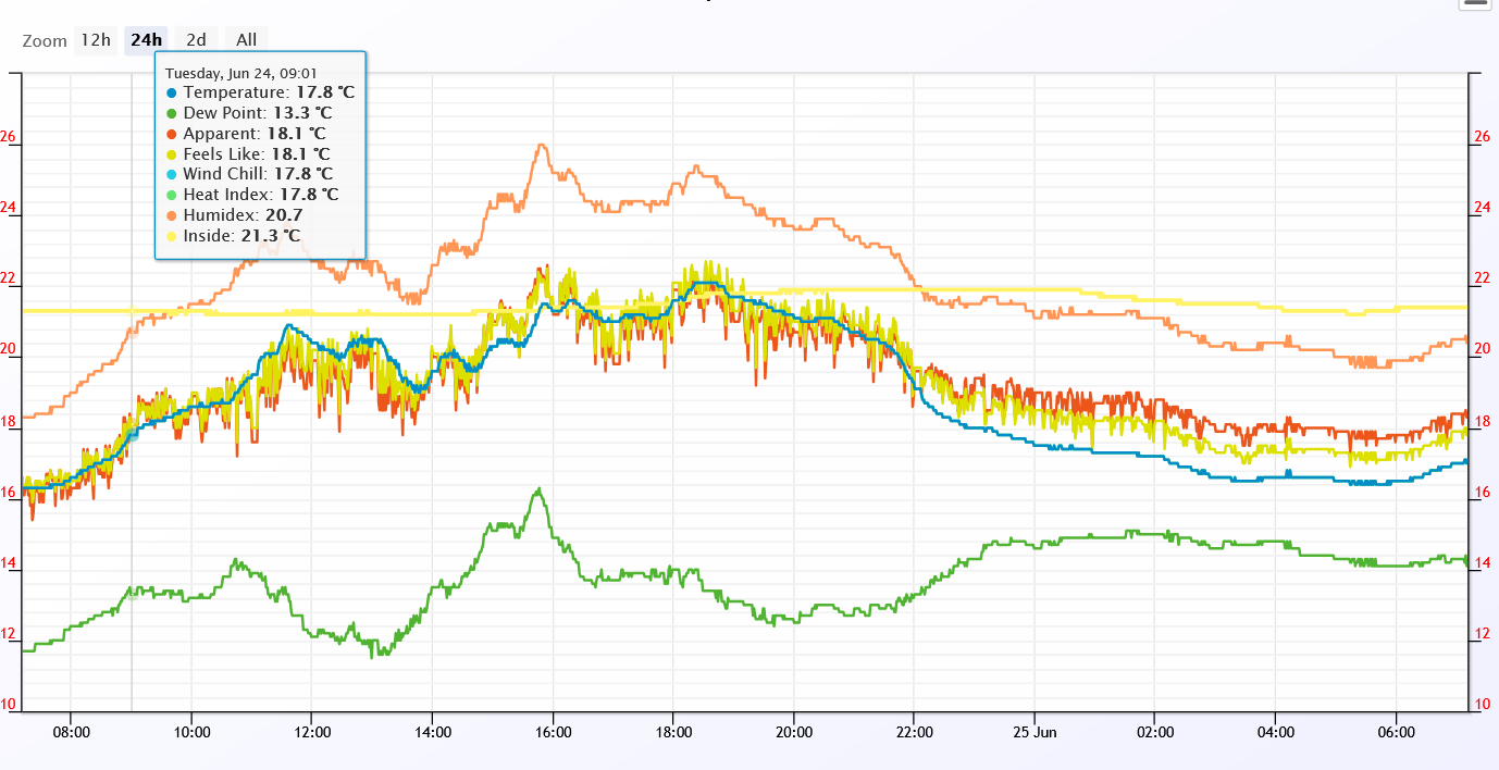

Quantify eventually. What temperature do you expect the internal wall surface to be during the heat of the day, on a robustly insulated cavity wall?
You wanted graphs? This is my home's temperature graphs for the past 24 hours. The yellow represents the indoor temperature, the blue the outdoor.
My too hot weather regime, is one of closing windows, drawing blinds to limit solar gain, just having a fly screened back door open for ventilation.
My home is reasonably well insulated, hence the yellow line is fairly flat, but it does drift slowly up, as the outdoor temperature increases. Come bedtime, at around 11pm, the windows are opened to vent the heat gain (despite the insulation) from the day/human activity/use of appliances.
You will note - insulation can delay temperature rises, and falls, but it can only delay the inevitable, and smooth out the average.
Not what I asked is it.
Any house can be hotter than satans A'hole as long as it has window, in spite of insulation.
I asked you to demonstrate heat transfer through a robustly insulated cavity wall, during a regular hot day scenario. I'd like to see this 'inevitable' heat through the insulation you blathered about.
You are still demonstrating a complete lack of understanding of the subject.
The fact that you keep using the phrase robustly insulated cavity wall, shows you haven't a clue.
Why do you think in hot countries they don't insulate the roof? Insulation slows heat transfer, it does not stop it, unless the U-value is zero.
That I did, more than adequately, with coloured pictures. The inevitable heat rise, shows in the yellow line, but only for those who would see. Should I try crayons next?

What is the U value of a robustly insulated wall?
Surely, that heat could be coming through the window glass and be unrelated to the effects of insulation?
Insulation is a meaningless term unless it is expressed in terms of thermal transmittance.
If you built a box out of 2 x 100mm PIR, it has an extremely low thermal conductivity of 0.02
pop a thermometer inside and leave your box out in 30 degree sun. The temperature will rise and when the sun goes down and the air outside cools it will also cool.
If you repeat the test with 1 x 10mm PIR it has a much higher thermal conductivity of 0.75 The temperature will rise and fall much faster than the first box.
Unless your "insulation" has thermal conductivity of 0, thermal transfer will occur, until the temperature outside is the same as the temperature inside.
If you have more hours of hot than hours of cold, guess which box will be cooler?
Of course, which was why I mentioned that, plus human activity, and use of appliances in the home, in my post #351. However, even without those effects, no windows, no humans, no appliances running - heat and cold will still seep through the insulation, no matter 'how robust' the insulation installed, it will, without any doubt seep through - basic physics, which most learn, as five-year-olds.
