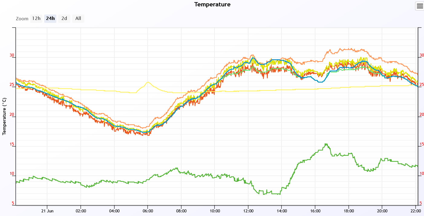

Here is today's temperature graph. Yellow internal, blue external, showing a sudden fall at 16:20, when we had a few drops of rain delivered.
I've been puzzled by that sudden hump, in the yellow trace, for the indoor temperature log, at around 5:30 am. I have just worked it out, it was due to me, closing the the front and rear windows. I have a similar trace, and rise, for this morning. The rise is the heat rise, from the internal house fabric.
