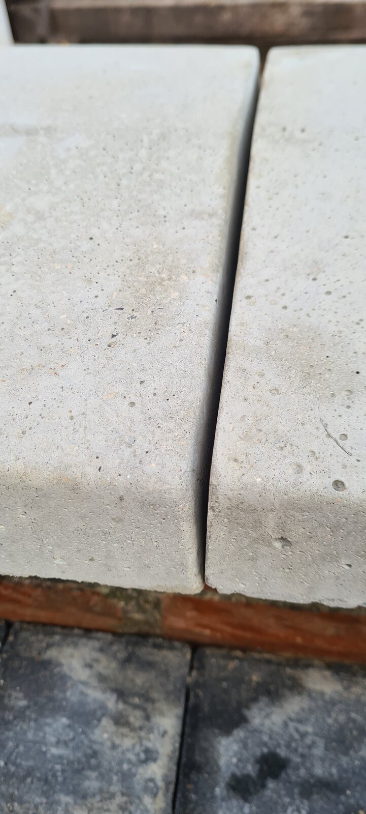

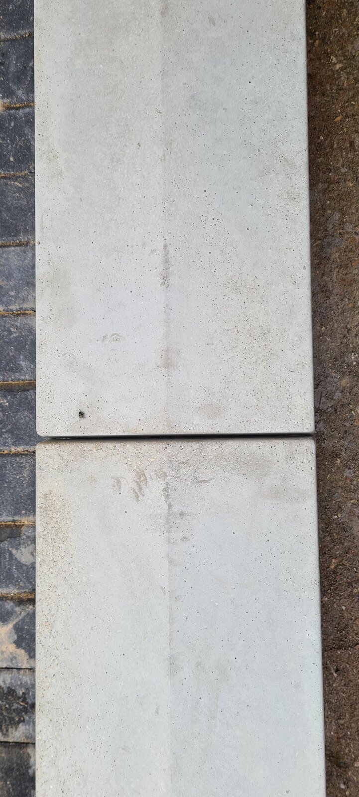

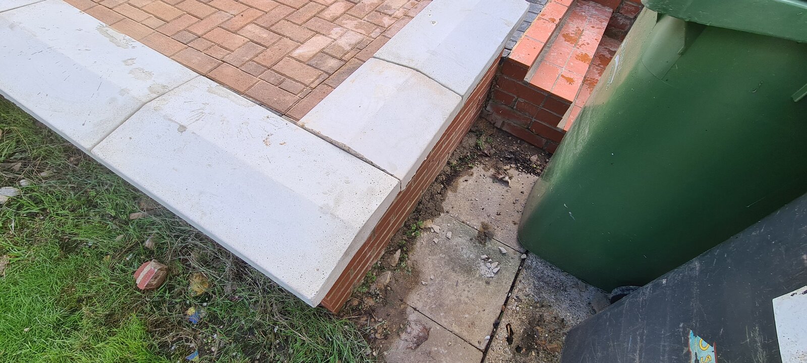

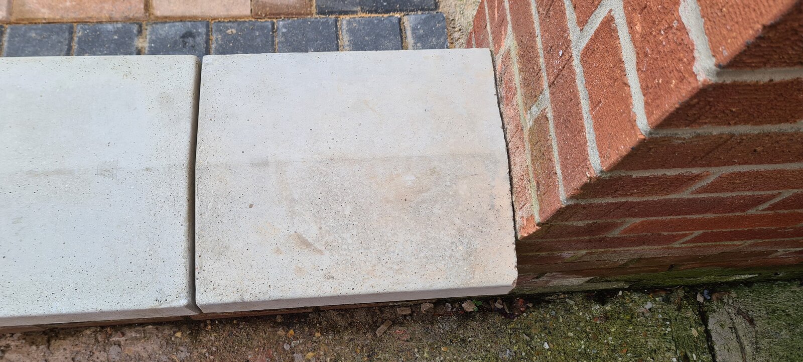

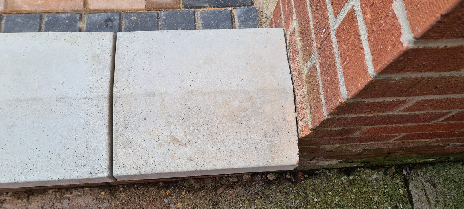

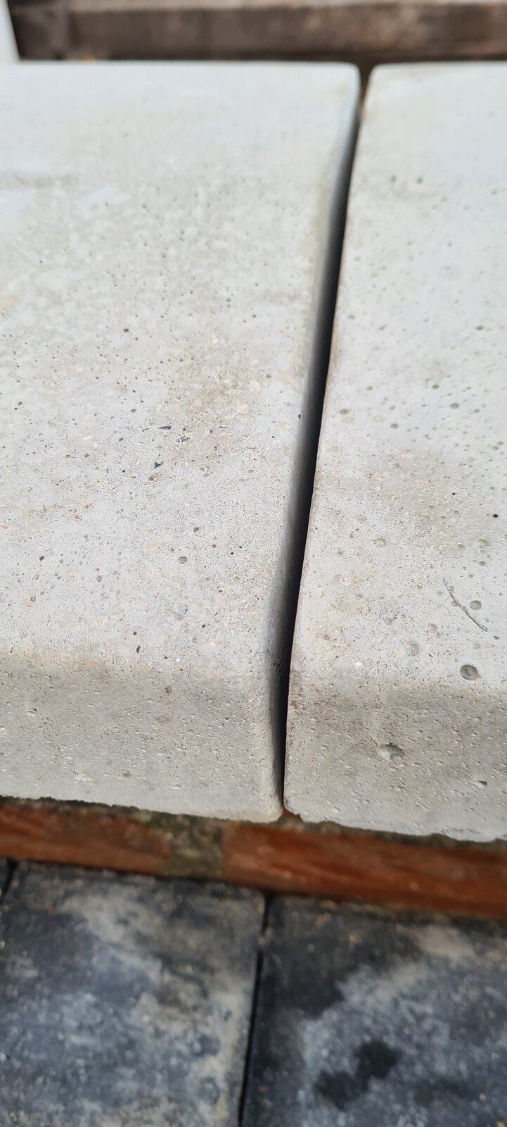

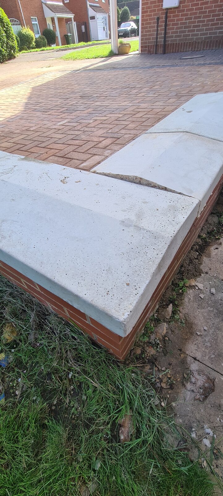

Just had some coping stones fitted to my driveway wall.
Q1 Surely they should be pointed??
Q2 This corner is a bodge job and should be 45 degree angle to both of them?
Q3 Should there be a DPC under them?
Q4 I did not see it but do the stones need a seal before applying to the mortar (You tube video...)

No Dpc required.
They do not need sealed..a dampen down helps though.
Yes to pointing and mitred corner.
