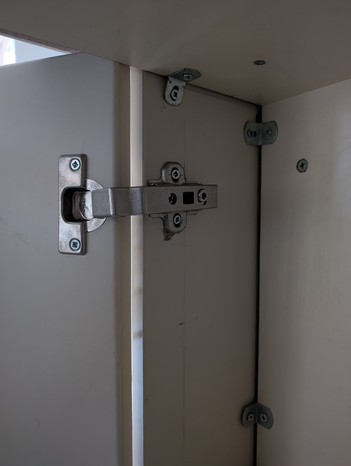

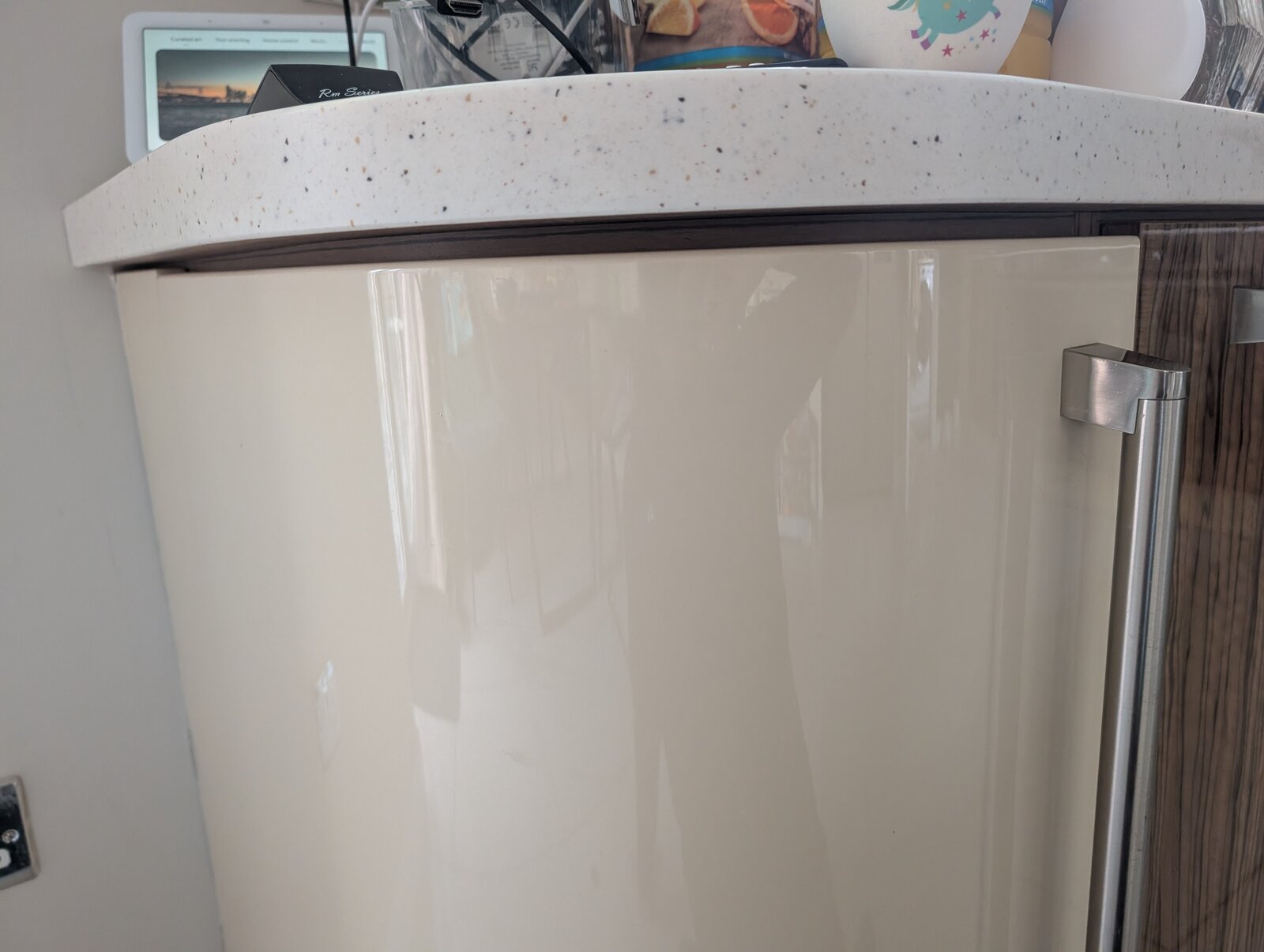

Hi all,
How do I go about adjusting these doors so that they are level or is it just the weight of the door causing it to drop? Assume there must be some way?
If i manually lift it the door up I see the middle parts of the hingle lift but there is no way to keep them held in that position
Might be the photo but the hinge mounting looks askew, and 1 of the mounting holes is damaged ?

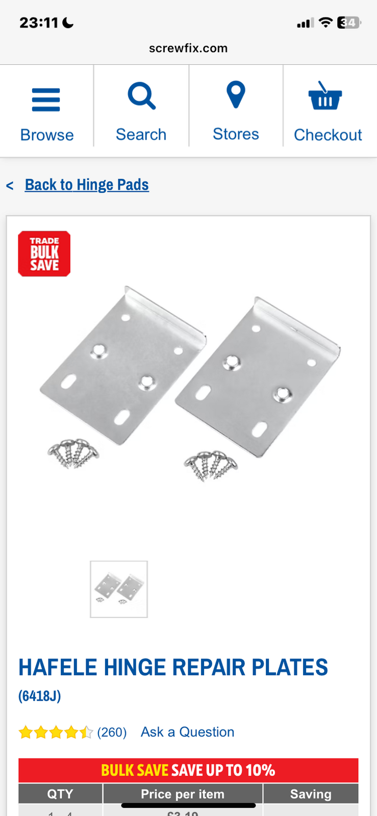

Extra weight of those curved doors has caused hinges to fail , replace both , you may need hinge repair plates to strengthen the new hinges.
