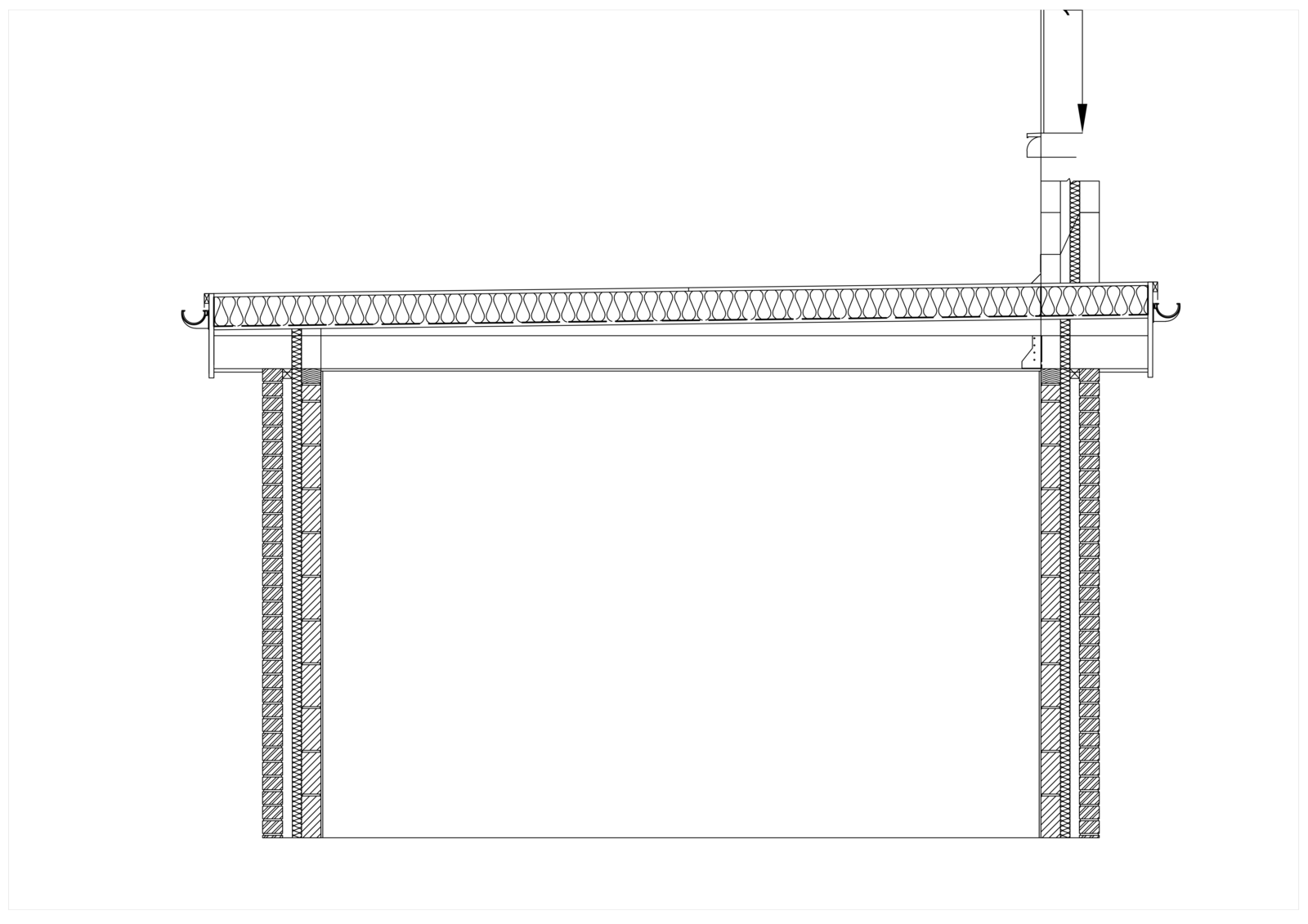

From this drawing, what are the correct joist sizes for my flat roof.
Some facts;
Joist Span 4.8m
Gradient 1 in 80
Joist size 170 x 45 [Regularised Size / Finished Size]
Spacing @ 450 c.c

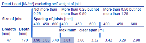

C24 SPAN TABLE
According to this span table
A Dead Load [kN/m2] below 0.25 can allow a span of 3.83m ,
So would this mean my joist sizes are under the specified standard?
What would be the Imposed Dead Load for a Flat roof?

What's going on with those pointless insulated soffits? o_O
It's a continuation of the thermal break from the top of the masonry to the underside of the warm deck. What would you suggest they use - hope?
As @noseall said, I wish to insulate the back of the fascia board and soffit to prevent cold spots and condensation.
Your span looks like 3700mm.
Ah, I see, I was clearly measuring it wrong. Thank you for the correction.
So this means that these 170x45 joist are fine to use?
Is 0.25 kN/m2 the Imposed Dead Load for a Flat roof? Do I have to factor in snow load?
Yes they could do.
Or more traditionally, just take the wall insulation up to meet the roof insulation.
@GateBeam; Your dead load will be higher than 0.25kN/sq m - you would probably be in the 0.25-0.5 column, which is the one most used for flat roofs.
That figure refers to dead load only (ie the weight of the structure). The live load is normally taken as 0.75kN/sq m, (unless you are in an area of higher than average snowfall) but the load/span tables usually allow for that in their figures.

But using your info, I will be using;
C24 170x45 joists at 400mm spacing which allows for 3.81m span. With my span being 3.7m
