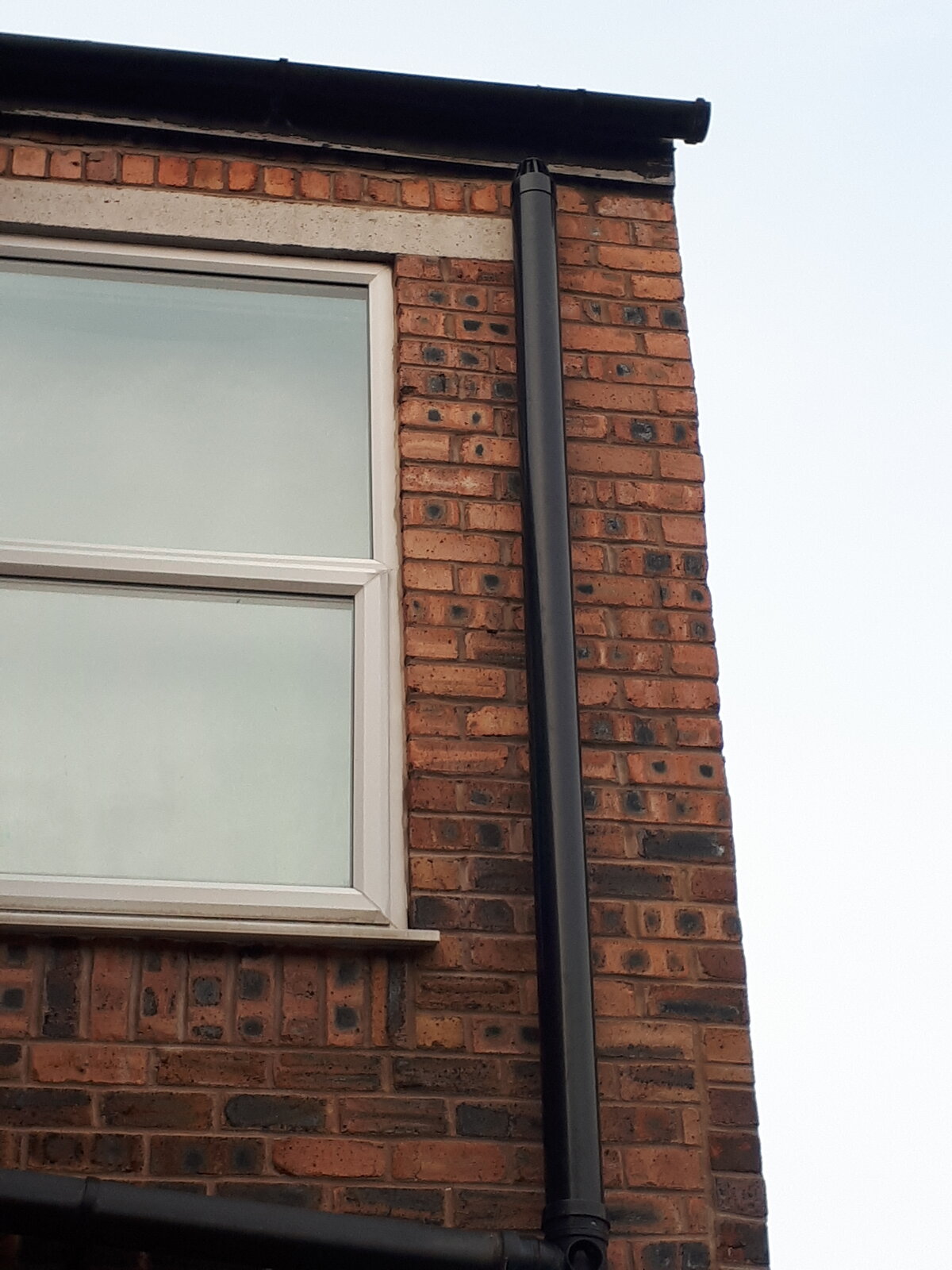

Hello everyone need advice as its stressing me out worrying about gasses
Ok so plumber came out and fitted an extension soil pipe and put vent on the end but only fitted it up just under where the gutter is but everyone elses pipes have went above the roofline and over the eaves no matter what
It even says it must always go above the roofline and any window within 3m it needs to always go 900m above the eaves or above the window
i said this to the plumber and he wasnt happy and told me he has 20 years exsperiance he knowse what hes doing
I never said he didnt but wouldnt the gasses just go into the opening of the building while its sitting right there by the loft ? I just want it above the roofline like everyone else, but hes saying because my bottom window opens from the bottom not the top it doesnt need to be above the roofline as its 900m from my bottom window so its ok
But i just want it above the roofline like everyone else to save the gasses going into the loft and the steam that comes out from the bath and shower 2 that can cause mould and moisture issues
What can i say to the plumber please
Is he right ?

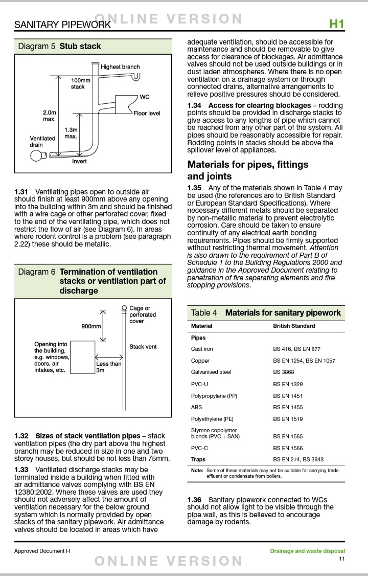

Only speaking as a DIY'er, but 'technically" he is probably within regs - they state that the terminal should finish 900mm above any opening into the building.
Judging by the brick courses, that is about 1m higher than the top of the opening window and there are no soffit vents.
There is no regulation stating that the terminal must be above the roofline.
However, this takes no account of any future changes to your house - if anyone replaces those windows to top openers, then the vent will need to be changed.

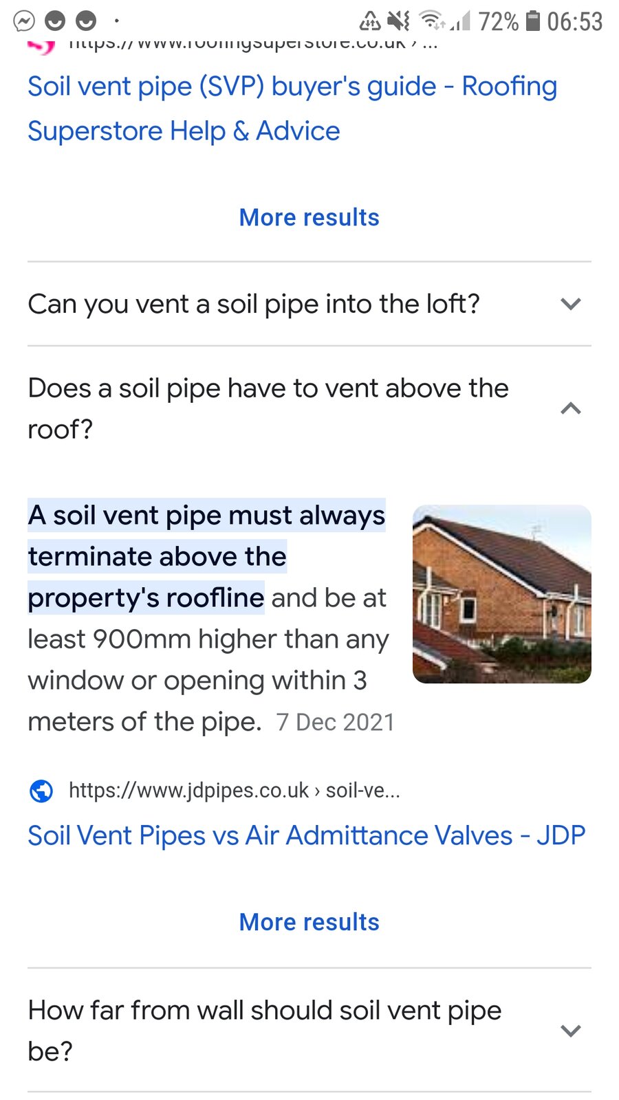

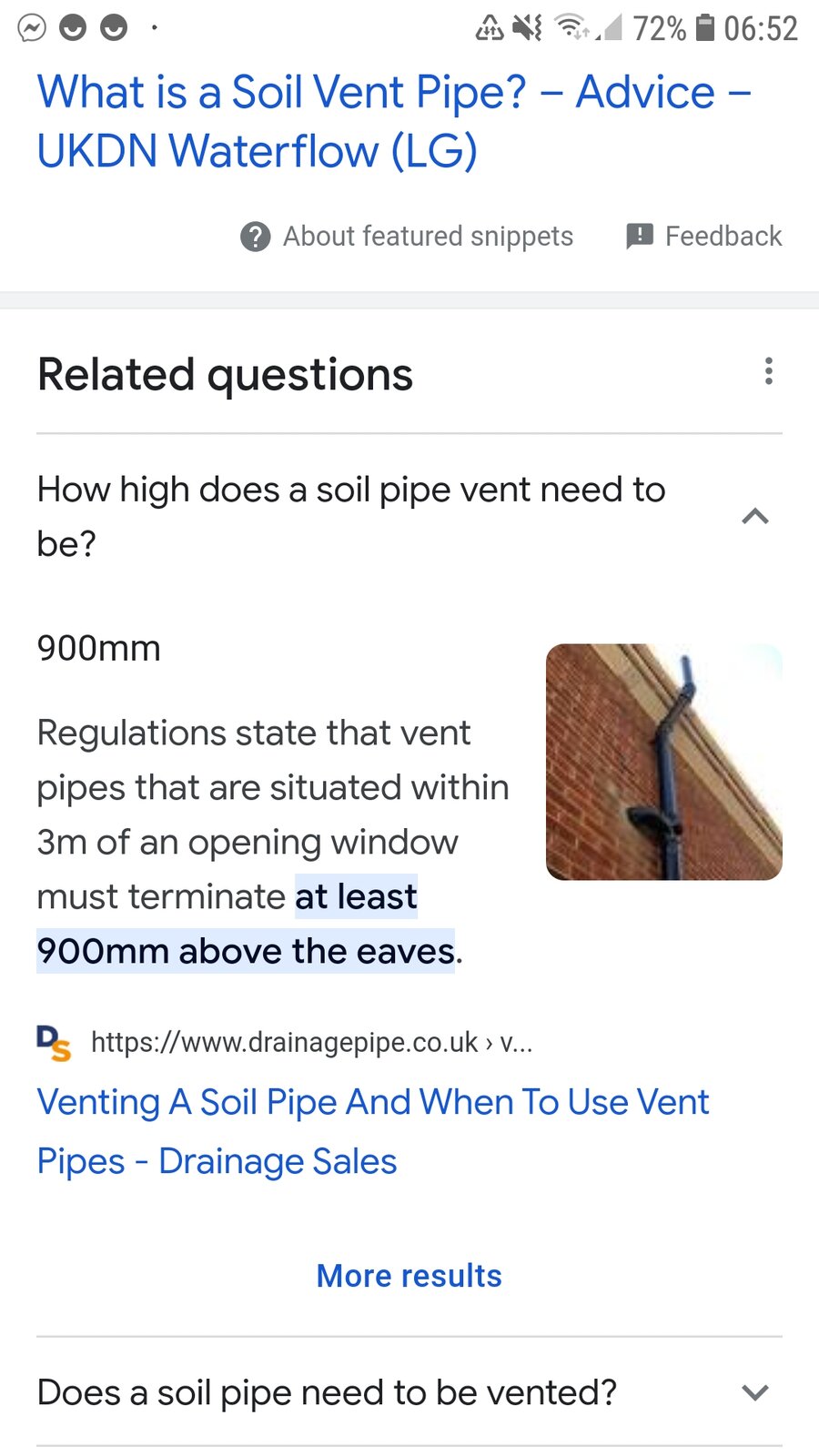

I told lanlord that the plumber wasnt happy with me, saying i was questioning his 20 years of experience and told me to google it and it will say hes right,
but i did google it and it always just come up saying it needs to be above the roofline and everyone elses house it goes past that 2 so dont know why hes unhappy with me
