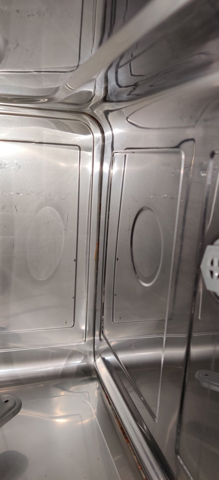

Please see the rusty edges within my dishwasher. Any suggestions as to how to fix, if there is one?
What make is it?
It appears to have a typical stainless steel inner cabinet. It is difficult to make these rust, though the use of certain chemicals, such as descalers or excessive salt, can do it.
Rub off the rust with a green nylon pan scourer.
