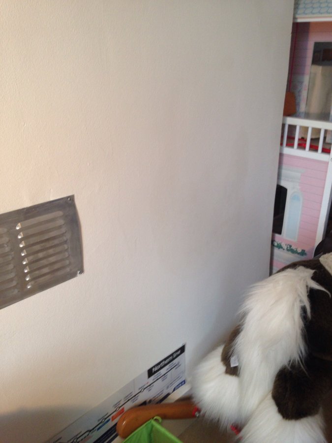

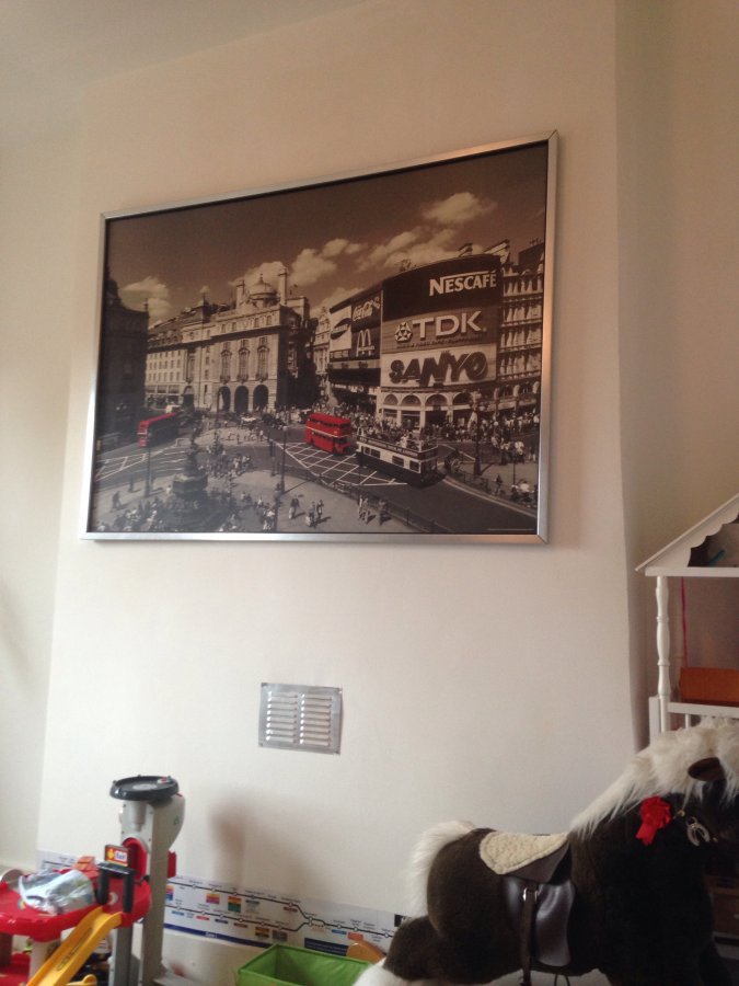

This is the interior - damp occurring at bottom ( near rocking horse!) and top

Also - since everyone is so kind on here - would it be better to use my dehumidifier in this room or not? Don't want to make the problem worse
I can't see the damp patches. Can you move the horse and picture?
Is it emulsion paint on plaster?
does it show on the sides?
What is above and below this room?

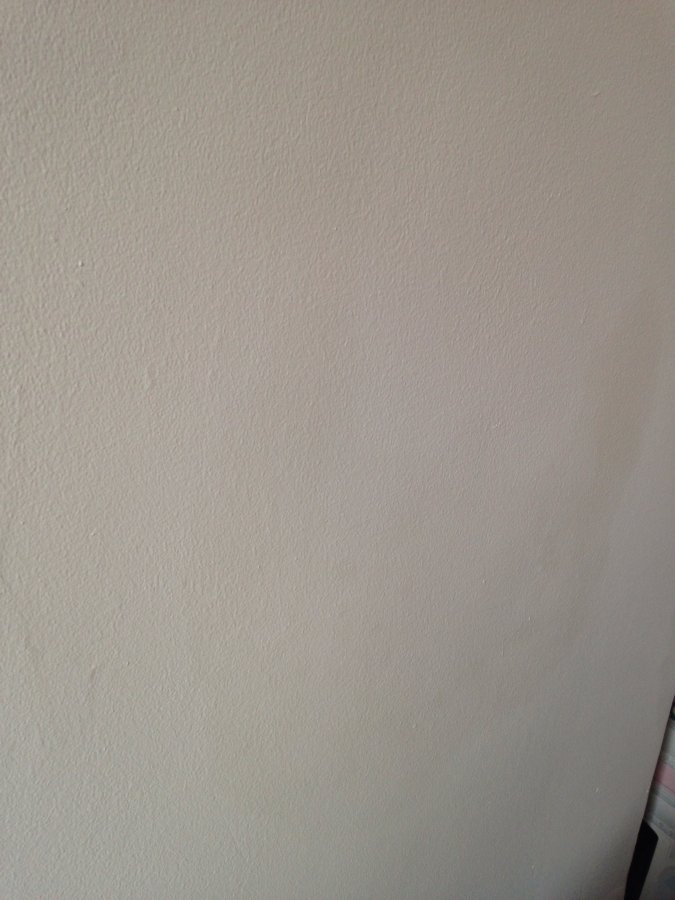

The problem is they are barely visible - yellow rather than white
Better with spotlight maybe ?

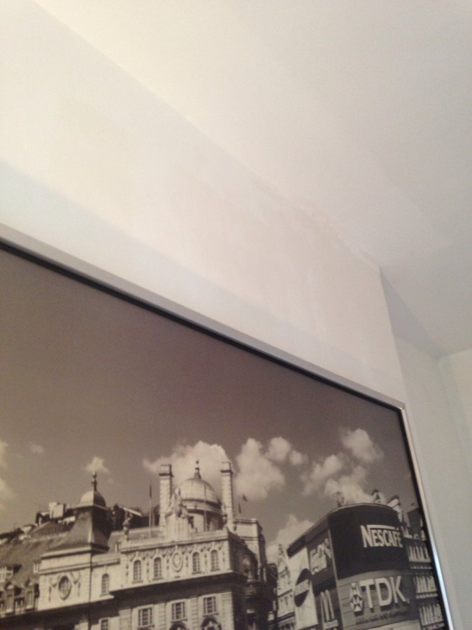

And at the top
is it at the right-hand side?

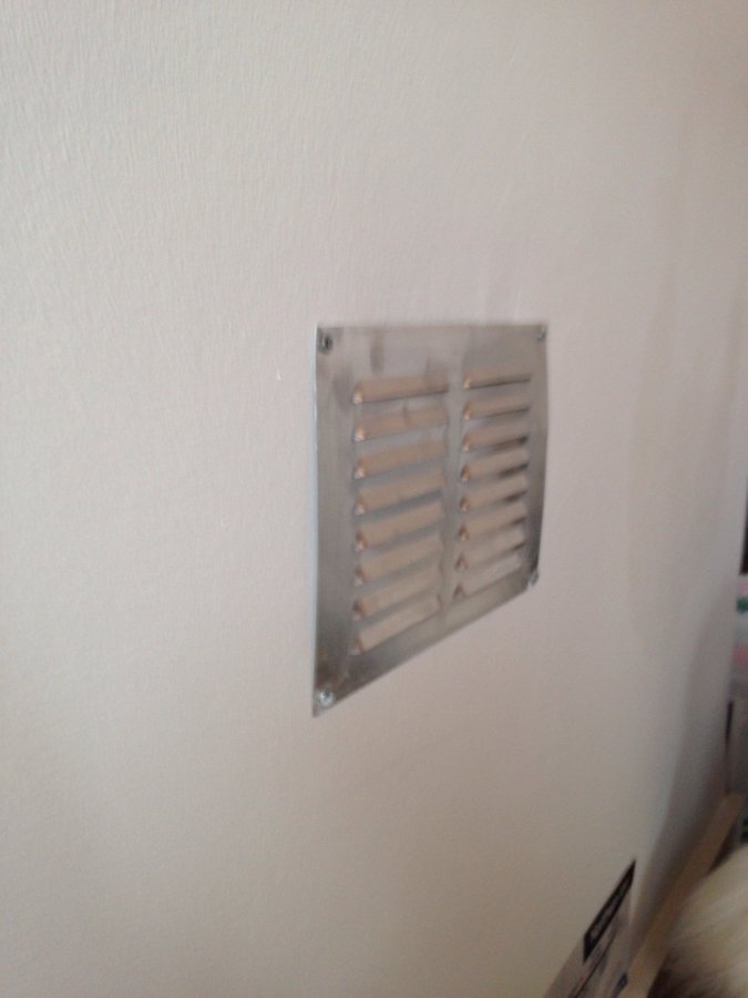

Am assuming this counts as ventilation - we have two on each floor

is it by the ceiling? You need to look in the loft.
