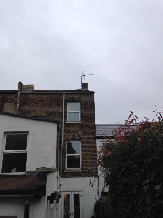

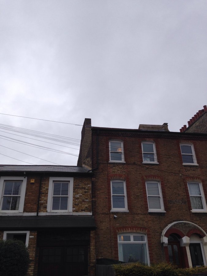

2. Typically damp could still be penetrating thro the brickwork of the exposed gable. Presumably its a solid wall?

7. Why not go outside, and pic the gable from the front of the house and the rear - & post the pics on here?

6. Before answering any more of your Q's with incomplete information could you post the requested pics please?
Ok will do. Apologies - what specifically is the gable?
Rear view

Front view
