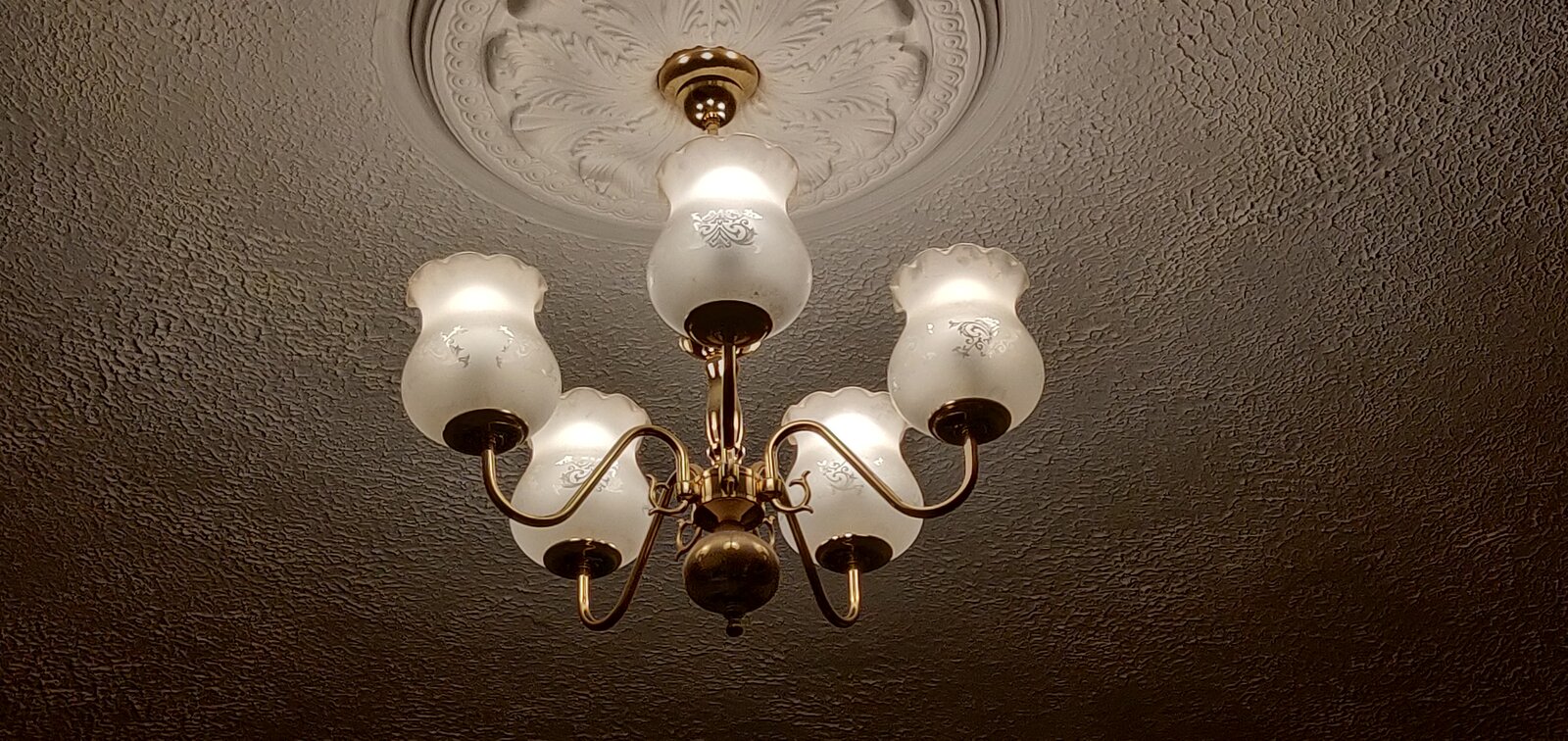

I have this 5-bulb fitting. Recently switched to energiser 6W dimmable bulbs. Soon after some bulbs started flickering. Not constant, like a single brief flicker every 30s. Sometimes one bulb sometimes another, sometimes none. They don't flicker in sync and I already tested the switch.
I was sent some replacements. After just a few minutes one of them started to do the same thing.
I noticed when changing then over after they'd been on, the bases of the bulbs were really hot, like hot enough I couldn't hold it for more than a second.
Is it possible I have overheating issues?
My only other thought is the during has several, separate intermittent shorts. To me that sounds unlikely.
I had issues with LEDs in this room before. Could this style chandelier cause overheating and if so what can I do?
leds can get very very hot but should be designed to have enough heat sink or airflow to remove the heat
It is quite an old fitting. Could there be a fault on each outlet separately? I imagine the wiring is really simple but... Can they get dirty and become bad conductors maybe?
Been playing with this on and off for a while, just can't seem to make headway diagnosing the fault. Not had anything like as many issues in other rooms which is making be wonder if it could be the fitting, but not sure how to test this.
Are they connected to a Dimmer, with Upwards lamps, bases should not get excessively hot in an open topped fitting

how do they work in normal light fittings both dimmed and not and undimmable [normal off on switch]??
you need to isolate into set up fault [including specific combination ]bulb fault or batch fault

I have an 8 bulb chandelier with Energiser 6W dimmable candle bulbs, and also a 5 bulb chandelier with same bulbs, not noted any problems either with heat or flicker, I have had problems with same switches in other rooms with G9 bulbs with flicker, and slight with GU10, and the flicker is same with every bulb in the fitting, but no with E14 Energiser 6W dimmable bulb and non dimmable bulbs.
I can see the problem, had same problem with G9 bulbs are not cheap, and they last a long time so getting spares to test becomes expensive and you then have to store bulbs, but E14 is common don't know what yours are, but can you test bulbs in friend, mother, sons or other persons house? That would seem cheap method to test if bulb or installation.
I guess I might need to set aside some time swapping things around then. We have similar fittings in at least 2 other rooms and some 3-bulb ones also. None of those have this issue.
I also started marking bulbs with a sharpie to know which ones were flickering.
I have already changed the switch and it made no difference.
I might start swapping bulbs in the same fitting. I noticed that the new one that started flickering was in exactly the same socket as the one that was doing it worst in the original batch.
Are there are any really easy things I can rule out on the fitting to make sure it's clean... compressed air, something to clean the conductors, etc? I'd kick myself if it was something that simple!

But note one light that is flickering. Remove one shade and refit light. run for a few days and see if it improves.
