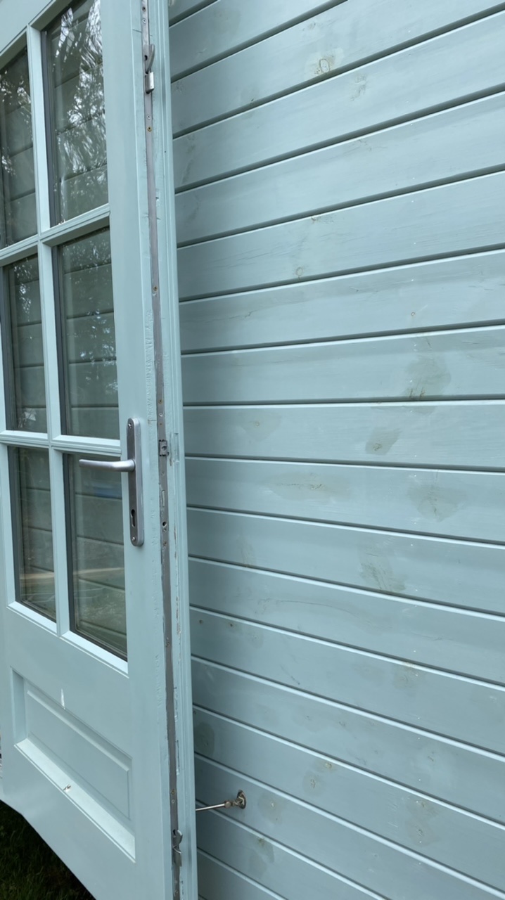

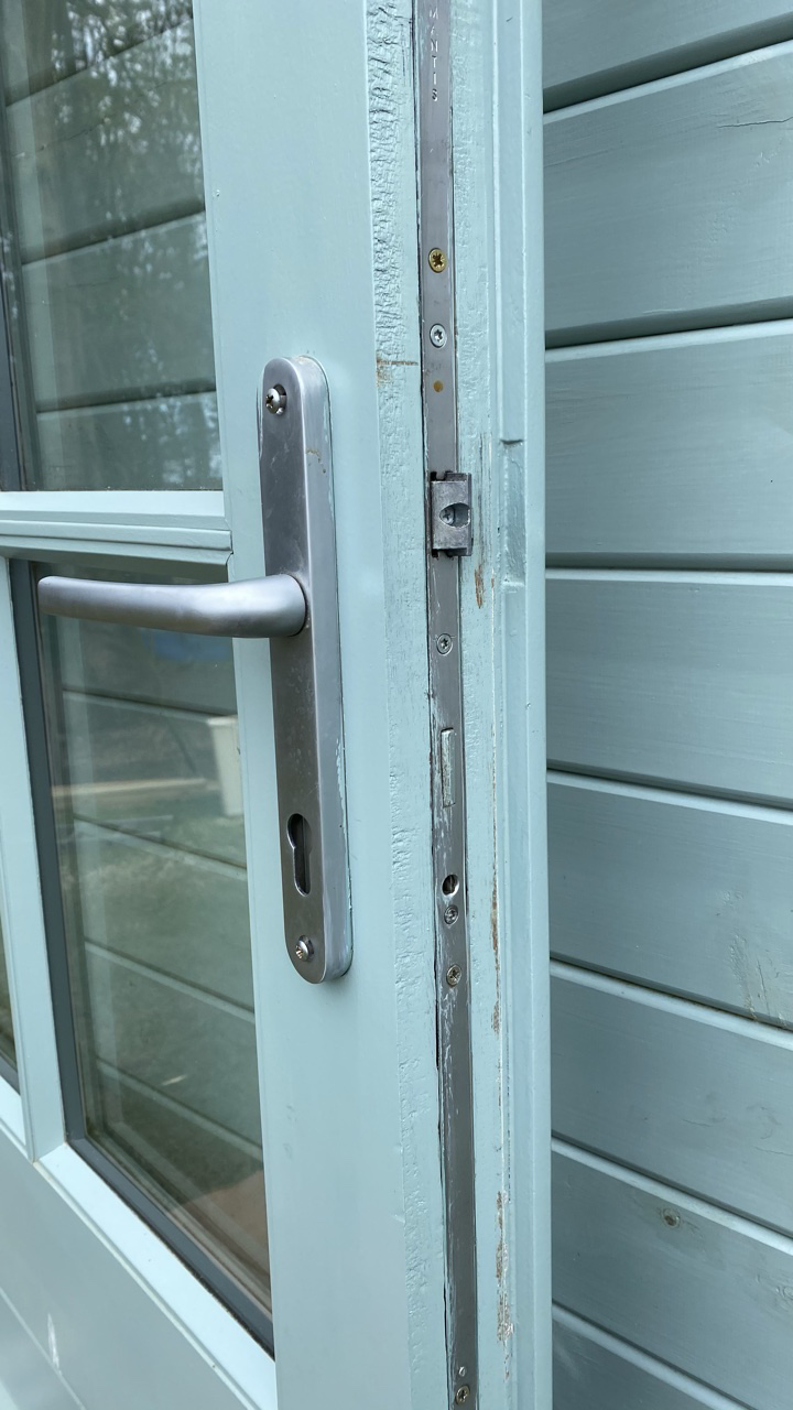

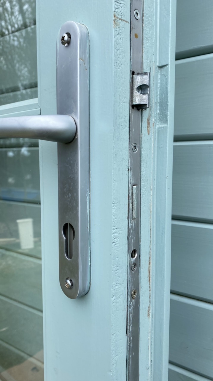

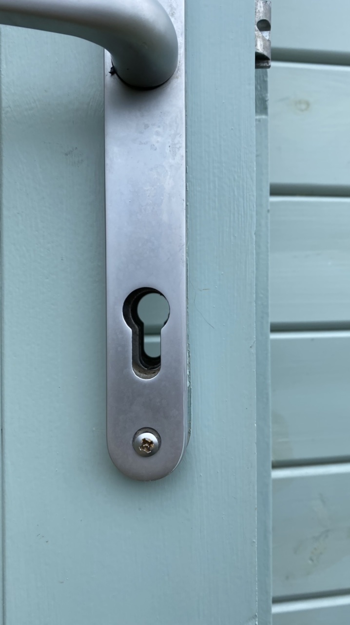

Hi chaps could someone tell me what type of lock I need for this please? Just looking on Screwfix and not 100% sure?
many thanks
Thanks guys how do I determine the correct size please? Thanks
Measure from the edge of the door to the middle of the lock and + on thickness of handle backplate....then order a Euro cylinder that is slightly longer so the lock is either flush or a little proud of the handle backplate.
If door lock position is offset you need to order and offset one.
I would take a guess at 40-40 euro cylinder.
Thanks very much, you got it 40/40
