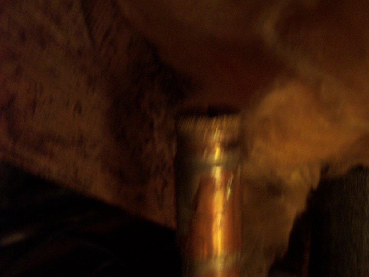

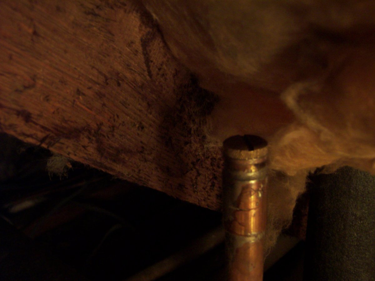

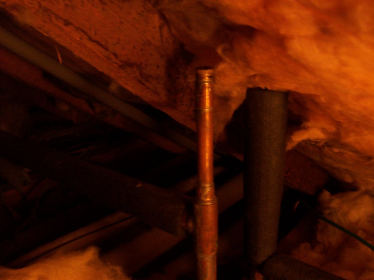

Hi Folks
I recently employed the services of a local RGI to fit a bathroom rad. He did a fine, tidy job, but when he refilled the system and fired up the boiler it transpired that there was no auto air vent on the system. The boiler was constantly heating up rapidly and then cutting out, and there was a Niagara-like rushing sound through the pipework. By draining and bleeding each rad in turn he managed to remove enough of the trapped air for the system to work, but there is still significant "gurgling" when the boiler fires up, both for heating or hot water.
Out of curiosity I went up into the loft today to have a look at the pipework. On top of the two 22mm pipes (flow and return?) which lead from the boiler into the cylinder cupboard and thence to the pump, etc, are two lengths of reduced pipework, about eight inches long, and these are terminated by a screw with a knurled edge. Is it likely that these are manual air vents? I can't post a photo right now but if needs be, in the morning I'll set up an inspection lamp and try to get a clear picture to go with this post.
Thanks in advance.
Yes, description is exactly that of an air vent. Loosen the knurled bit to let air out.
Somewhat poor that the installer did not look there for vents - it's exactly where you would expect them to be fitted.
Thanks for that. Must admit, given how easily I located these things it surprises me too.
Just to make absolutely sure, I've attached images to this post...hopefully.
Edit: if these are indeed air vents, should I bleed them when the system is running or when its off? Its a conventional open/ vented CH/ hot water set up with expansion tanks and a hot water cylinder, and not a combi.

Well I cracked 'em--clearly the first person ever to do so, given the amount of effort involved--and a smidge of air wheezed out, but the pipework carries on gurgling.
I've recontacted the RGI, and he's going to fit an AAV to remove any air in the future.
In your engineers defense, he maybe didn't realise that the pipework rose into the attic. Not necessarily the place to be looking for CH/HW primaries unless your hot water cylinder is in the attic though he should have traced the pipework to find its high point.
I'm in a bungalow; maybe I should have mentioned that earlier on. The HW cylinder is in a cupboard in the bathroom with the boiler controls, the boiler is in the kitchen along with the programmer and there's a wireless roomstat in the lounge which communicates with a control unit in the cylinder cupboard. The existing manual air vents are on the highest point of the system.
If the RGI is unable to do the job in the near future I'll probably have a go at fitting the AAV myself, because I want to get rid of the air in the system sooner rather than later. I'm guessing that the solution would be to drain down, cut one of the manual valves out and replace it with an AAV?
