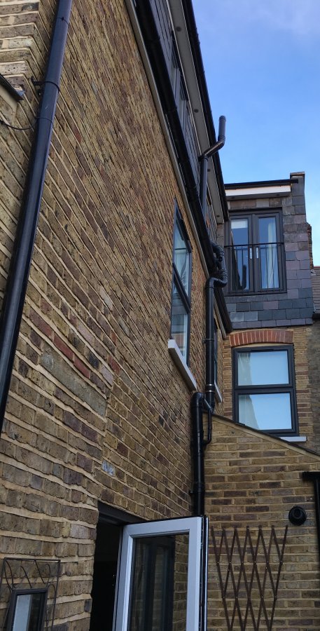

Ps one other odd thing is that it's only the small part of the L shape (main bedroom Juliette balcony/window) that isn't set back. He's set back the main part of the L (bathroom and small bedroom).
Here's an image, the bit the council are not happy with is the big door window whereas the rest on the left (with drainpipe coming down) is setback

If it's just the lack of a set-back on the outrigger-part of the dormer that the council is complaining about, then it is probably not a problem and the council is mis-interpreting the legislation.
The 20cm set back appears not to apply when the roof enlargement joins an original roof to the roof of a side or rear extension.
This exclusion is clearly stated in the GPDO.
You need to look up Town and Country Planning Act (General Permitted Development Order) 2015
Schedule 2, Part 1.
Then look for part B (roof enlargements).
The bit you need is in the conditions section - B 2 (b); the exception from the 20cm rule for enlargements over an outrigger is clearly implied - your council has got it wrong.
You need to get a local planning consultant to deal with the council on this.
Thanks tony1851, that's a very useful tip. I think it might be well worth our while getting a local planning consultant to come and have a look. Yes it seems to be only the outrigger part they are complaining about.
