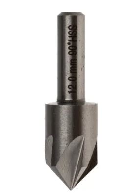

Hi,
I would describe myself as a reasonably accomplished DIYer - not professional. I have a C/S drill bit - can't see how to insert a picture but it's 5 fluted and with a 'barrel body' - so behind the fluted part it widens to a smooth 12mm diameter body. [Edit - managed to attach an example picture].
I often use this to both countersink and counterbore. I keep countersinking until the hole widens to 12mm and the body then continues sinking. This gives me a conical countersink that is depressed about 5mm below the surface of the piece and is an ideal to fit for a wood plug.
I have three questions.
  1. Not that it really matters (the above system works for me just fine), but is this how these bits are supposed to be used? The alternative method I've found is not to use the C/S bit at all, just a standard 12mm drill bit. That also gives a deep hole with a conical profile at the bottom, pretty much the same result. I just have to be very careful with depth because a drill bit will tend to 'pull' into the pilot hole and run away too fast. I don't have a pillar drill so am hand-holding.
  2. When I am not counterboring (just countersinking flush to surface) I sometimes get the usual problem with chatter. I am thinking of getting some unfluted C/S bits but never used one before. Could these also be used for counterboring, or am I better off keeping my fluted one/drill bit method for that?
  3. Do I need to worry about getting different bits for different angles of screw head? It's not something I've ever considered before. Are screws mostly standard these days?
Many thanks!

These bits aren't really ideal for counterboring - but they will do just that if you let the wood chippings clear from the flutes. Possibly forster bits are better for that.
The bit you have in your pic is also good for metal - which is probably its original intended use!
At least, the genuine CSK bits don't pull into the timber so much as a twist drill might, so you get better control of the depth.
As for the chattering you may well expect that with wide grain timber that we get so much of these days - you'd probably find that there would be little or no chatter if you were countersinking oak for example. Failing that, try the csk's with only two flutes and / or vary the drill speed.
Screw head angles do vary - usually in the range from 80 deg to 100 deg - and a 90 deg csk bit suits them all well enough.
John :)

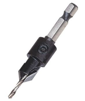

Unfortunately, these are no longer on the market, having disappeared some time in the 1970s or 80s, and in any case, they weren't suitable for high speed drilling in an electric drill, for which the modern 2-flute combined pilot drill/countersink is a far better tool:
These drill the pilot hole together with the countersink in one action and have the advantage that matching tube plug cutters are available to produce exactly matching pellets:

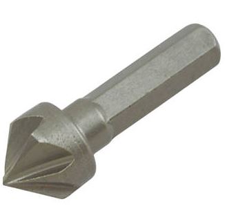

One further question: If the countersink I am using is actually designed for metal, why does it have such a long 'barrel' (12mm dia cylindrical section) which lends itself to deep countersinking in wood, as opposed to *this* which does not?
