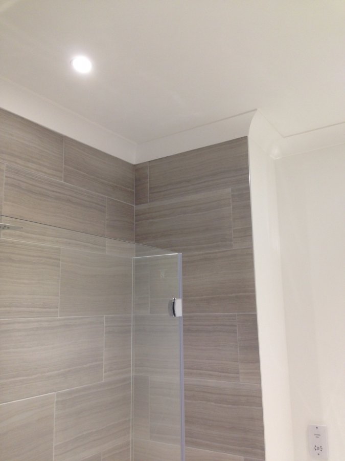

    Hi all,
    Looking for some advice from you can spare it.
    I have just gone and bought some 127mm supercove to do my bathroom and found the ceiling is slanted ..a lot.
    I marked up the walls again from the lowest mark using a level and the ceiling is off by 2.5inch at one side of the room
    As this is far too big to fill can anyone offer some advice how o go about getting a good finish?
    ..or should I just follow the ceiling?
    Cheers

    Only advice I can give if there are any deviations or bumps throwing the ceiling out you can scribe the top of the coving to fit the ceiling "to a limit"and still keep a straight line along the bottom of the coving which is where it counts, if there are no bumps or deviations and it's a continuous slope the ceiling should be straightened out if you follow your ceiling along a slope it will look stupid

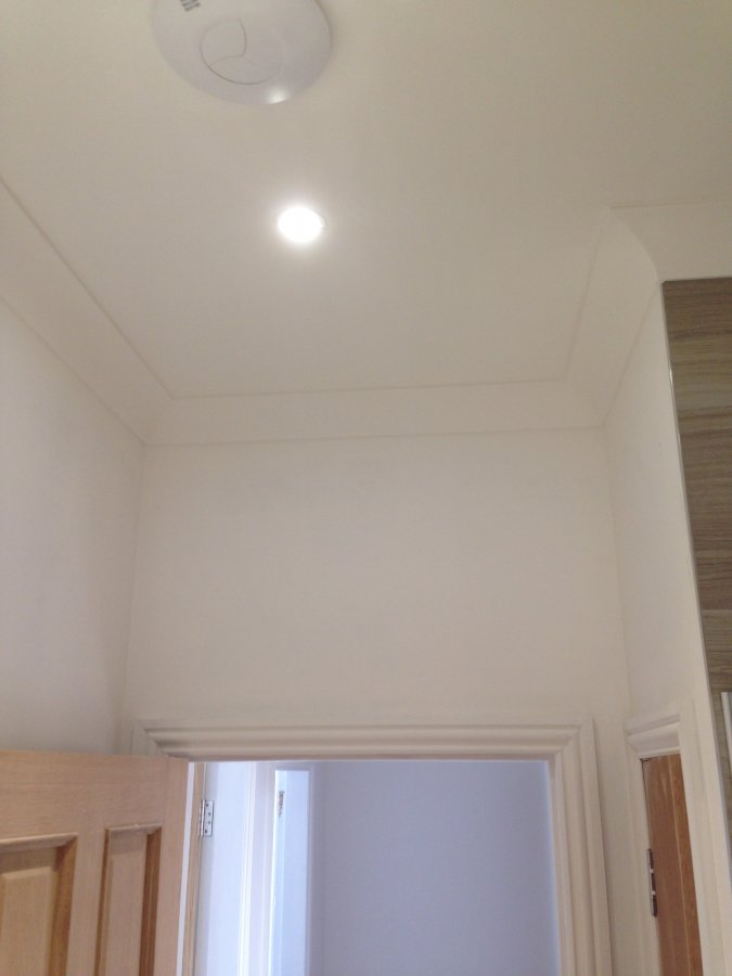

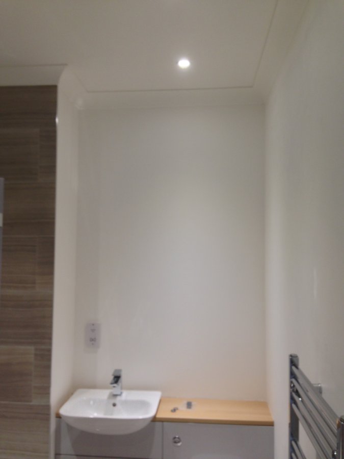

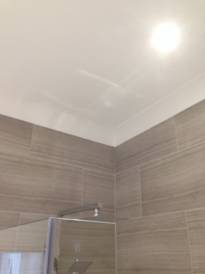

    Cheers for your reply. The job is completed now. Reason for the coving was that the tiling in the bath/shower area (to ceiling) had left a decent amount of gap at the top to hide due to the slanted and uneven ceiling. Couldn't just cove the area of tiles so did throughout the bathroom. Was just for neatness. It's turned out alright thanks to all the help I've had on here. Will take some pics and post.
