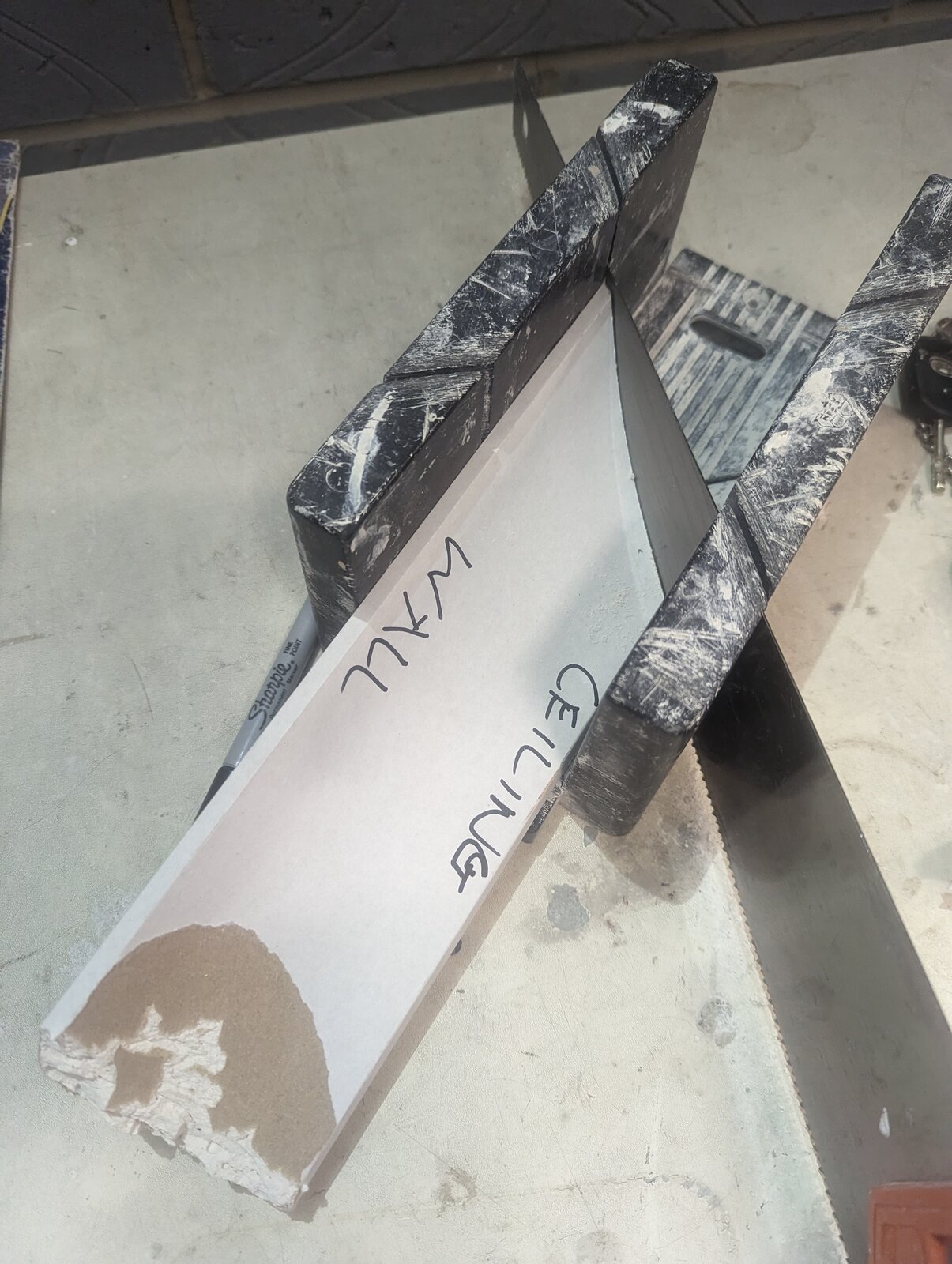

Before you mark and cut write top and bottom on the front of coving. Problem is that you cut coving upside down. By writing on coving when you offer up you will see this. It's strange I know but when penny drops your off and running.
The ceiling needs to be the floor when cutting. This stops people getting it correct. It's not skirting. You can't cut it like skirting.
You need to cut on the floor thinking that the floor is the ceiling. So to do that the coving is upside down when you cut.

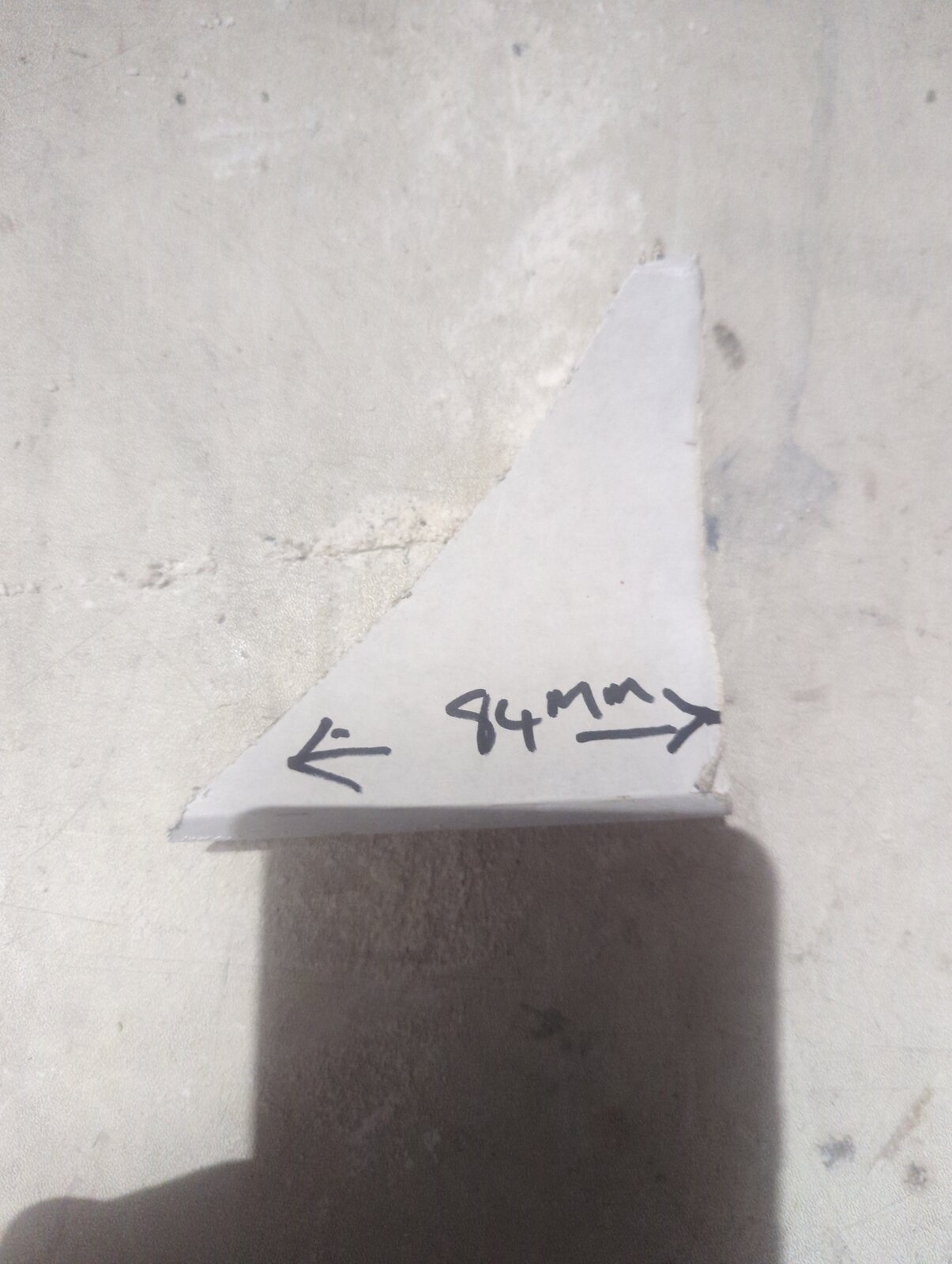

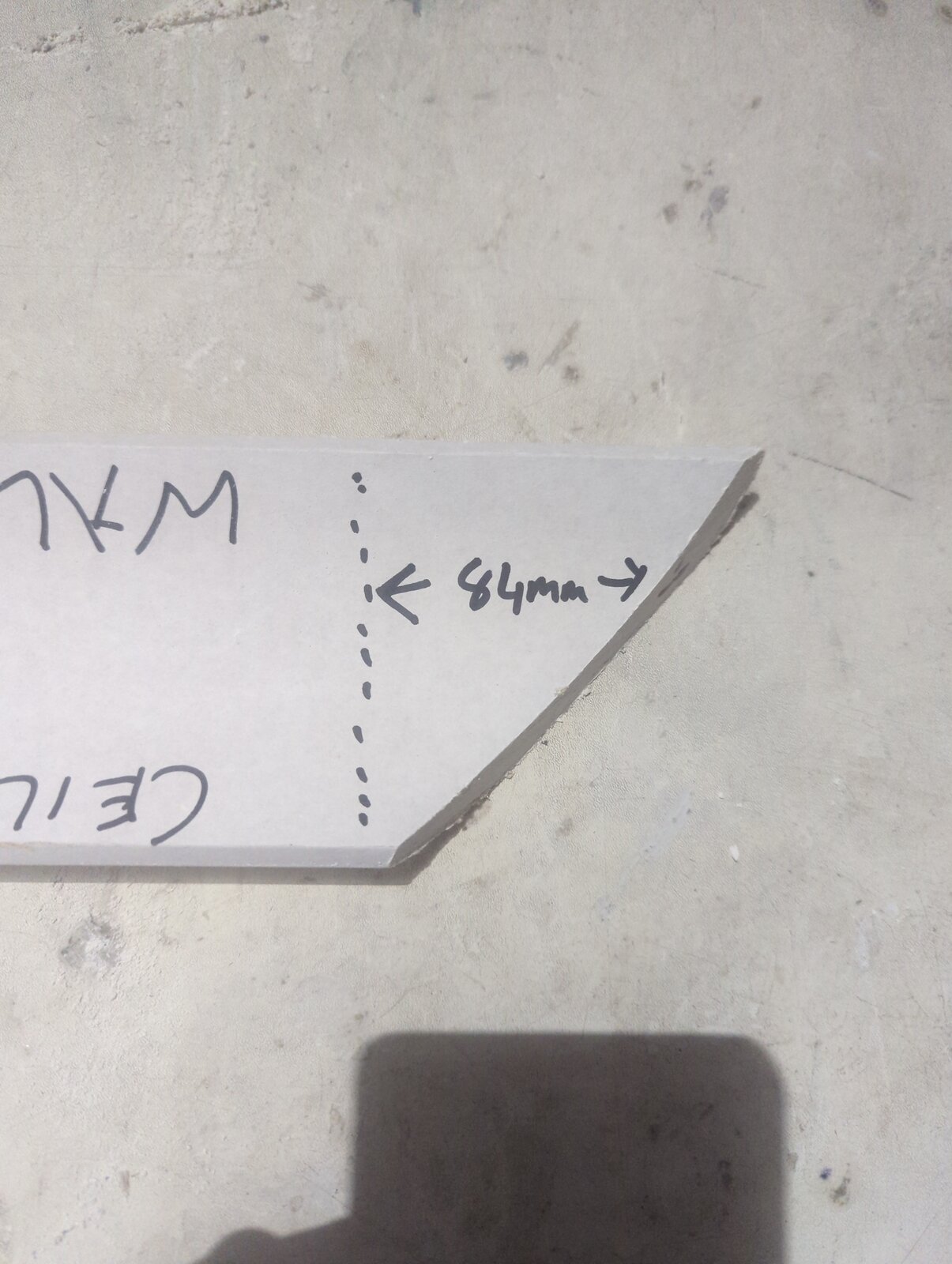

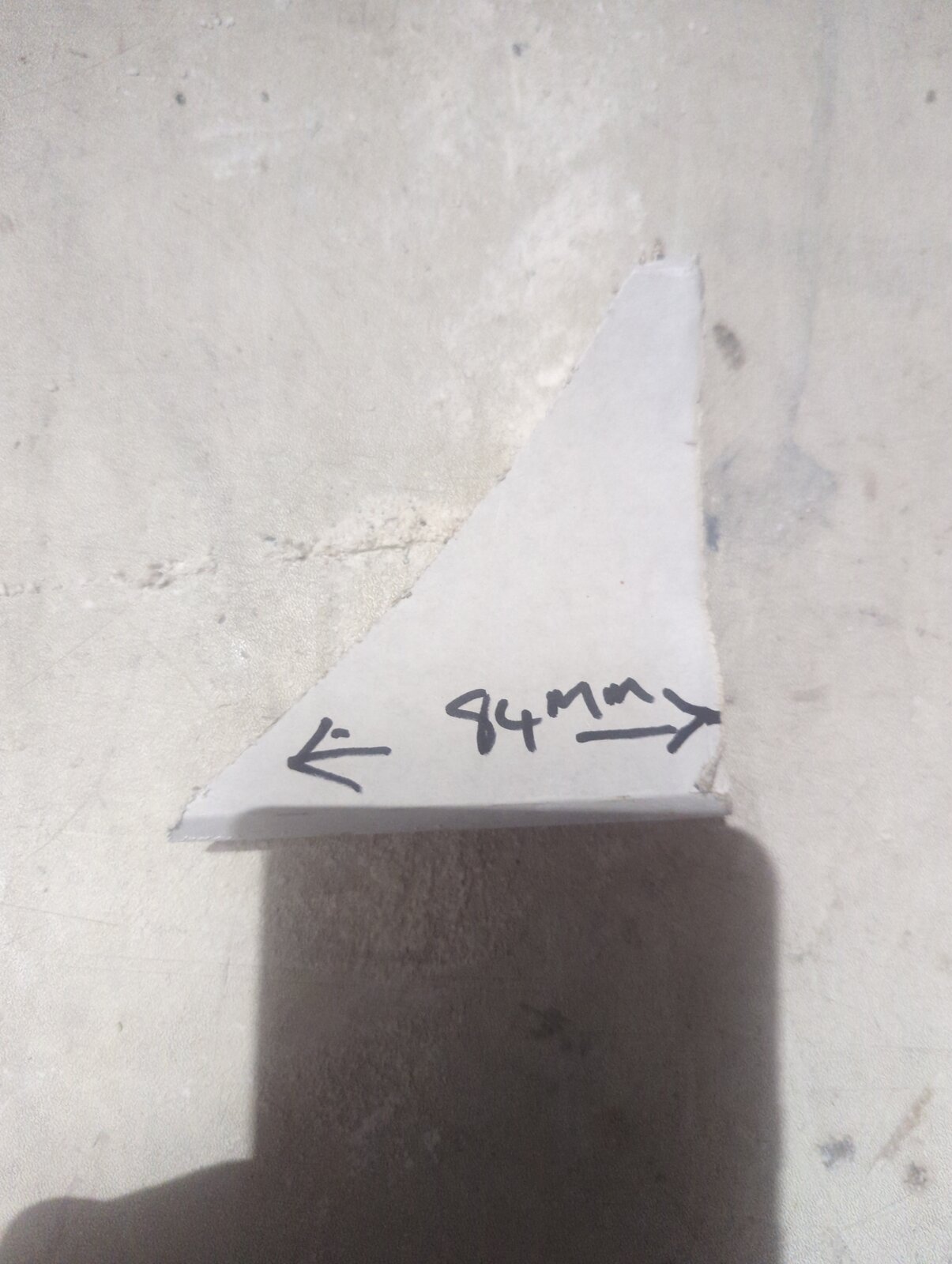

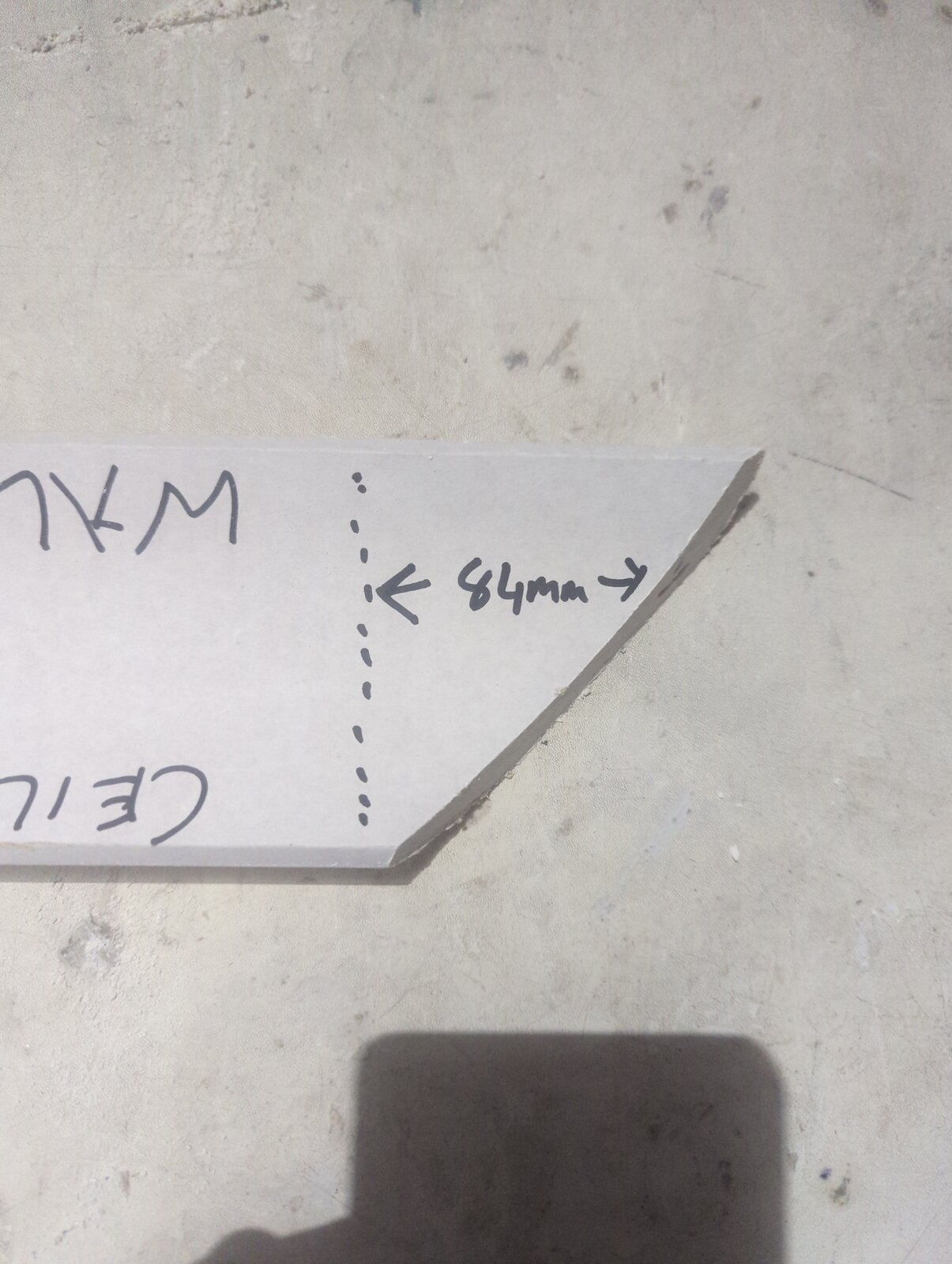

Coving comes down wall 84mm
If mark in on top edge 84mm in then cut through. That will be correct..
I only got 100mm cove here but for demo purpose.

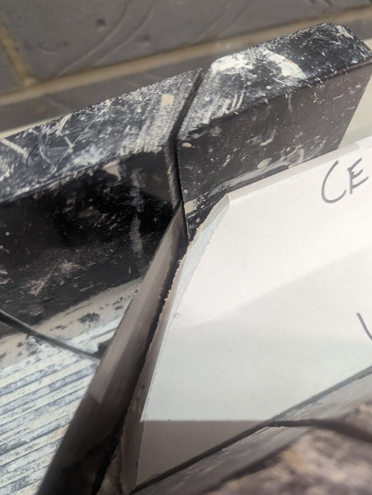

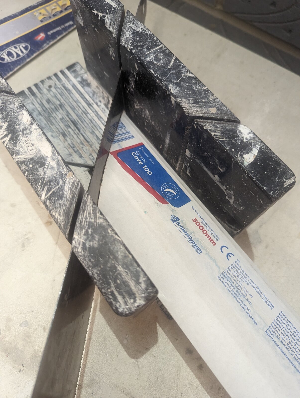

Cut internal correctly
Now if I flip it over the saw don't touch cove. It's wrong. Look
Other way to cut but again it's not practical but will work
As above the coving is correct way up. Top is ceiling, the bottom is the wall but look how it's its positioned to cut. Just not practical
