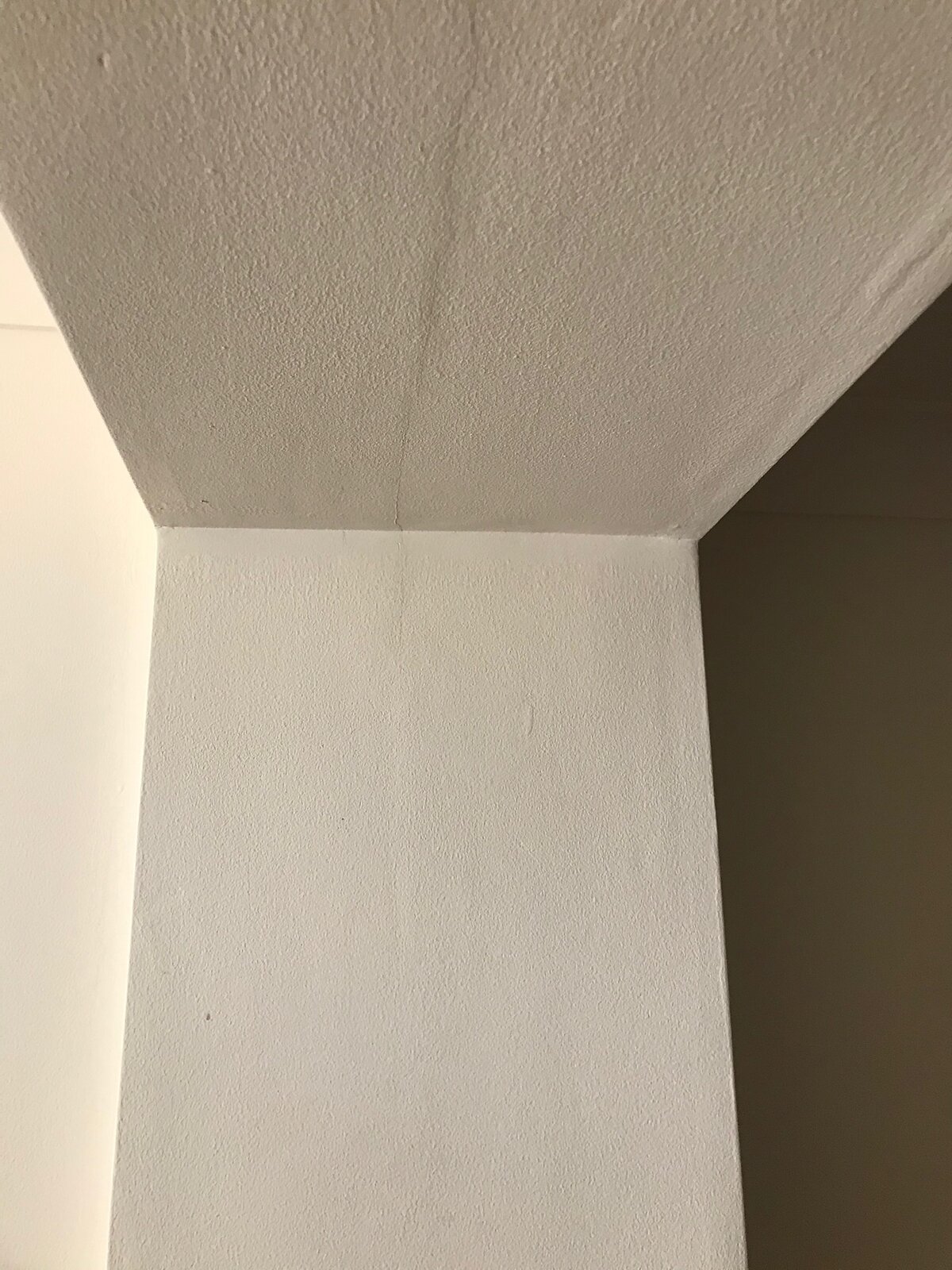

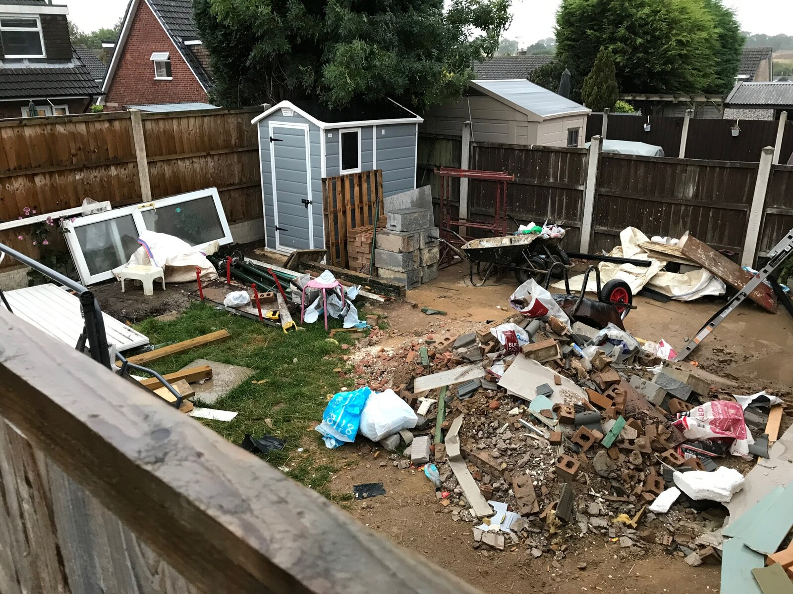

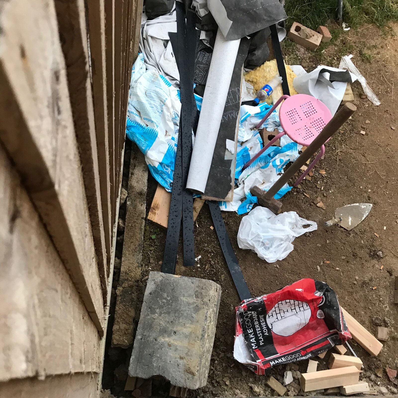

Thank you, we have photos of padstones in their garden and a video of the builder removing loose bricks, he videos our wall and is pushing the beam he has put up to attach the roof beams to. They take this beam off and move it higher. The neighbour denies any structural work and insists the inspector told them to remove bricks, (we have a text saying this and confirmation off inspector stating he had no contact).
The cracks are surface at moment but the adjoining upstairs wall is starting to look likecrazy paving across it.
The photo shows padstones by shed and 1 by fence, also crack in our support column.

Thank you, what would 'trenchblocks' be used for? The house was built in the 70's, they appeared heavy when they were lifting them.
Trench blocks are used below external ground level as an alternative to constructing a cavity wall below ground and having to fill the cavity with lean mix concrete. In any case they look way to big to be used as padstones for most applications you are likely to encounter in a dwelling.
