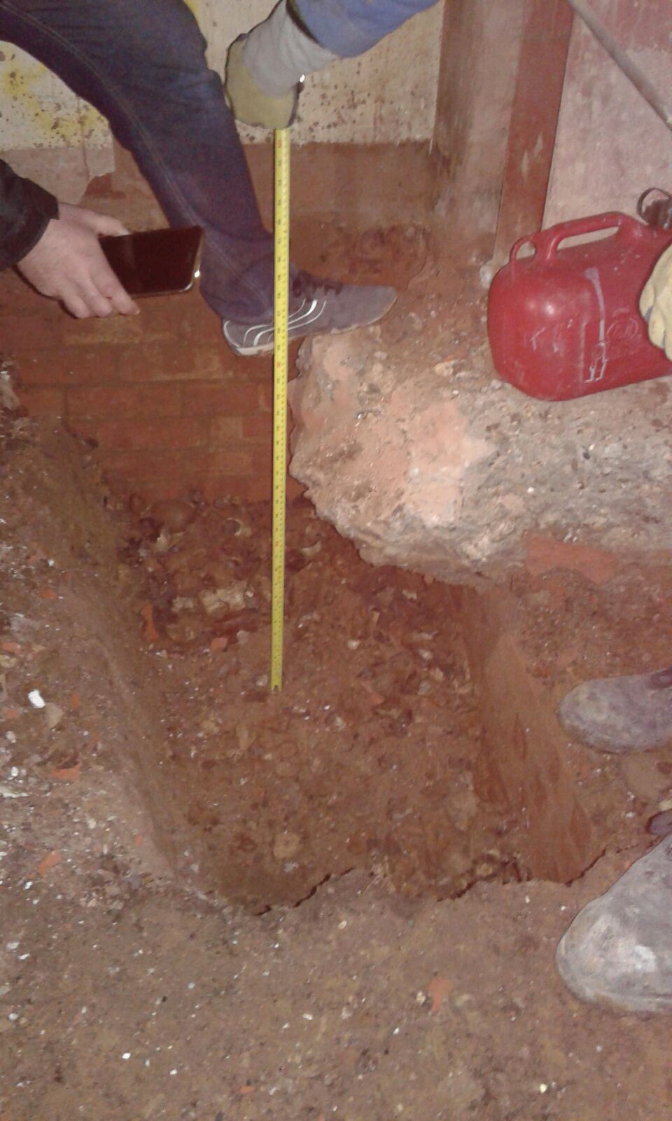

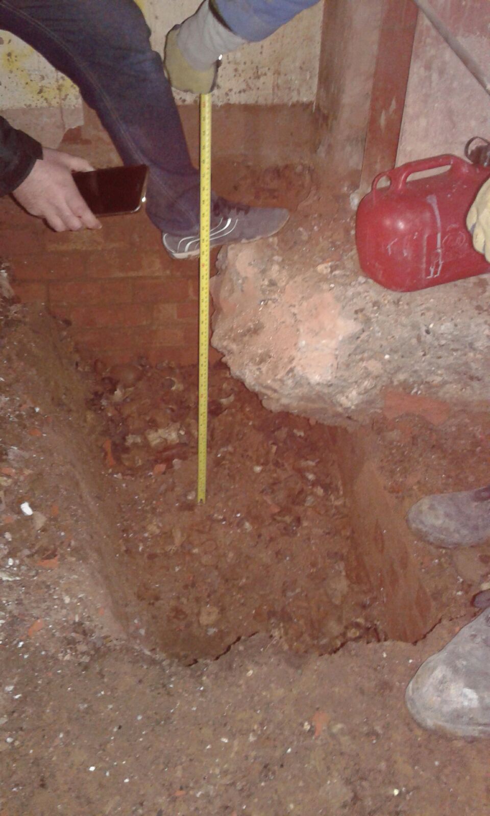

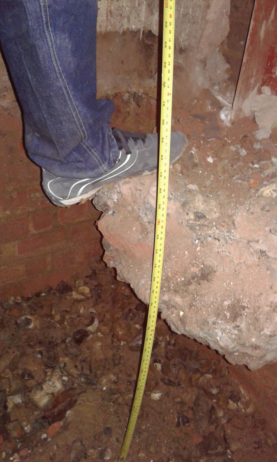

I posted a post last year about issues with the builder i had chosen building a roof with out a wall plate and the problems didn't end there!
The job is virtually finished but he has to get a pad foundation for one of the steel columns signed off by his own structural engineer to get the house signed off by building regs! He is asking for £12000 more as the job didn't make him any money to get the house signed off and give me the gas and electric certificates! The building Regs inspector has suggested I find someone else to say the pad foundation is sufficient to the load of the column as he was only sent pictures by the builder he needs a qualified surveyor to sign it off
Ill enclose the two pictures and have all the calculations and drawings as well, can anyone help because otherwise i'm literally being held to ransom!!!

No i need a surveyour to sign of those pictures with the calculations to say its sufficient, thats what im being held to ransom over, the builder very confidently told me that no other surveyor would want to get involved
Just go to them with the beam and post sizes and pay them to design the found. Say something along the line that your builder says he has told it needs to be twice the size, but BC reckons it only needs to be x by y by z.(insert your measurements here) you could always ask him if you could pay him to check the beams and posts calcs too as you don't have much confidence in what he has said.

Many thanks for your advice, can anyone recommend anyone ?
Ask the BCO if he knows someone independant, otherwise (not even knowing where you are) you'll just need to start ringing round. But they may want you to dig a hole down the side of the pad to make certain - can that be done, as that's why the builder may reckon no one will sign off the pictures.

In my opinion It's not the pictures that need signing off by an se, it's the design that needs to be approved. So agreed with the advice post about getting the design done separately to match. The se will surely want to know the ground conditions though, ours came to inspect the trench and existing foundations before the pour. And redesigned one of the pad foundations as a result. So the trial hole might need to happen, but at less than 12k cost.
