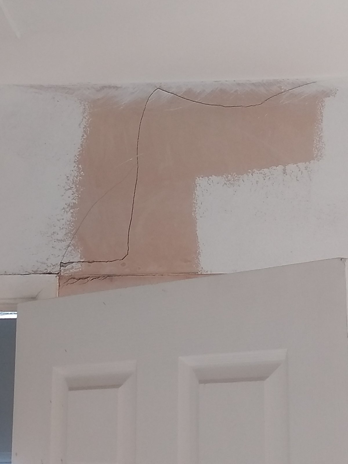

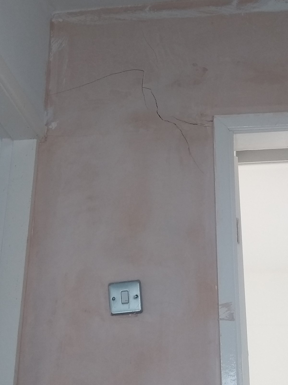

Crack from wall not supported properly

Assumimg settling has finished, gouge out line enough to take filler, and make good.
