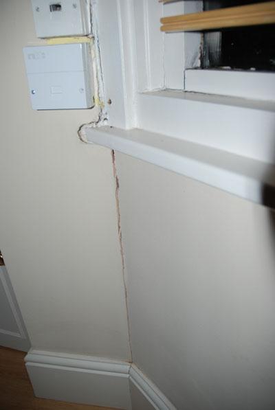

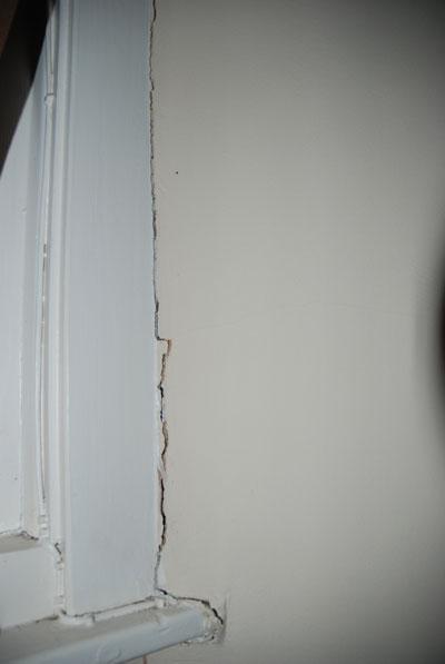

Hi all,
We are looking to sell our house this year, I am going round and looking at work that needs to do, one of things that has worried me is the cracks that sit either side of our Bay Winder in the lounge.
Here are a couple of images:
Can anyone tell me if this is serious, if not can anyone recommend the best approach for filling in.
Lee

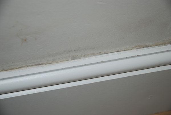

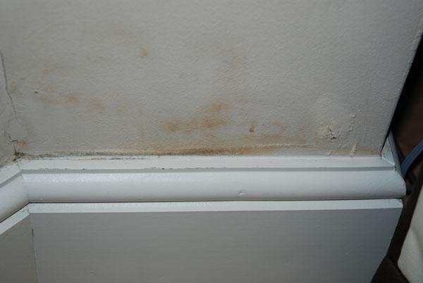

OK! Lee, and can you get a picture of the staining on the skirting board on the right, where it meets the floor, any sign's of damp, past or present.

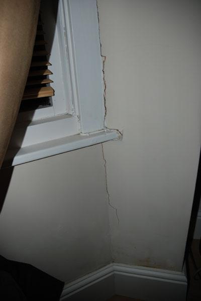

Images of the right side of the bay window:

HI, it look like the bay, may be pulling away from the house, its not unusual, but can be a little expensive to fix. are you insured...?
Otherwise...you just need to look at getting in a decorator whos good with flexible filler...wink.
Like to tell you something nice Lee but that is not a filler job, even the window frame looks dodgy! unless your prepared to do it yourself I'd get someone to sort it for you.
