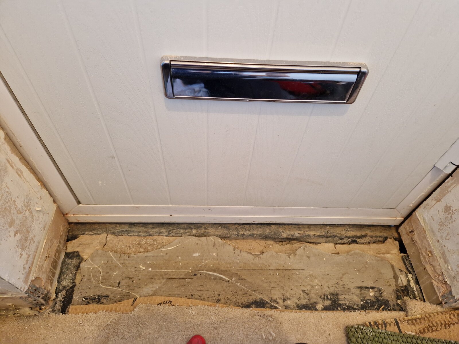

Having removed the carpet by the front door I've found the floor cracked underneath the upvc door. I presume this has occurred when the door has been fitted and the bolts have been screwed down.
I have removed all the broken floor and want to repair this. The floor in the house is concrete with a bitumen top layer/DPM. What I have noticed is that by the front door it seems to just be concrete/sand and cement.
If I'm to replace this area can I just use sand and cement then a liquid DPM? I'm wanting to fit laminate in this room so floor needs to be flat.

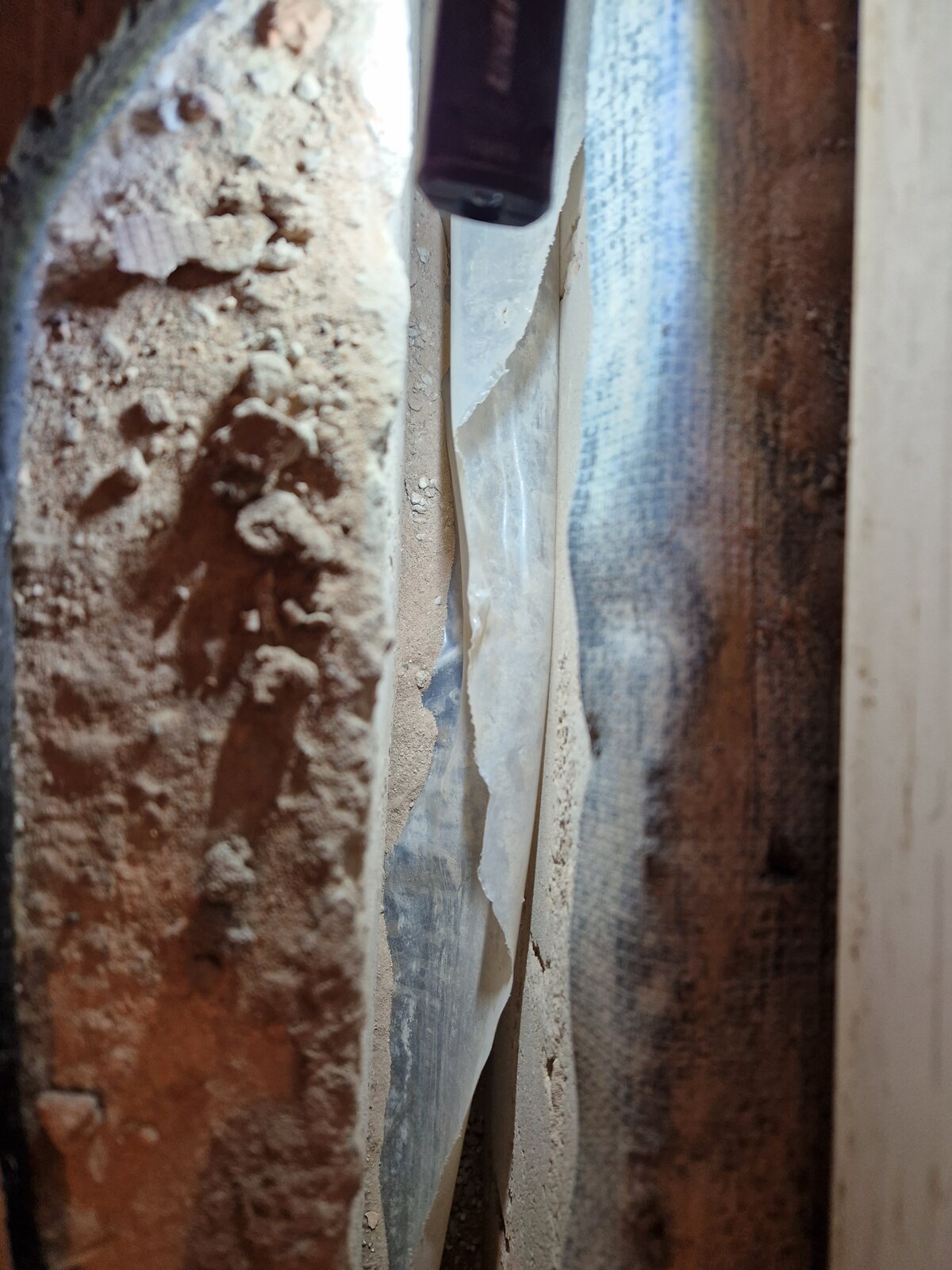

I've highlighted the photo to make it easier to understand.
There's DPC exposed under either wall left and right (highlighted blue). Then a DPC wrapped over the door lintel (also blue).
Where the red line is where the bitumen layer starts and everything between lintel and red line is just concrete. There appears to be a void left and right of the lintel as a screwdriver just disappears into the abyss.
What's the best way to deal with this then? Shall I put another DPC down then lay screed over the top? It's all bone dry which is nice.

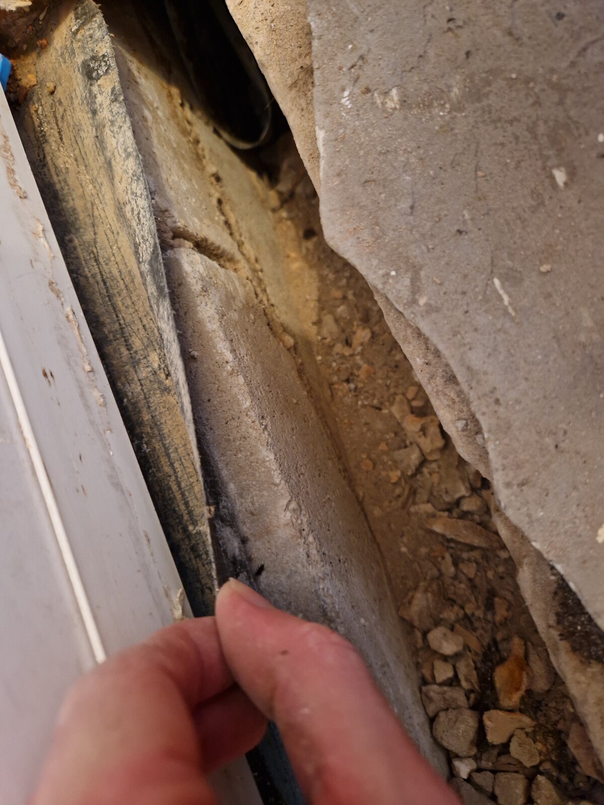

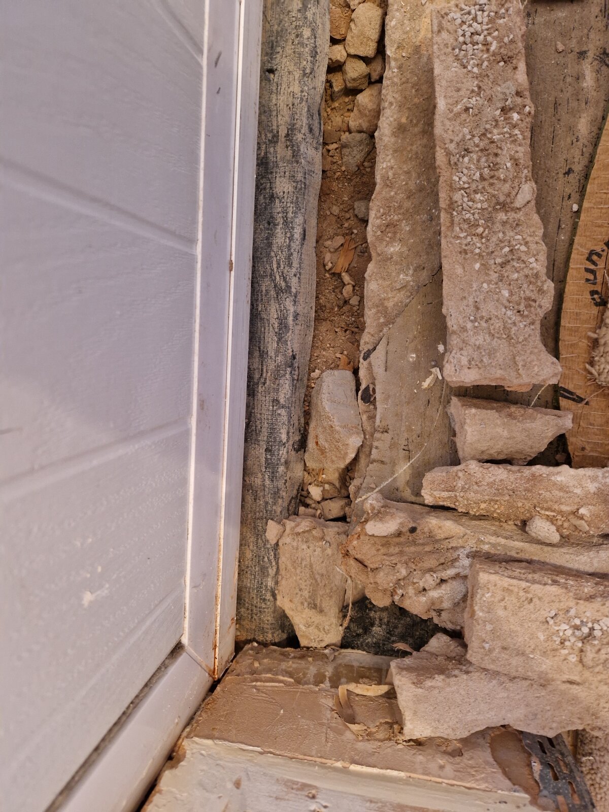

Removed the concrete and it seems this whole cavity has just been filled with rubbish. There's wood and nails in here.
Presume this isn't ideal as it will be bridging the cavity and potentially introducing damp?
Shall I remove all the rubbish from the cavity then do as above?
How much of the cavity do I need to clear?

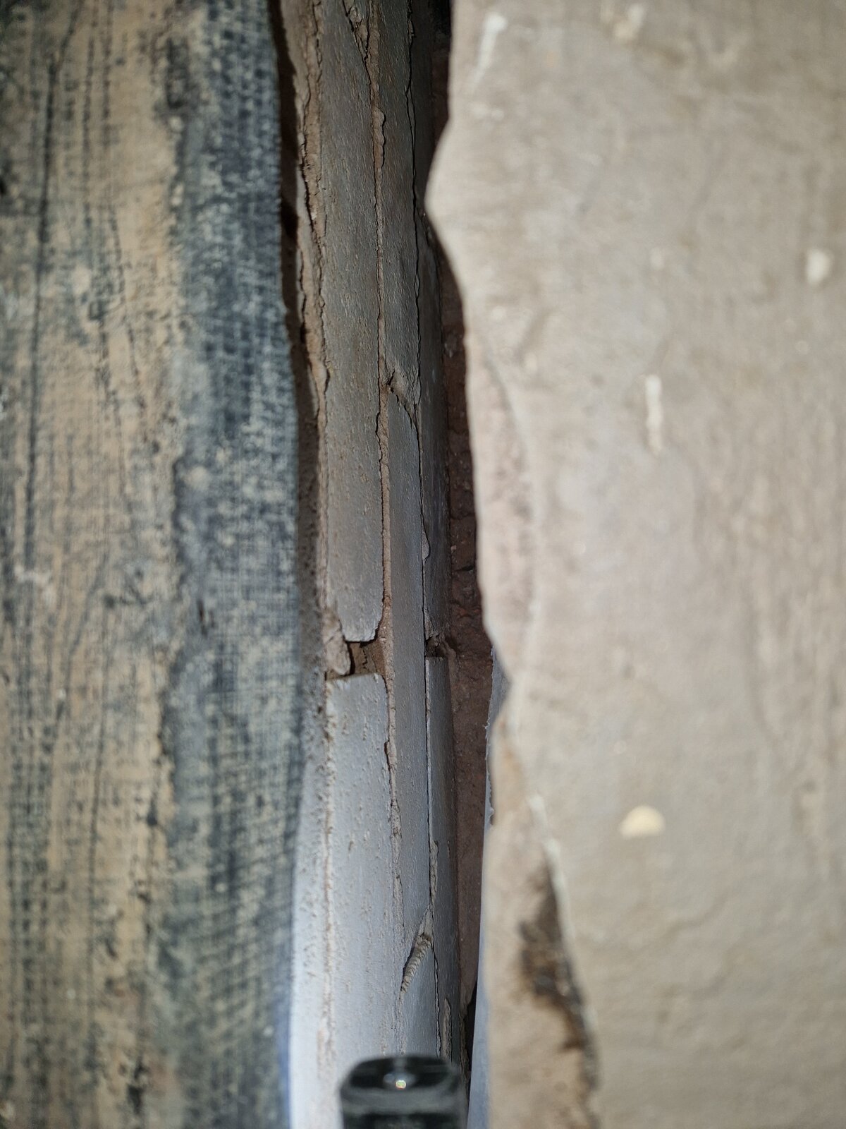

I've gone down and found a DPC coming from under the base of the house. This isn't along the full length of the threshold cavity.

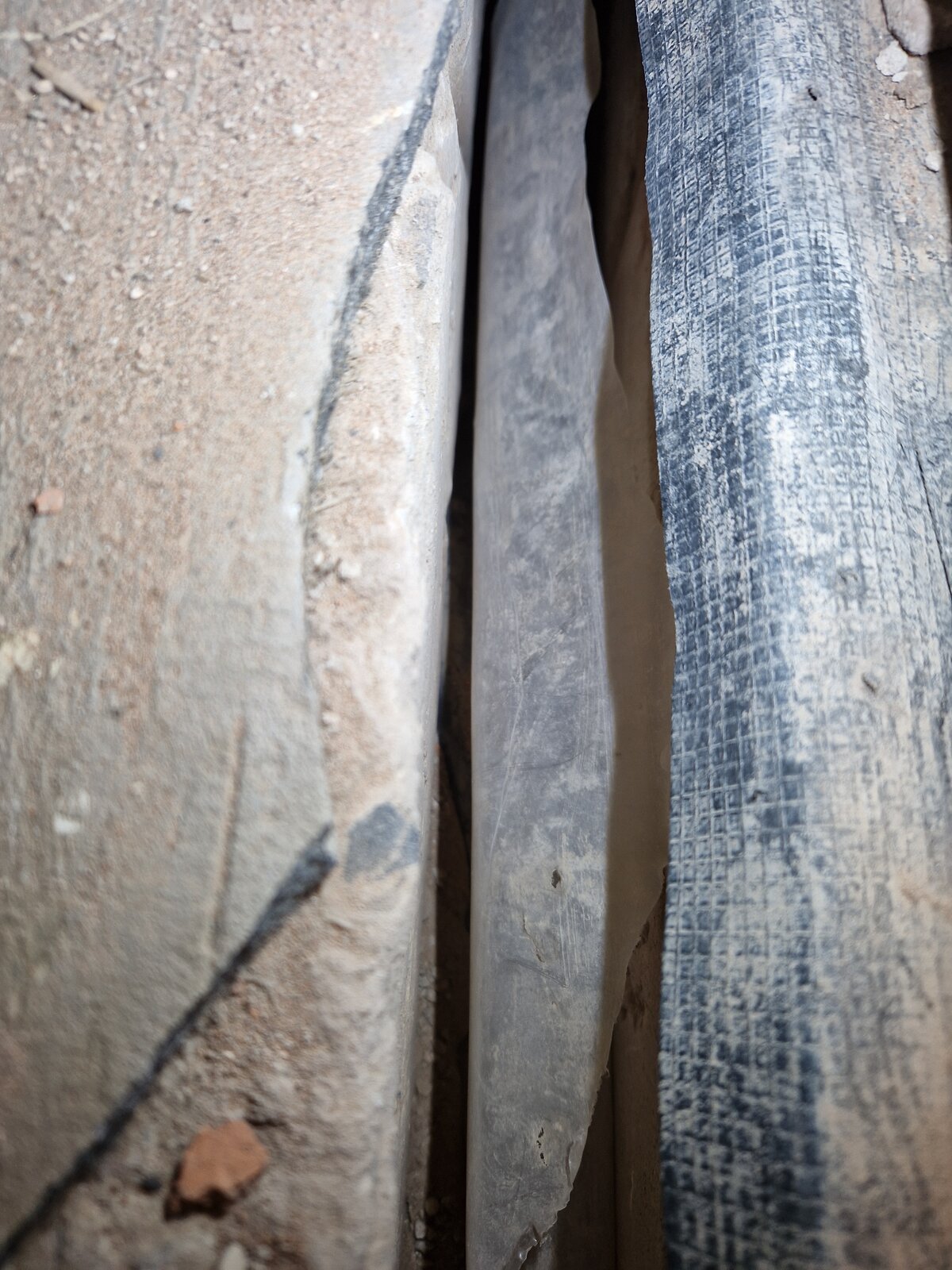

I've cleared this much so far, and feel I could be clearing forever? Shall I trim back that clear DPC flush then run fresh?
I've shoved a tube onto the hoover and managed to clear loads more. It's about 30cm clear below the lintel DPC.
Is this sufficient?
Yeah that will do.
I'd drop some plastic in and fill with concrete mix.
