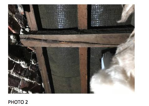

Hi,
Structural survey done on a house we are buying has thrown up the following. A cracked purlin, which "needs repairing with a flitch plate". See attached photo. Is this major work or cost? Should I be concerned?
Thanks!!

No, no big deal whether it can be repaired or replaced.
When they say a "flitch plate" do they mean bolting steel plates both sides of the purlin?
Still a relatively easy job, around £100 -£200 for the drilled steel plates and bolts and about an hours work.
