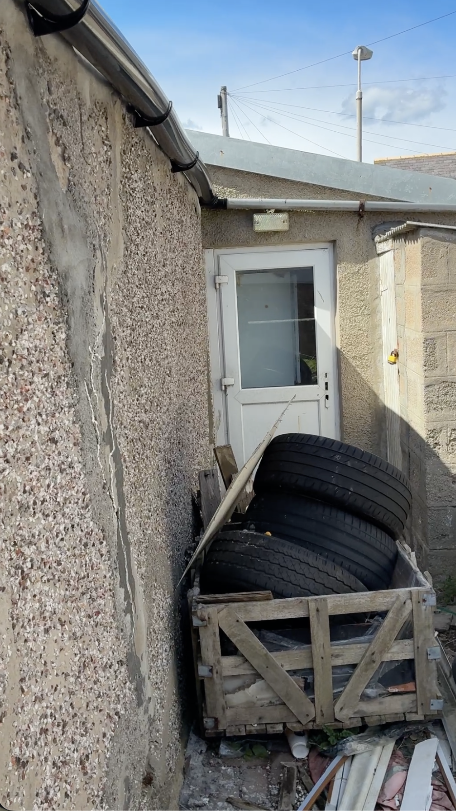

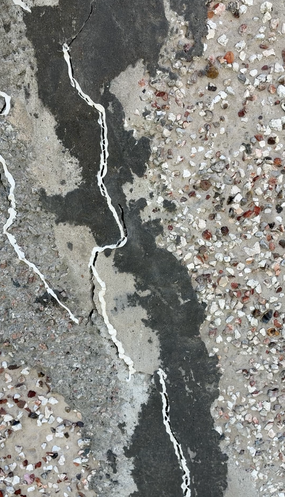

Hi All,
Turning to you knowledgable lot for a bit of info on what could be a major issue or just some cracked render.. and I've no idea how to tell the difference :)
I've been to look at a cottage by the sea, and it's all too good to be true, apart from one fairly big issue round the back. I've attached a couple of photos for your viewing pleasure.
The property is rendered granite not brick, which is probably relevant. It was built in the mid 1800s so it's been there for a while. I've tried without success to get someone local to the cottage to go for a look-see but no joy so thought Ithere was no harm in asking what you lot thought.
I never thought to take better photos, who thought getting a builder would be such hard work :)
The white lines are silicon, by the way... and I thought I was a bodger.
Photos attached, opinions welcome.
Cheers
Iain

It's too good to be true makes me think you have serious doubts about it and nothing can be said from those pics. apart from it needs a lot of remedial work. Is it very cheap? Is there any danger of it falling into the sea?
You really need to get professional advice from a surveyor, preferably a full structural survey, if you can't get a builder, the same as you would with any property of that age.

Stone built properties are notoriously ill behaved in terms of general flexibility. Couple that with the fact that someone has gone and covered over any clues that might have told a tale, with dashed render.
Is the crack visible on the interior too?

Not been able to get inside yet, but I guess that'll be the big clue :)
Sales agents are being a bit crap.. what a surprise.
It looks like the (most recent) movement is horizontal only, so hopefully not the end of the world.
I once viewed a bungalow where two corners had fallen downwards.
I would normally steer clear of rendered, but who can't resist a bargain. Render is inevitable in some coastal locations, just for weatherproofing. It's often used on houses that don't need it purely to hide issues. So if it's on the coast then at least there's an excuse.

Thanks! The village houses are all made of Granite but a few of them are rendered, which is a pity as the granite looks nice.
The agents are being really unhelpful, and with not permitting an internal inspection I'm beginning to think they're hiding something. The home report has lots of "don't buy before doing this inspection" comments, which don't worry me as much as not knowing until you get the keys that the crack goes all the way through.
