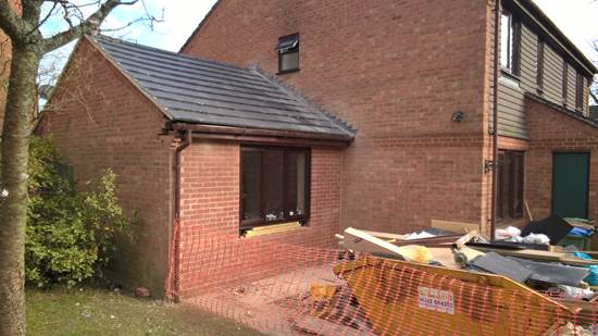

Cracks appeared about 5 months ago on the external side of a new front wall of my 18 month old extension. The wall also incorporates a uPVC window as shown below (picture was taken just below extension completion):
The extension is actually a garage conversion as well for a single detached garage that had a pathway between the house and the garage and the wall that was the right hand side of the garage started roughly where the right side of the uPVC is.

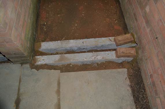

The extension was fully signed off by building control who got a thorough look at how the foundations which the cavity wall was going to be placed on and I also checked with building control about this method and they said it is absolutely fine and more than capable of taking the load. Here are a couple of photos that show how it was done:
Above you can only see one of two of the steel reinforced pre-stressed concrete lintels that form the foundations of the cavity wall. Both the lintels were embedded into pre-existing structures that formed the left and right hand walls of the garage.

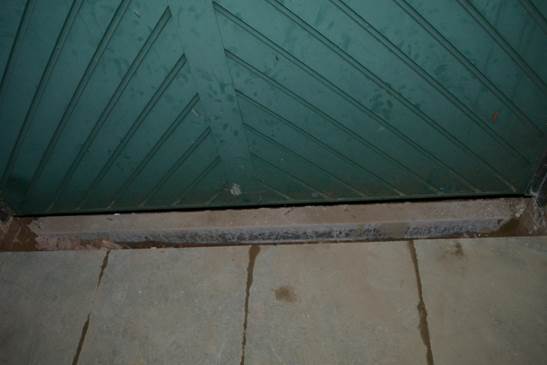

The picture below shows a couple of steel reinforced pre-stressed concrete lintels that formed the rest of the foundation for the wall that would fill the gap between the house and what used to be the garage:

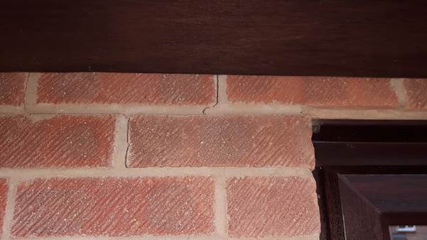

The crack that has appeared and starts a short distance from the top left of the window and almost immediately goes to the right where the left side of the window is (under 2nd brick) as shown in the picture below:
In the above picture for the top brick that has cracks either side and underneath it the crack to the left of the brick is just less 1mm wide and the crack on the right is 2mm wide. To the right of the 2nd brick down the crack is about 1mm. From then on all the other cracks are hairline.

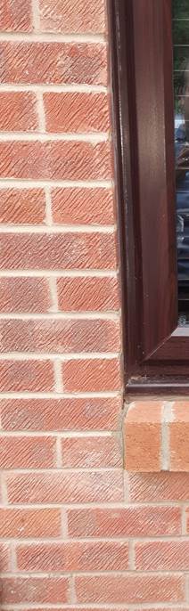

The picture below shows where the left side of the window sill where the hairline crack continues down for a bit:

Looks typical of thermal cracking (shrinkage), and the crack sound is typical of it too. If so its not an issue, and best filled with a clear mastic.

Brickwork can expand in the heat of the day and contract at night when it cools. That's normally when it cracks. If the mortar is stronger than the bricks the cracks can go through the bricks instead of the joints.

Thermal cracking tends to be once only and does not get any worse. Thats a small panel so would not be expected to contract much in any case. Monitor it over four seasons to confirm.
If the cracks do widen (and not close) after monitoring, then that might indicate ongoing movement which would need investigating further. But as it is you can leave it for now.
I would have said there is not enough brickwork to have any kind of meaningful thermal expansion. I just cannot get my head around Woody's thermal "shrinkage" theory that he keeps repeating, to the best of my knowledge bricks don't shrink when they get warm, they expand. Also moisture/thermal movement in clay bricks tends to give a crack with a fairly consistent width for the full height of the crack, whereas the photos seem to show the crack is wider at the top and tapers out just below the window.
I would be more suspicious of that strange foundation detail. Most of the weight of the front wall and roof are now concentrated on that narrow brick pier that was the right hand side of the old garage door. Was the original foundation under that pier strong enough to take that concentrated load?

@wessex101 - The foundation isn't strange according to building control though apparently. Building control explained to me that those types of lintels in my case can easily support that type of setup when embedded into existing footings where the right side wall of the garage used to be and on the left side of course. I am not at all knowledgeable in building matters (as most people probably aren't) and so that is why I have to trust the people involved. Just out of interest, if the foundation were affected would I not have seen other areas crack including inside as well as out?
Granted, concrete foundations are more common I am sure but instead it was decided the lintels were sufficient for an ex-garage door opening and I wasn't having a 2nd floor.
