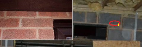

The attached picture of the inside of the room and the red circle where the brick with the crack either side at the top and the yellow line where the lintel approximately comes to an end. Not sure if there would be a correlation with the cracking? All pre-existing rafters used in the garage were kept in place during the conversion and they now rest on a wooden beam going the width of the wall.
One thing he was pretty confident to rule out was subsidence/heave due to the nature of the cracking.
Another thing I have noticed is that there are screws securing the wooden panel for the eaves on the outside so I might undo those to take a look at the brickwork above and behind and I expect to find further slightly larger cracks.

I have taken another close look at the cracks and I am pretty certain no changes to the width of the cracks has happened and it certainly hasn't progressed any further on the mortar or brickwork.
If I was to see the cracks widen ever so slightly would their be cause for concern or would it simply be thermal adjustments taking place still? I am at the moment in no rush to fix yet as I want to see what happens but at some point I will want to fill in by repointing the areas affected.
If you are concerned (which you obviously are) you can get crack gauges (Google it, there's loads)- basically 2 bits of glass, you fix them either side of the crack and then get numbers to read rather than messing about with feeler gauges or a tin ruler. Don't think you've got anything to worry about structurally, worth squeezing a bead of silicon into the crack to avoid any water penetration problems
Thanks @oldbutnotdead . You have just jogged my memory about the crack gauges. I am not hugely concerned as I don't think there has been movement but the gauges should give an accurate way of observing.
