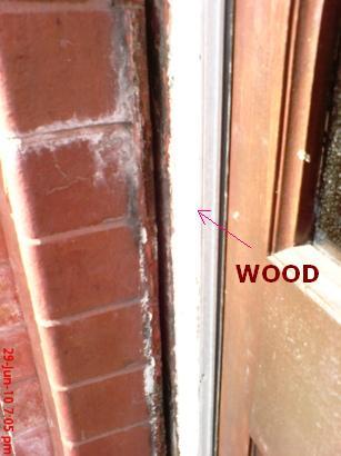

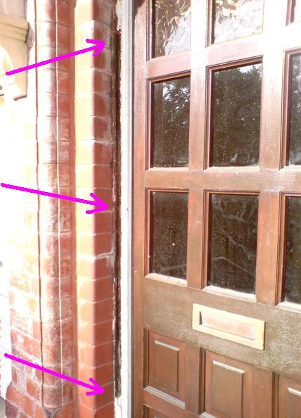

Any ideas on the best way to seal the gap between the door frame and the brickwork?
The original one has cracked, and easily pulled out by hand and screwdriver.
just for the record, the door is covered by a door canopy, and therefore not open to the elements, just the tempreture.
The door frame is in good condition just like the brickwork.
I'd normally use silicone glue but the gap is 1" wide (and silicone glue only gives max 10 yrs life)

for the door,id use some expanding foam,then fit some 1" quad or similar all the way round.

Trowel mastic for the gap around the door frame. The bath isn't a bargain as the panel don't fit properly.

Is there a way of making the Mastic stronger, to stop it from cracking!?

Trowel mastic will allow limited movement so you don't want it to set "rock hard". If it's cracking, the stuff you're using is carp / out of date.
