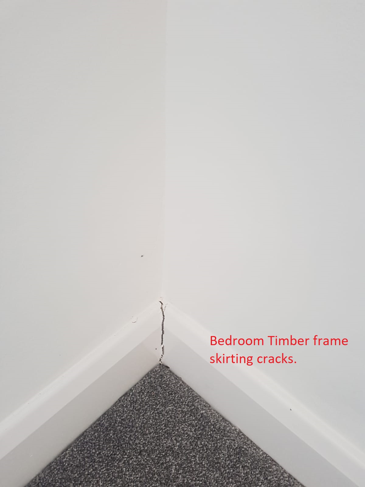

Hi All.

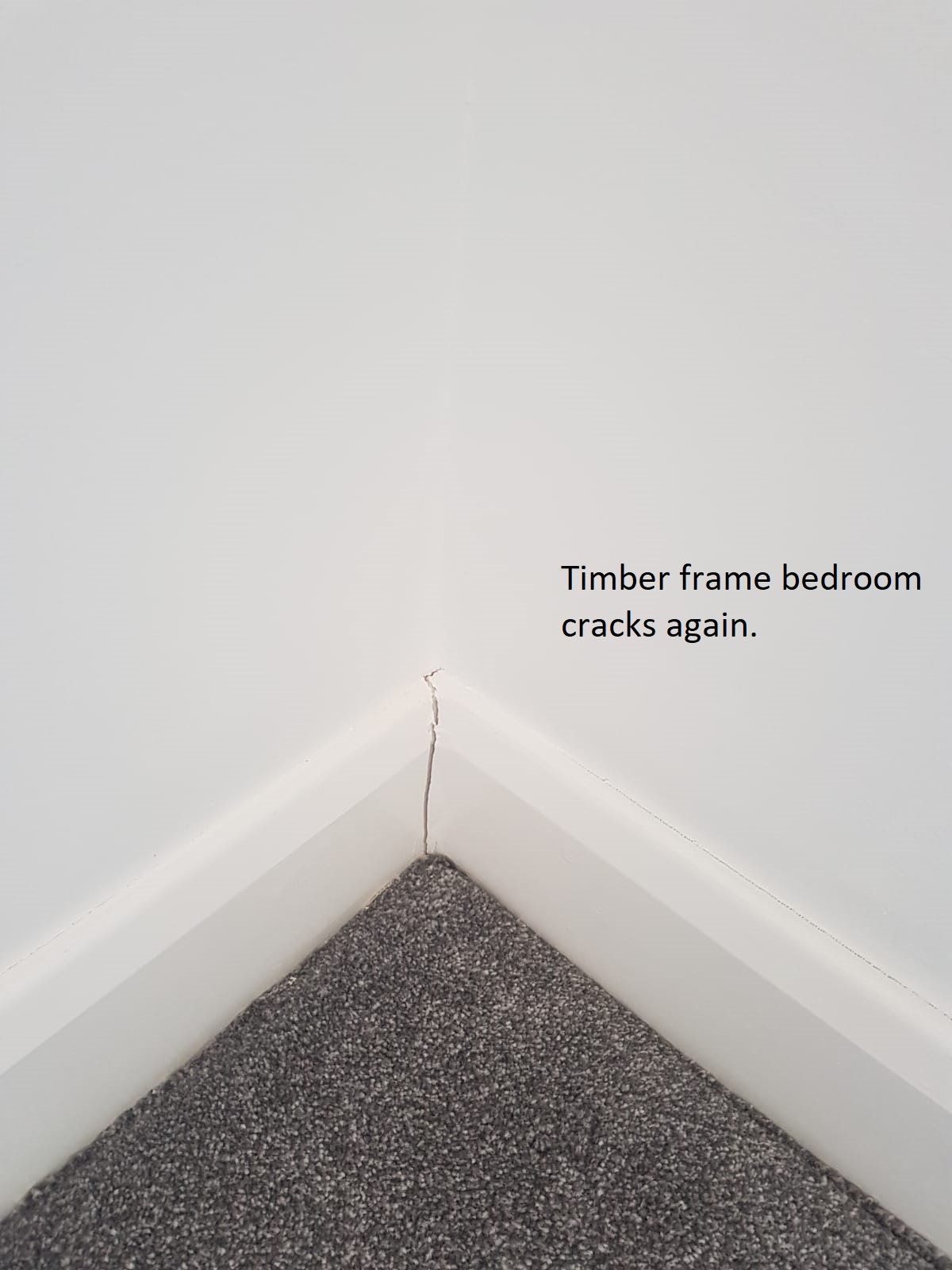

I have just completed an extension, timber frame at the top and the original house is brick at the ground floor. About a 2 months ago, I started noticing some cracks in the first floor which is all timber frame + Acrylic coloured render on the exterior.

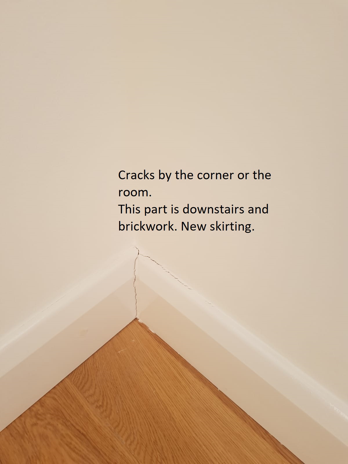

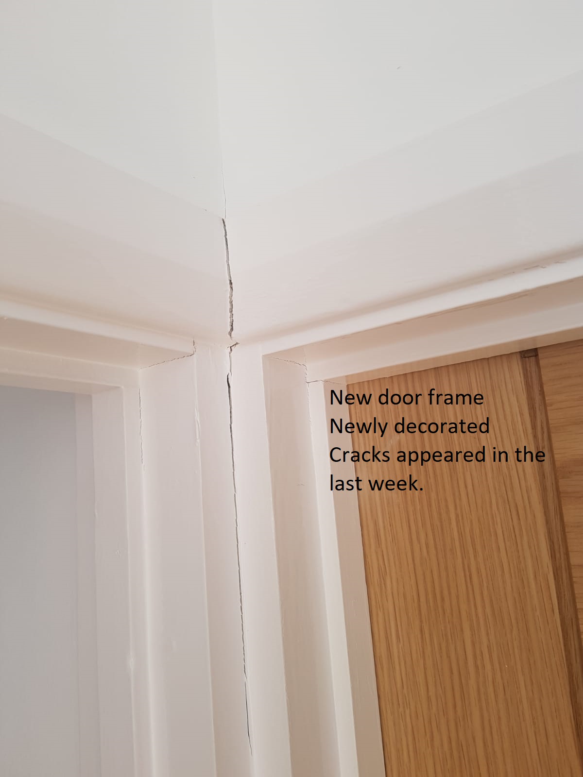

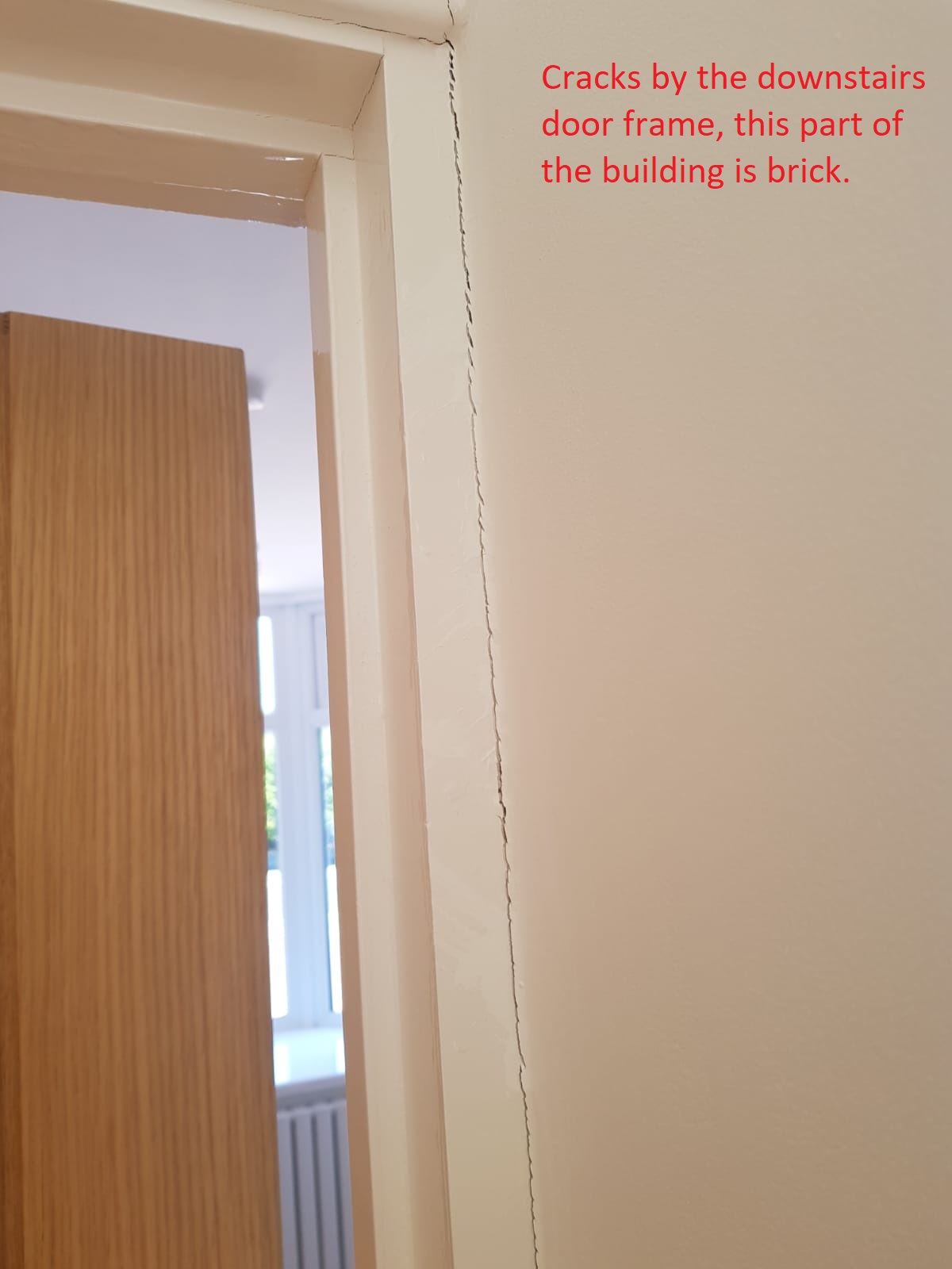

Now with the very hot weather lately, I did not open the windows on the first floor but I have now done so for cross ventilation etc. I thought the fact that the build is timber frame, just some movement on the timber aspect etc. However to my horror, this week the cracks have all gone onto the ground floor all over the place, which is not timber frame, the ground floor is all brick work. I have cracks all around doors, skirting etc.
Please note that this is a newly decorated house, new skimming, filling, painting etc.

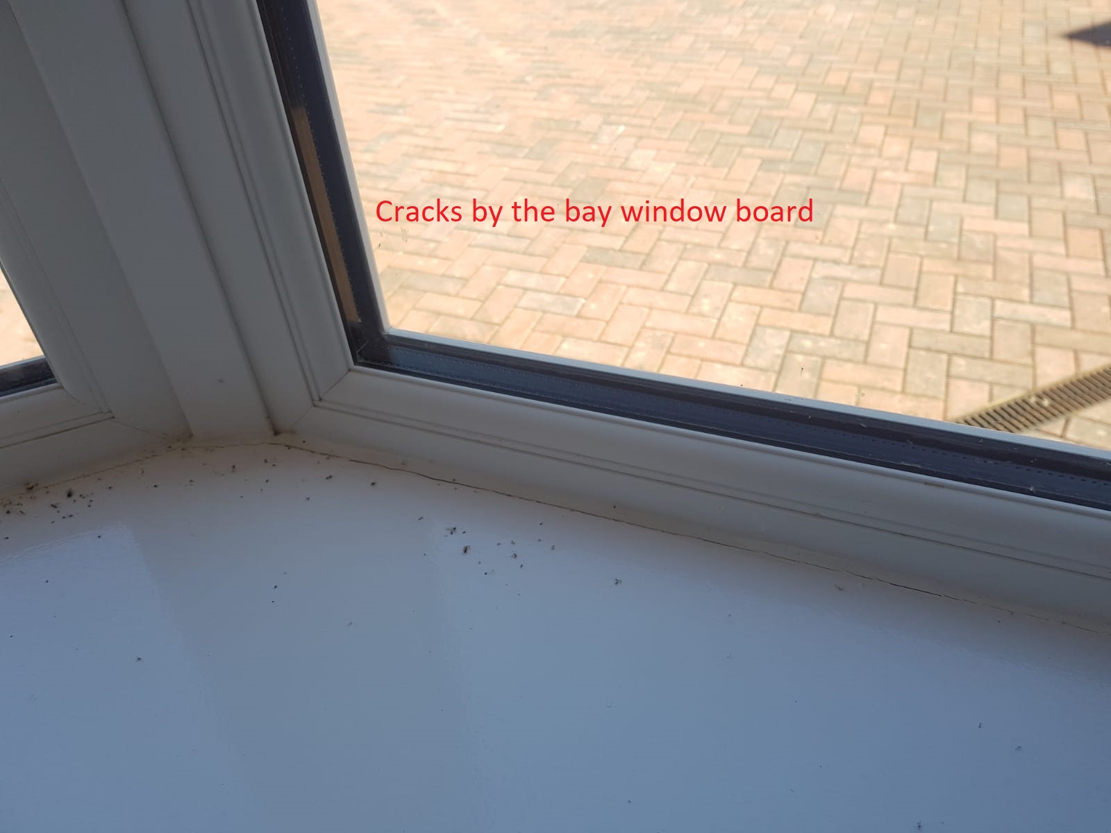

Please see attached pictures and advise on what I can do, I have opened all the windows in the ground floor now for cross ventilation. I closed them all before as the house is empty and dont want to have risk of burgaly etc.
Is there an explanation for the cracks or is there anything that I can do to resolve/prevent ?
By the way, this only started in the last 10 weeks when the weather was getting hotter.

You need to give the extension about 12-18 months to settle down
Internal skirtings are scribed not mitred, for the very reason you are seeing there. It will continue to crack and you will be forever hacking it and filling.
Opening windows produces a cooling breezy effect.
Does that make any difference?
Massive. Internal corners should be scribed.
An Idiot on this very forum Called Joe-90 used to insist that internal mitres was the done thing. He was the most clueless diy'er I have ever come across. There is a long thread somewhere in the archives about it.
Every junction you have a crack is plaster to wood, or wood to wood.
Wood shrinks.
It akways happens. In 30 plus degrees it might happen faster
