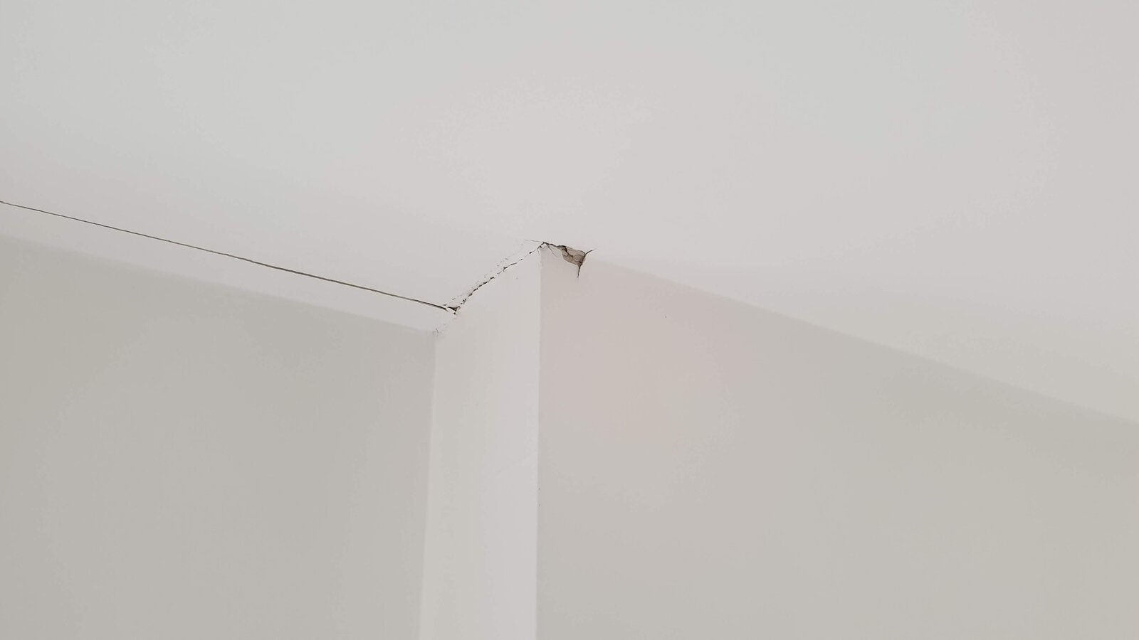

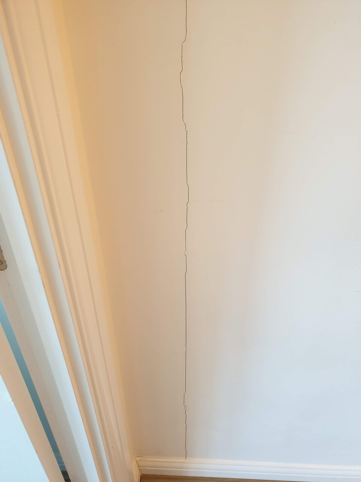

Hi,
There are lots of cracks in on the walls of my flat where two plasterboards meet. The building isn’t settling because it’s 8 years old now but I think the walls still move ever so slightly especially from summer to winter when I turn the heating on. I tried fixing one by scrapping it out and filling with common polly-filler but the crack reappeared. Does anyone know a better way? Perhaps something flexible that can handle slight movements? I’d like a longer lasting fix if possible. Cheers!
This is an example of a bigger crack:
This is one which I tried to fill but it reappeared:

Have you considered lining paper?
Yes there are loads and loads of Plasterboard crack topics many different possible materials to use?
Problem is that the plasterboard in your home will be fixed to timber which moves dependent on the season, combined with the [possible] lack of a correctly filled joint, the most common causation being a lack of a [simple] scrim mesh that in effect reinforces what is known as a well Known very weak area of this form of intenral finish.
Ken.
No I haven't heard of lining paper. It looks similar to wallpaper when I see it on the youtube videos. I'm not really keen on covering the whole wall as it's a big job, but if I use a narrow strip, I'm not sure how to make the edges not show up.
I have heard of scrim tape but I'm not sure how that would work. How can I the mesh showing up when I put filler over the top?
To make the edges not show up, carefully tear it - do not use scissors or a blade - hand tearing makes the fibres separate more so you can blend them in.
Ok thanks mattylad. So is the procedure:
Scrape out the crack, pre-fill, stick paper on then put more filler on top?
What sort of putty/filler should I use?

I would open the cracks slightly. You need to make sure that you do not cut through any scrim tape though. I use a chisel a couple of mm either side of the crack and push gently until the filler falls out.
Once done, buy a tube of Toupret Fibacyl. Gun it into the crack and remove any excess. It is like decorator's caulk but has tiny fibres in it. Leave it to shrink back (over night) and then fill with Toupret RedLite which is a lightweight filler and allows for a degree of movement.
As a belt and braces approach, I often brush PVA wood glue in to the crack first, wipe away the excess and then let it dry before using the Fibacryl. The RedLite filler doesn't change in colour as it dries so it can be difficult to work out when it is dry. I normally leave it for a few hours and then sand with 180 grit silicone carbide paper. I love the fact that the dust doesn't become statically charged and stick to everything (unlike the powder fillers).
KenGMac is correct that lining paper will mask hairline cracks in most cases.

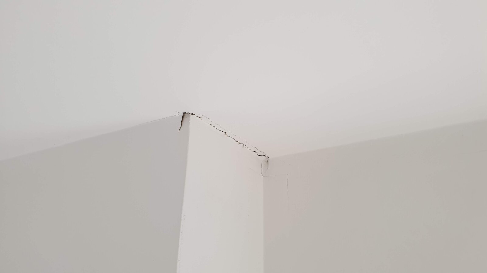

I just have one more question. I also have a slightly different but similar problem, where I get cracks were the walls meet ceiling. I parts the lining paper is coming undone. Do you think the Toupret Fibacyl + Redlite combo would work in this scenario as well?
