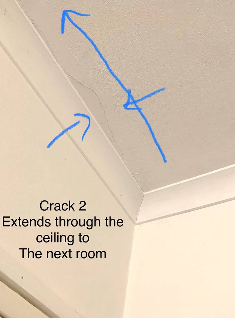

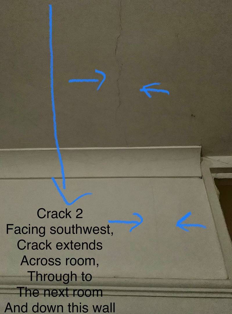

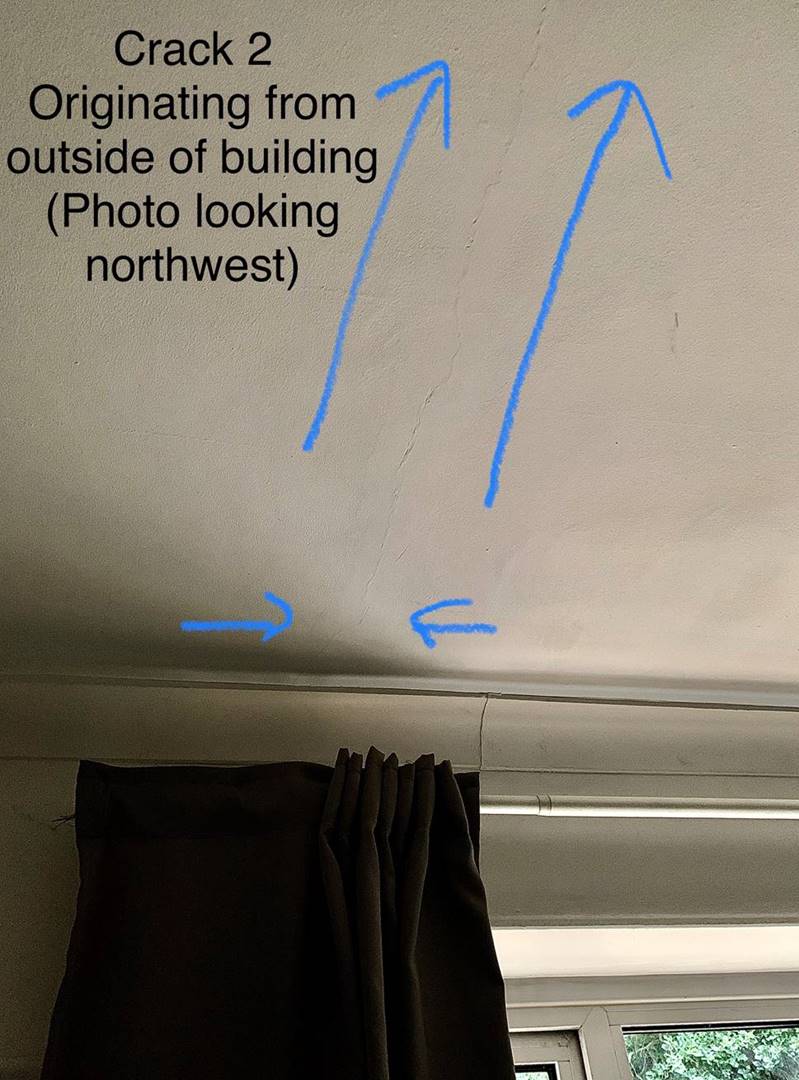

We live in London in a block of flats (not on the ground floor) and have noticed a crack in the ceiling that runs across one of the rooms (room 1), through to the next room (room 2) and horizontally down two of the walls (in room 1).
I obviously don't want this to worsen.
Photos attached and I played around with the colour so the cracks show up. The cracks are under 1mm in width. Also there are 2 separate cracks in the ceiling of room 1, it is not a continuous crack, in the ceiling it starts and runs into a third of the room, then there is a break, and it continues about a foot to the right and the runs across the room.

I contacted the leaseholder and through the building insurance we got a loss adjustor / structural surveyor who said:
"These ceilings appeared to be on a solid concrete slab. The pattern and direction of the
cracking suggests that this may coincide with a structural joint in the concrete slab above,
or possibly a change of materials from concrete to steel. There are no signs of significant
corresponding movements or cracking in the supporting walls below and we find therefore
this is a maintenance issue related to the structural slab."

"I recommend that test areas of plaster are removed around the ceiling cracks to investigate the backing and that reinforced repairs using cutting out and filling or plaster reinforcing scrim techniques are used before re-decorating."
My question is, what type of tradesman will be able to help us with this? And where do I go about finding them?
