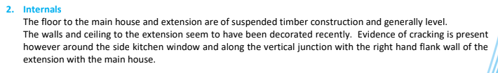

Appreciate the responses. I've received the full report now and its full of assumptions. All of which being negative. He was inside the house for less than a minute but rather than say there's no internal signs of damage, he has instead said I've recently decorated, which I haven't.

In his report he states that the cracks in the image above are probably historic and have settled but has said "The stepped cracking beneath the kitchen window would appear more recent".
I'm not sure how he could have reached that conclusion. This is about 1.5 metres away from the extension. Is that a valid statement for him to make?

Yes it's horrendous that an inept professional has caused such a big problem. Having read the report again, there are complete lies within.
The crack he refers to here is just old dried caulk which can be seen below. There's nothing other than that internally that could be seen as a crack. I'm not sure what the "vertical junction with the right hand flank wall" is, but there's no cracks internally. He even says so later in his report.
Rather than accept there are no signs of cracks internally, meaning the house isn't sinking he has just decided to say that there has been recent decoration. There are food marks up the wall near the hob and a cobweb in one corner! It's just whitewashed plaster walls that haven't been touched since a refurb in 2018. It's scandalous that he can just make up lies.
