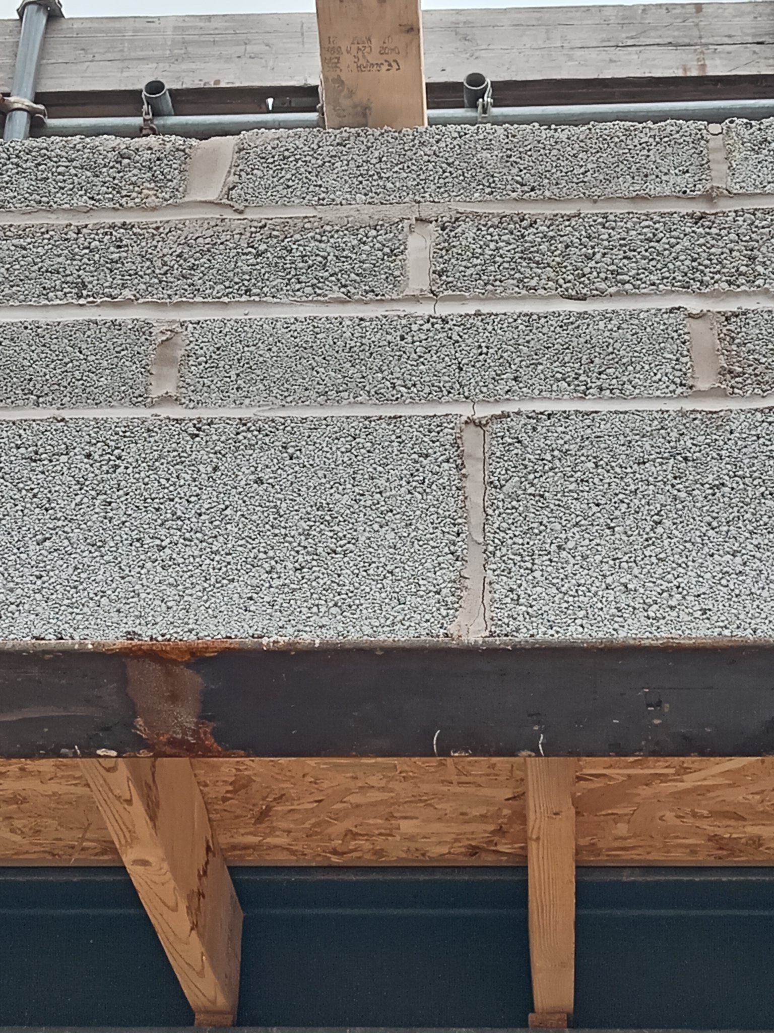

Midway along the outer 10m beam is the crack in the block above the beam that BC identified. Is that due to flex, settlement, shrinkage or to be expected ?
The left end of the beam had the original cracked blocks - in my 1st post - that were replaced - and it still has an acrow under it

The right hand end looks worse than the left TBH.
The crack looks like pure and simple beam deflection.

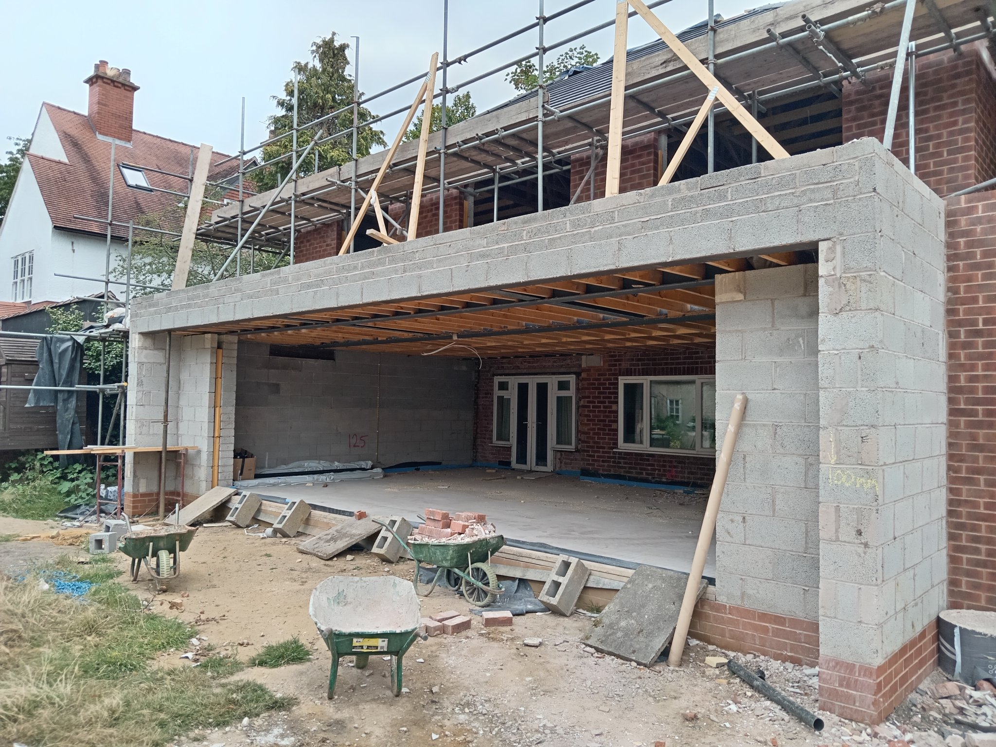

Overall it looks like a very curious layout: how different is your builder's version to what your SE originally designed?
The bottom plate looks to be rusty already, not been painted poss where it was welded by the beam supplier

Totally different my son says but I never saw my sons SE's diagrams
I'm no structural engineer but that just looks so wrong to me. I'm guessing bifolds across the opening. How on earth are they going to be reliable over that span. Just the thermal expansion and contraction alone is going to be a nightmare, both on the beam and the doors.

Holey moley that is one big span! How deep is the beam?

The returns on the outer masonry look woefully small. They look like they want to be the same size as the inner piers of masonry or similar.

The midway crack looks like it's a result of sagging, as the crack is wider at the bottom than the top. Whether that deflection is or isn't acceptable is for someone on the ground with knowledge and qualifications to decide. But as it stands you'll always have a crack, even through the render right in the middle which would definitely concern most people, including future buyers - especially given the extremely wide span.
It looks like a car showroom to me, but this is what people seem to want. I'd wonder how the plans meet insulation criteria with such a large proportion of glazed area.
You need someone independent to come in fresh and look at the entire thing. Give them no upfront photos or explanations, just tell them you have concerns and want it assessed. Obviously this will involve money.
