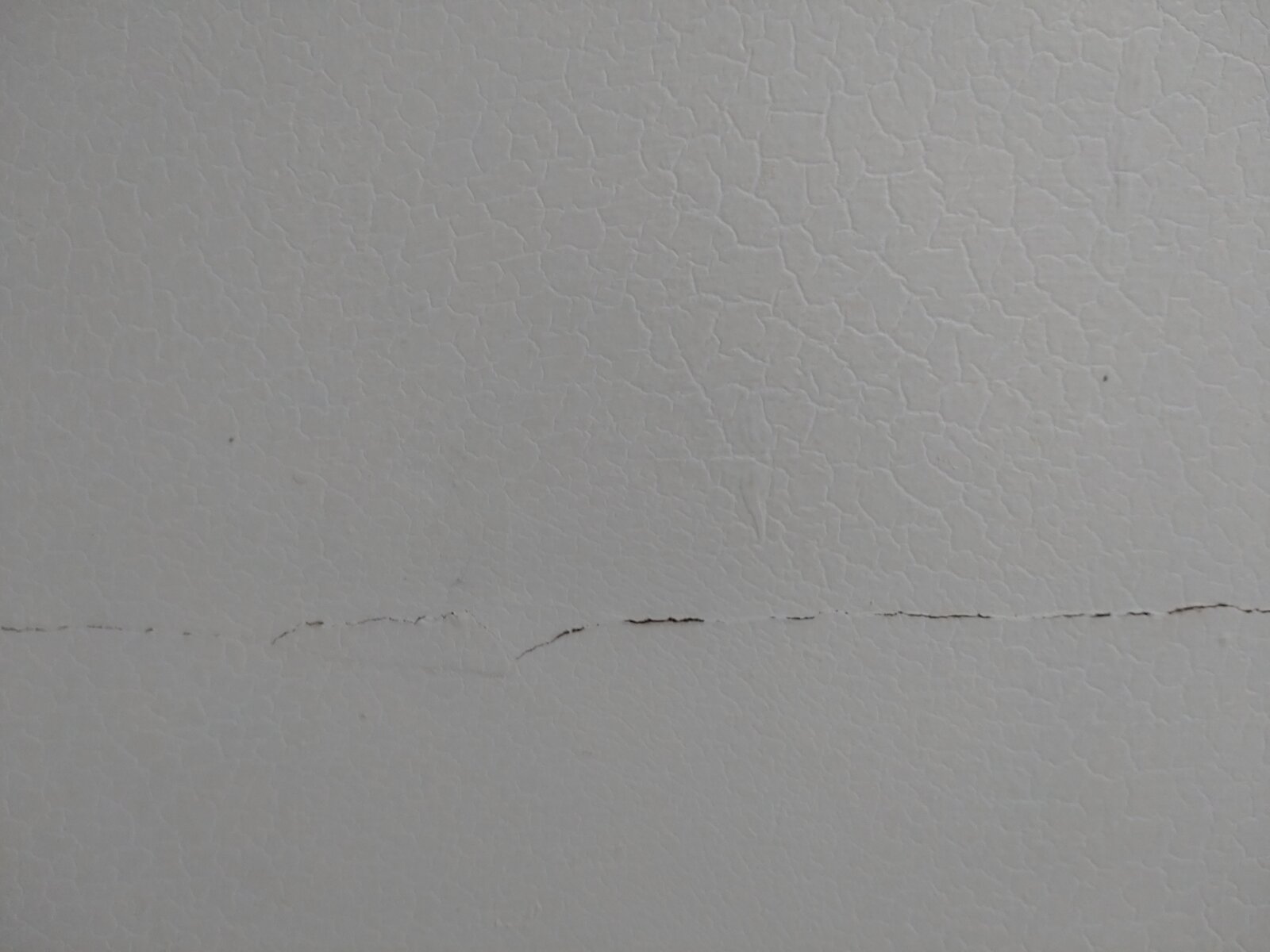

Any idea what's happened to this bathroom ceiling paint and how I should fix it? It's probably 20 years old. As you can see, the whole ceiling is crazed. It seems well attached still. I would rather not have to fine surface fill the whole ceiling!
A problem with too much condensation in the bathroom I would say.
Do you have a working extractor fan?
No extractor but it's not heavily used as we and the kids all use the ensuite. Window is usually open.
Any thoughts on Zinsser Peel Stop over the top, then eggshell or bathroom paint?
