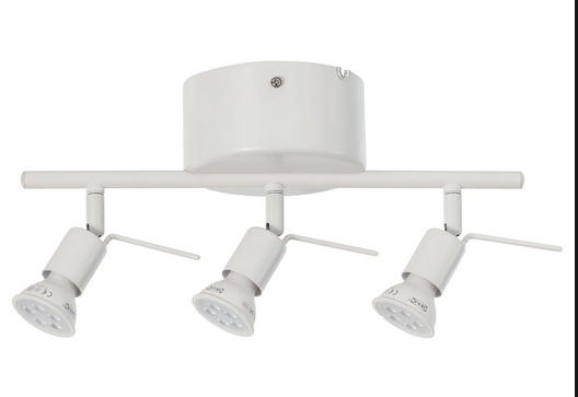

Where Ceiling roses are not being used, but the light fitting has just a two wire connector, do Regs allow the use of ordinary connection blocks or Wago's, placed inside the lights casing.
I see the loop in has been created behind light switches in other parts of the building here using ordinary connection blocks.
The Below light fitting has a metal casing, the earth wire will need to be attached in this instance ?

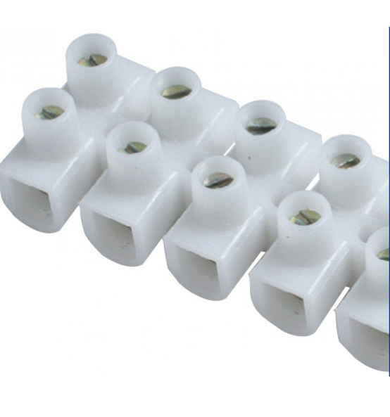

Thanks, this makes one wonder for what purpose are connection blocks ?
So where does the use of Connection blocks used in light switch back boxes as the loop in/out lie with the Regs.
