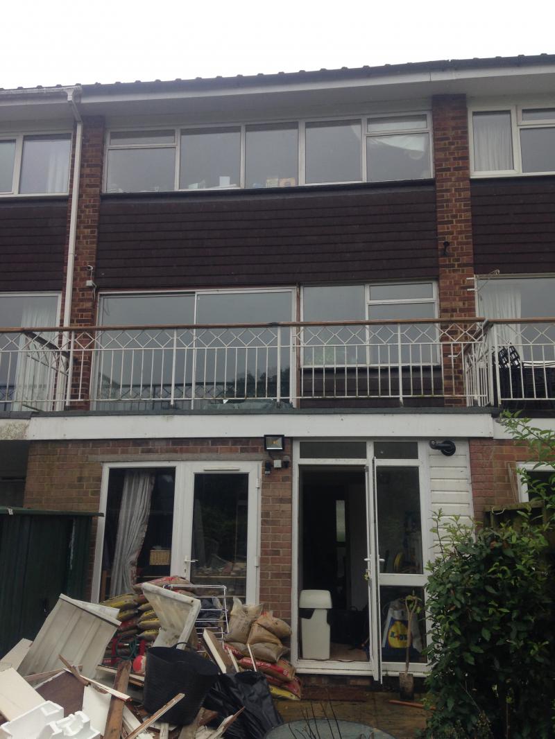

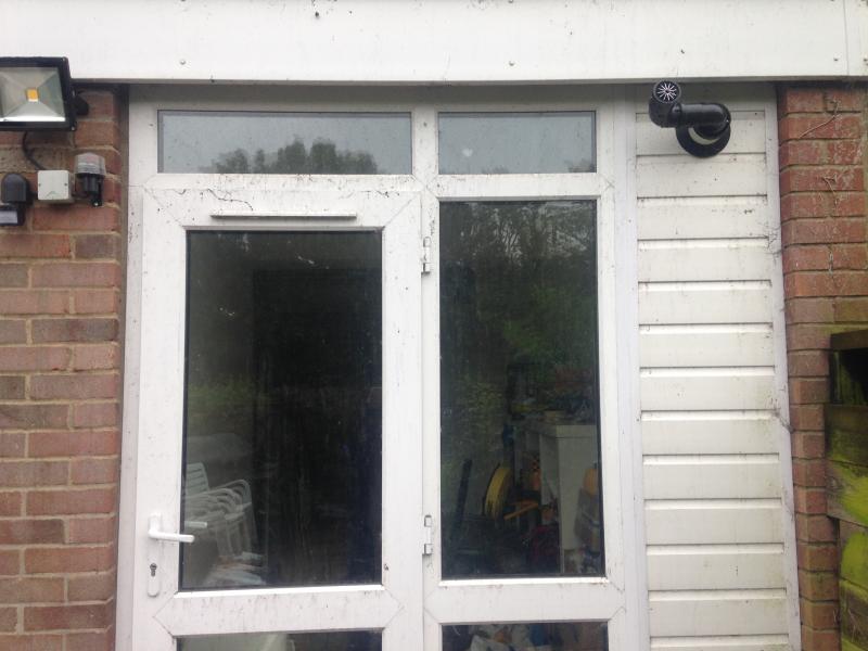

The boiler is a Worcester Bosch 25cdi. Here is an image of the back of the house.
. It is probably worth mentioning that directly above this picture is a balcony, so running the flu upwards beyond the top of the picture is not an option. I could run the flu up a little and across the house, but is going to look rather ugly.
Is it an option to get a 45 degree bend rather than a 90 degree just before the end of the flu so that the plume blows into my garden rather than next door? e.g. http://www.plumbnation.co.uk/site/worcester-60mm-plume-management-45deg-bend--pair--7716191089/
Are there more horizontal end terminations that push the plume sideways and away from the house?

stand back a lot and take a much wider photo that shows the whole house.
You already have a plume management kit on there, though I'm not sure how much good its really doing! Not sure how much better it's going to be depending on wind direction etc but yes you could in theory get rid of the two current 90 degree bends and put a single 45 followed by the end piece. Or if you have the original end part of the terminal the plume kit could be removed and this replaced and angled toward your house at 45 degrees anyway (it would be slightly upwards too).
You can just rotate the LAST elbow so it points up about 45 degrees.
That should prevent any complaints from any reasonable person!

I would normally agree, but this is the view from the living room on the 1st floor (just above the heating pipe).
In this case down is preferable to up, except that I don't want acidic water dripping onto my patio!
The plume kit is fitted incorrectly anyway on a Worcester you
Shouldn't cut or remove the pipe between the elbows so that needs fixing
