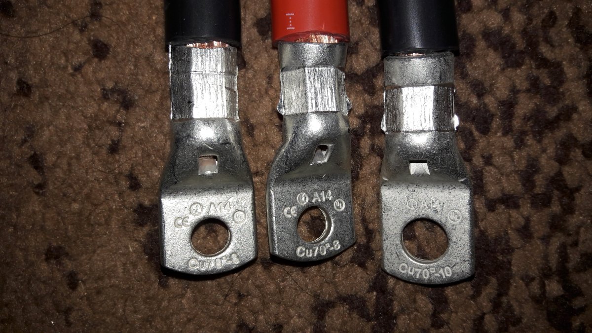

I am setting up a inverter and battery bank, I made some cables (70mm2) with a hydraulic crimper from eBay. Results are OK'ish but wanted your opinion whether to crimp it twice (overlaps a bit) or just once in the middle of the lugs.
I've attached picture of both two (on the left) and one crimp (on the right) and do they look OK.
Thanks in advance.
PS: I will be filing down the sharp edges and heat shrinking it later.
With that type of crimper I would just do it once. I had a problem with that type as the auto cable was really around 60mm and the auto crimps were designed to be soldered, so I used mains type crimps, but the dies did not grip the cable that well, so I used the cheap crimp pliers with the adjustment screw 10 - 120mm with those I did crimp twice. If you have got 70mm cable and 70mm crimps then no need for double crimp.
With inverters I used 2 x 35mm cable as the 70mm put too much strain on the lugs. Getting 4 x 35mm cables to look neat between batteries and inverter on the narrow boat is much easier than 2 x 70mm cables which simply don't like to bend, I used welding cable with some and auto electric with others, the welding cable was a lot more flexible.

My cable and lugs are 70mm2 and the crimper has the right size die 70mm2 as well. I wasn't sure if it was ok to do overlapping crimps on the lugs. I had some cheaper bell mouth type lugs and I could easily fit 2 crimps but these are straight end, seem to be little shorter hence the overlap.

I'd get a small amount of Heat shrink on the ends, i always use it on lug crimps - looks much better too

Thank you guys for your help, much appreciated, I'll be using cable ties to keep them together.
