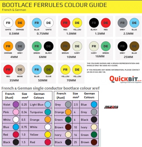

hi all I’m a heating engineer and I want to do more crimping for ease of wiring etc. Off boilers it’s is 3 core in white sleeping not grey and is about the same diameter off pumps and zone valves.
My question is what width is each individual wire and should I use the blue or red pin type crimp
Thanks in advance sorry if it’s a daft question
Red is for 0.5mm² up to 1.5mm² wire.
Wires are measured by cross-sectional area.
The flex in question if loose is likely to be 1 square millimeter,
That fitted to pumps and valves, perhaps 0.75mm².

Correctly sized ferrules and a proper crimper would be better.

Having been using that style of ferrule for quite a while, I keep meaning to buy some uninsulated ones (like this). I often find terminals where the insulated ones don't fit well, or there isn't space for the insulation (little distance between terminal and cable clamp for example), and the insulated ones are particularly bad if you have to put more than one wire into a terminal. Using the uninsuulated ones gives you the benefits of not struggling with "whiskers", but without the problems that can be encountered with the insulated ones.
There are two main colour codes for insulated crimps. One is French and the other German.
