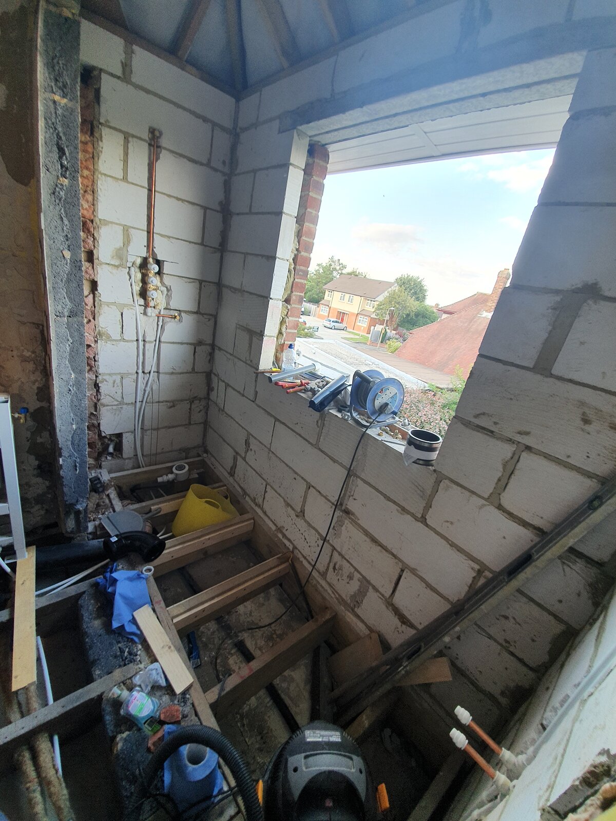

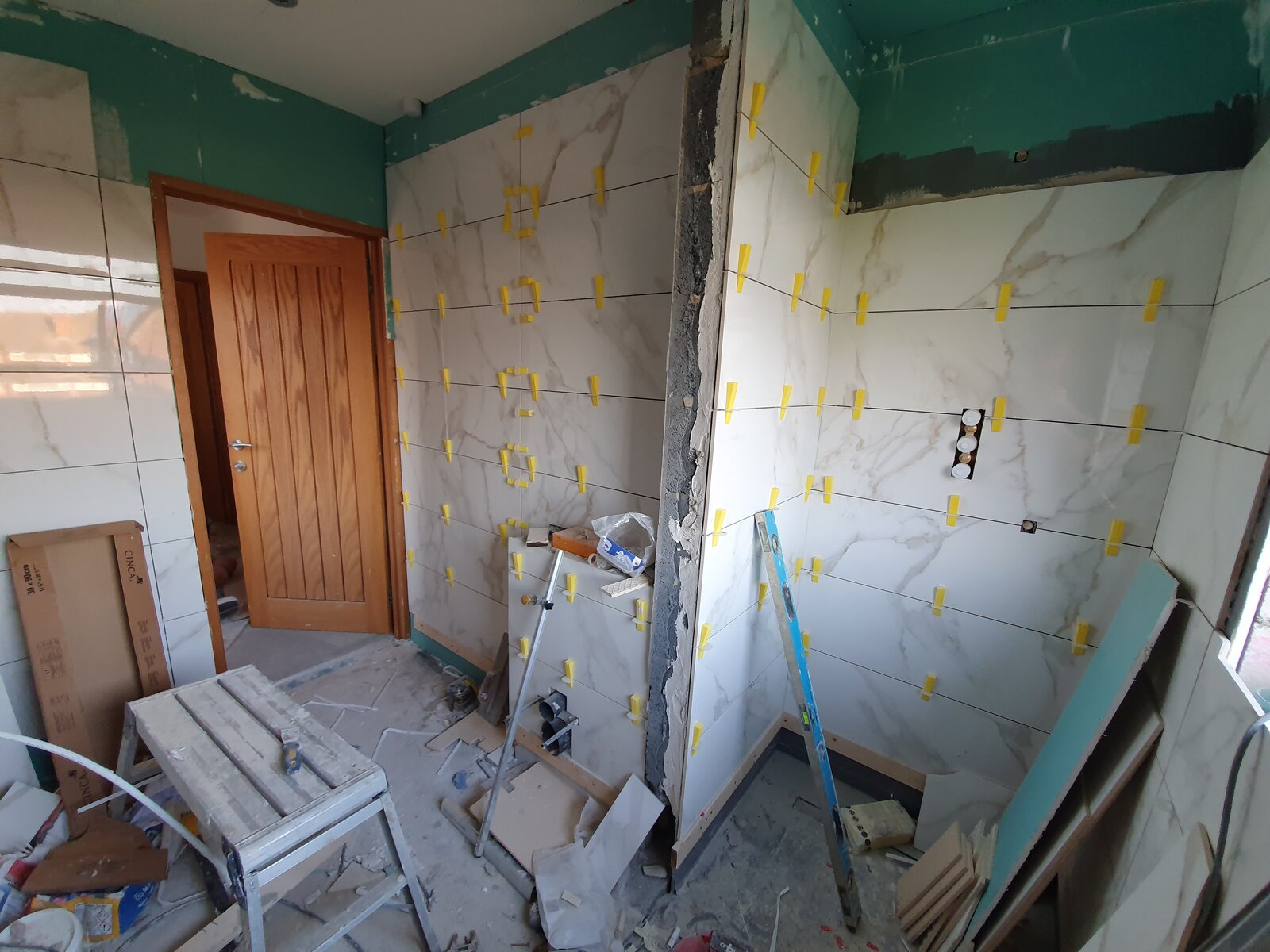

So I had a chance to do the following today:
Close all isolators hot and cold on all three taps. Turned on the shower and it made no affect. I tried turning the thermostat in all directions slowly and it barely made a difference to the temperature. So it looks like the shower thermostat needs replacing? Only issue it's behind tiles so I was really hoping it wouldn't be the shower. Would this cause a cross over between hot and cold pipes? Not sure how.
The other method I tried was close all valves including hot and cold on the taps then turn on the hot valve one by one to see if there was any increase in the temp. Unfortunately not.
So likely its the shower valve? You can see the shower valve in the pics.

Another thing just noticed now. If I open the shower which now is barely lukewarm after trying different thermostat settings, the bathroom tap hot water is scalding. Sadly it doesn't work the other way. Either way I think the thermostat is faulty on shower. So would this cause the cross over if open at the same time the tap closest is scalding?
