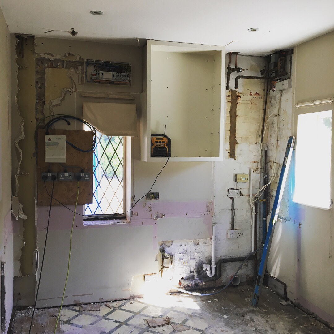

I am refurb’ing my utility room and would like to move the CU so it is in a cupboard.
The new CU would be c2.5m from the current CU, and similar distance from the meter which is close to current CU (on outside wall).
How far can the CU be from the meter before a submain is required?

The plans have the new CU in the cupboard (out of shot to left in photo). But the architect annotated the meter in the same cupboard. However it is on the outside wall.
The main contractor has suggested there will be a variation to instal a submain, due to location of meter.
I am looking for options to consider to potentially avoid additional cost.
Contractors electrician will be doing all work, including final circuits and BR approval.

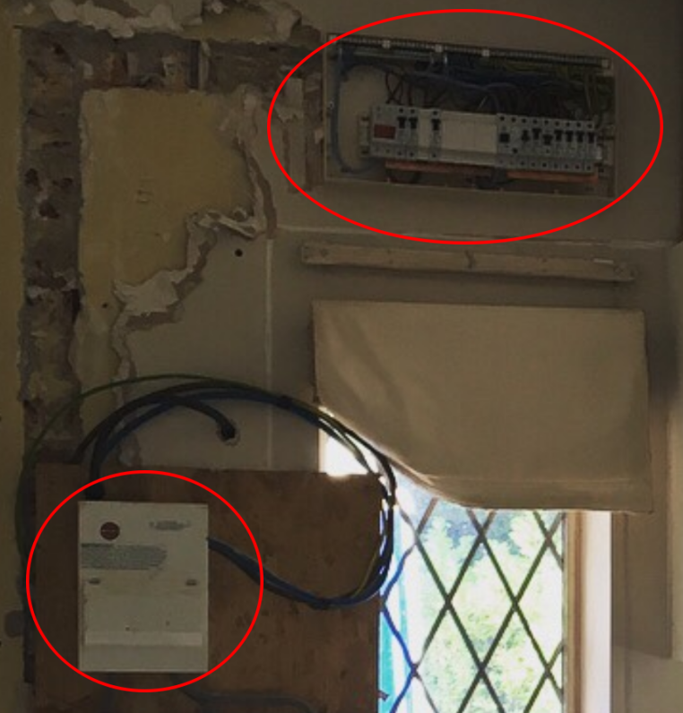

The upper CPU is my old CPU, the lower one belongs to the builder for his temporary supply.

As long as cu within 3m of meter it should be fine.
The issue is all the outgoing cables need moving.
Agree. even if you need over 3m cable length it's not hard to deal with.
what the builder calls a submain would just be an isolator or switchfuse (to keep the DNO happy) close to the meter, and then some armored cable buried in the wall to the CU.

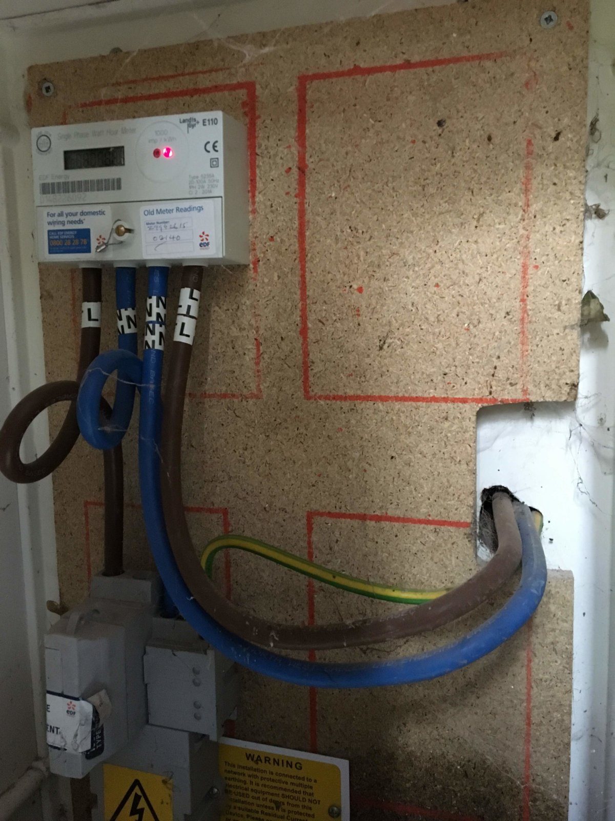

This is my meter. Are you allowed to put the Submain in here, or do you typically mount inside the house?

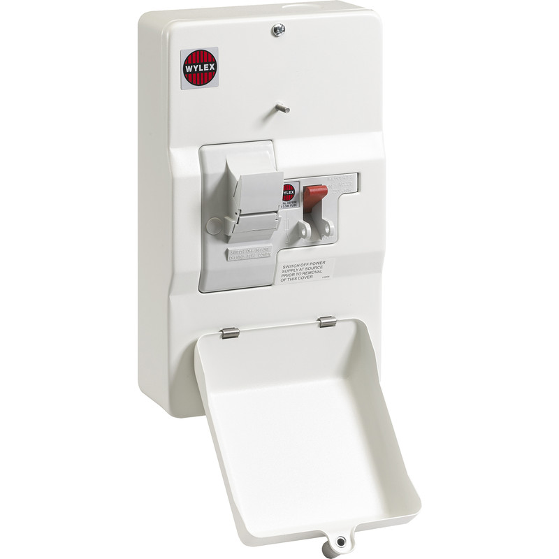

Is something like this what would be required?

Yes you can put it there, in fact the bottom right rectangle is for an isolator.
Technically it should be the metering company's isolator, but i don't think you'd get in big trouble for it.
Really, only the DNO can give you a definitive answer about whether you need your own fuse in the outgoing tails. There's a widely accepted rule of thumb that at over 3m one is required, but I don't think that that is formally declared anywhere. Concealment of the tails is another trigger.
