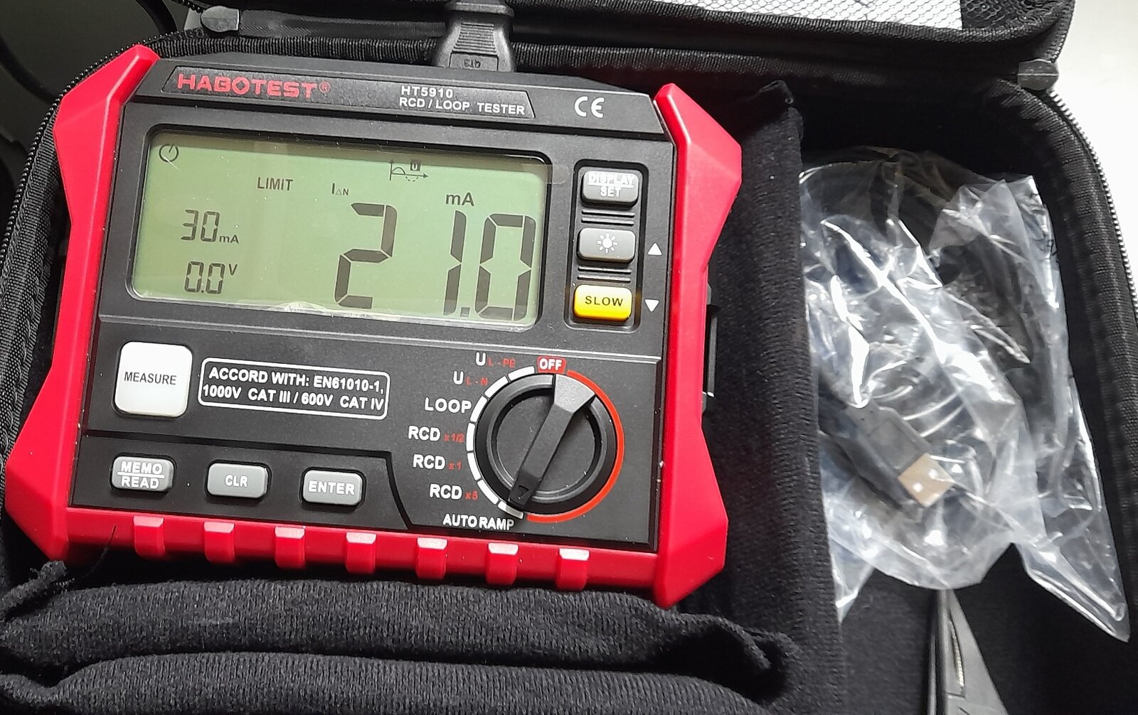

Working on electrics, one must test what one has done, but these Diffrence line neutral 8 Feb 24 reduced.jpgRCD tester ramp.jpgVC60B.jpg are not cheap, likely cost me around £150 to get the test gear, and for most people cheaper to get an electrician to do the work than hire or buy the test gear. I admit I don't always test as I should, but if something goes wrong, then one has to get the testers out.
Likely most faults can be found using the multi-meter Diffrence line neutral 8 Feb 24 reduced.jpg here seen testing the earth leakage, but same meter has non-contact volts test, volts measured with leads, ohms measured with leads, and AC and DC amps with the jaws, so my total earth leakage is 8 mA as shown with the meter. That meter cost me £35. As did the insulation tester, the RCD tester was around £90, so what have you got to test with?
