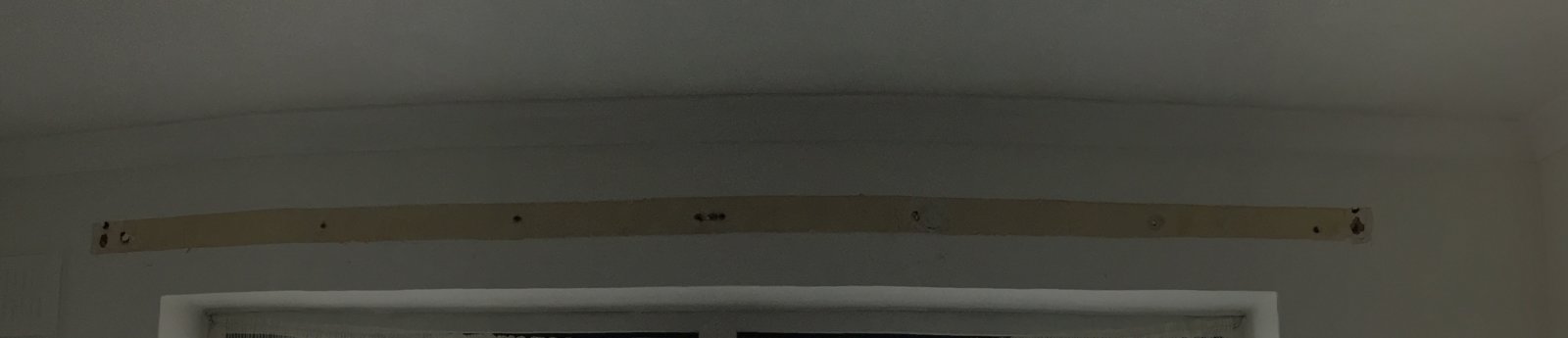

The last curtain pole and batten fell down when the windows had been wide open and it had ripped from the wall during stormy weather. They’d been up for the four years we’ve been here and who knows how long before that.
This week, I decided to put up a new batten and curtain rail.
The window aperture is 2030mm. I used standard 20.5 x 69 x 2400mm redwood from Wickes.
I drilled holes either side. All four holes were six inches away from the side edges of the window. The topmost holes were six inches above the top edge of the window.
Even then, the best I could manage were 35mm holes using bosch multi construction bits on hammer mode. Walls are brick.
I used fischer nylon plugs and fixed the batten up. Went in nice and straight. Added decorators caulking to hide the tiny gap between the bottom of the batten and the wall. Painted over it.
Today, affixed the curtain brackets and rail went up. All good. Hung the (rather heavy) curtains up. Top edge of the batten started coming away from the wall. Whilst removing the curtain rail and curtains, the bottom screws and plugs came out of the wall. The batten is still hanging on the wall by virtue of that caulking!
Where do i go from here?

Thanks. Before I saw your reply, I decided to cut off the wallpaper behind where the batten was and consider using a grab adhesive. Look at what I found underneath:
(Excuse the crappy panoramic photo off my iphone)
You can see my vertical holes at either end but in between are 9 rawlplugs embedded. Not sure how secure they are but I’m now considering using them to help me fasten the batten.
Well I ended up using Sticks like s**t adhesive and screwed the batten using 7 rawlplugs (two were either side of the central one and felt flimsy). Curtain pole up. Heavy curtains up.
