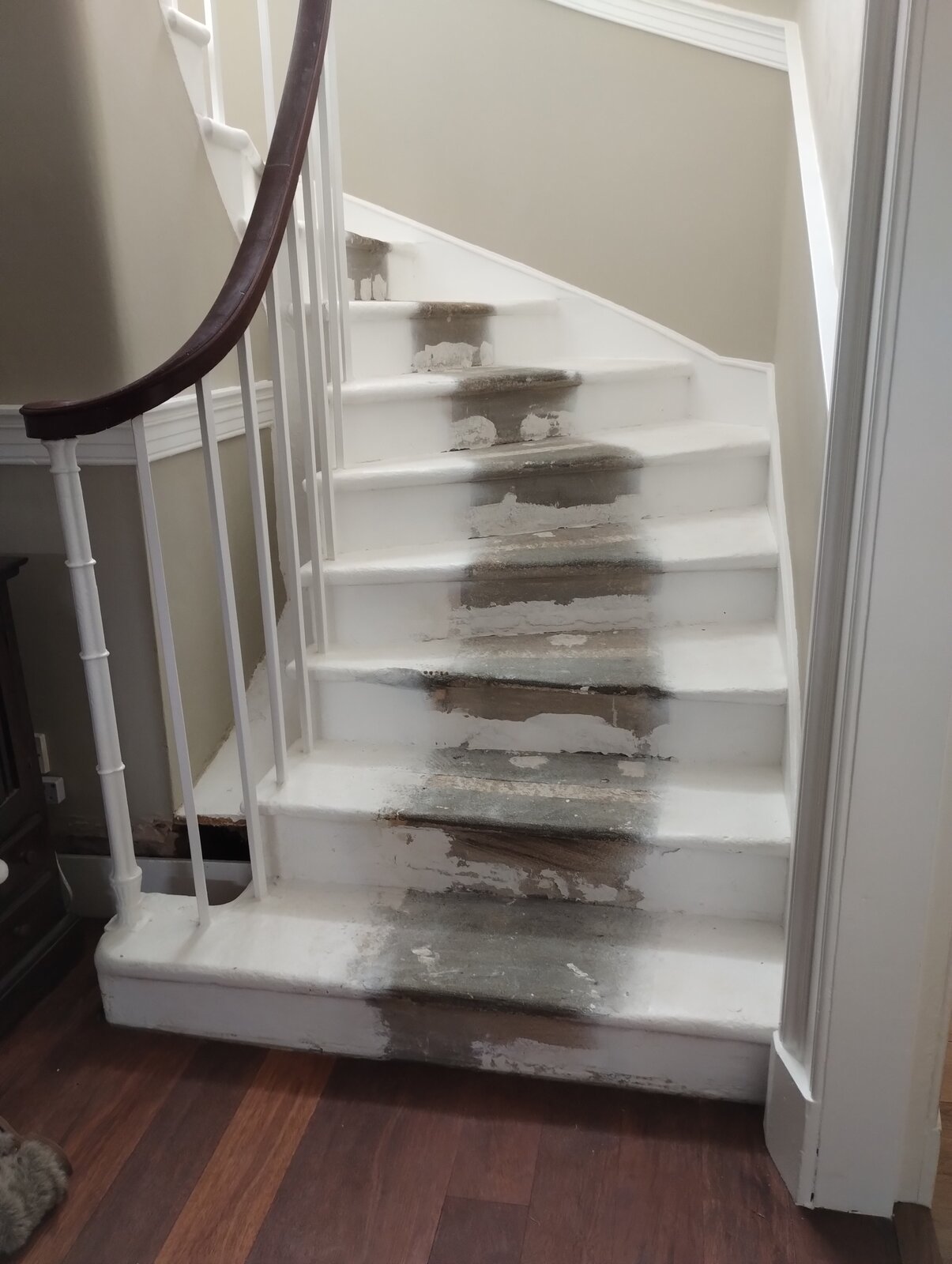

Hoping for some advice/opinions on the stone staircase in the picture. Coming towards the end of decorating this hallway, and the last thing to do is decide what to do with the stairs. It was previously covered with the same (I suspect thirty year old) wall to wall carpet that was also upstairs and from the unpainted track in the middle, it obviously had a stair runner at some point prior to that. I have already replaced the upstairs carpet with Oak Eng wood flooring and just need to decide what to do with the stair.
The original plan was to get a stair runner, but the quote of £800ish from local carpet store to supply and fit gave me pause, not just due to the cost, but it was just plain roll carpet they were going to use with edges turned under, and I wasn't convinced that it would look that good. Another option is to order an actual stair runner online and either fit myself or get someone in, which is still likely to cost £400ish for the runner plus fitting, so not a budget option but I think would look better.
The other alternative I am considering, is to just fill and tidy the stone a bit and then paint with the same white that is on the outer edges and skirting. Obviously wont be soft under foot like carpet, but both upstairs and downstairs are now solid floors, so it doesn't make much difference to have it soft in the middle, and the only considerations is how it will look and the practicalities of maintaining it. White might be difficult to keep looking clean, and maybe a different colour would be better, but only time would tell on that count, and fairly easy to keep it fresh with an occasional coat of paint.
This is not just about cost, I would rather pay £800 than it look crap. There are plenty of examples of painted wooden stairs online, but painted stone stairs are more typical outside or in communal staircases, so not a lot of examples to go on.
Any thoughts?

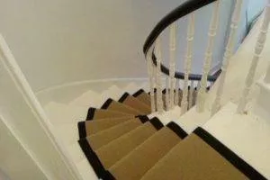

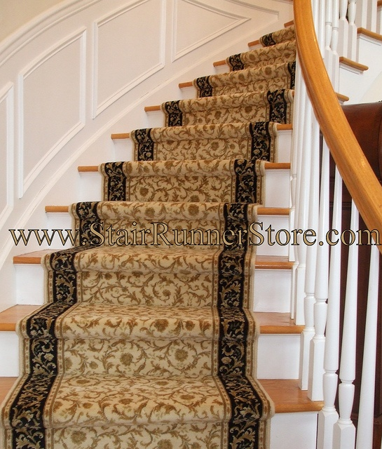

Below screen grabs give the general idea of what we are looking for.
I would probably lay odds that both those examples have every carpet step cut and stitched (or at the very least folded under and hidden under the riser carpeting - but that only seems to work on thinner carpets) and that they are either tacked/stapled to the wooden staircase beneath, or held in place with timber carpet gripper strips. You can't do that on a stone staircase with the first technique, and I don't recall ever seeing a carpet fitter with an SDS drill to fix gripper strips to masonry (they get a chippy to do that on commercial size jobs) and glue won't hack it long term
I might not live in a grand house, but 4 of my homes over the years had kite winder stairs, and they were all cut and stitch carpeted at the kite winders bar the one with gripper rods (when we moved in)

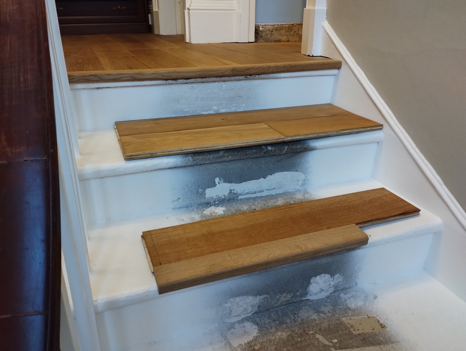

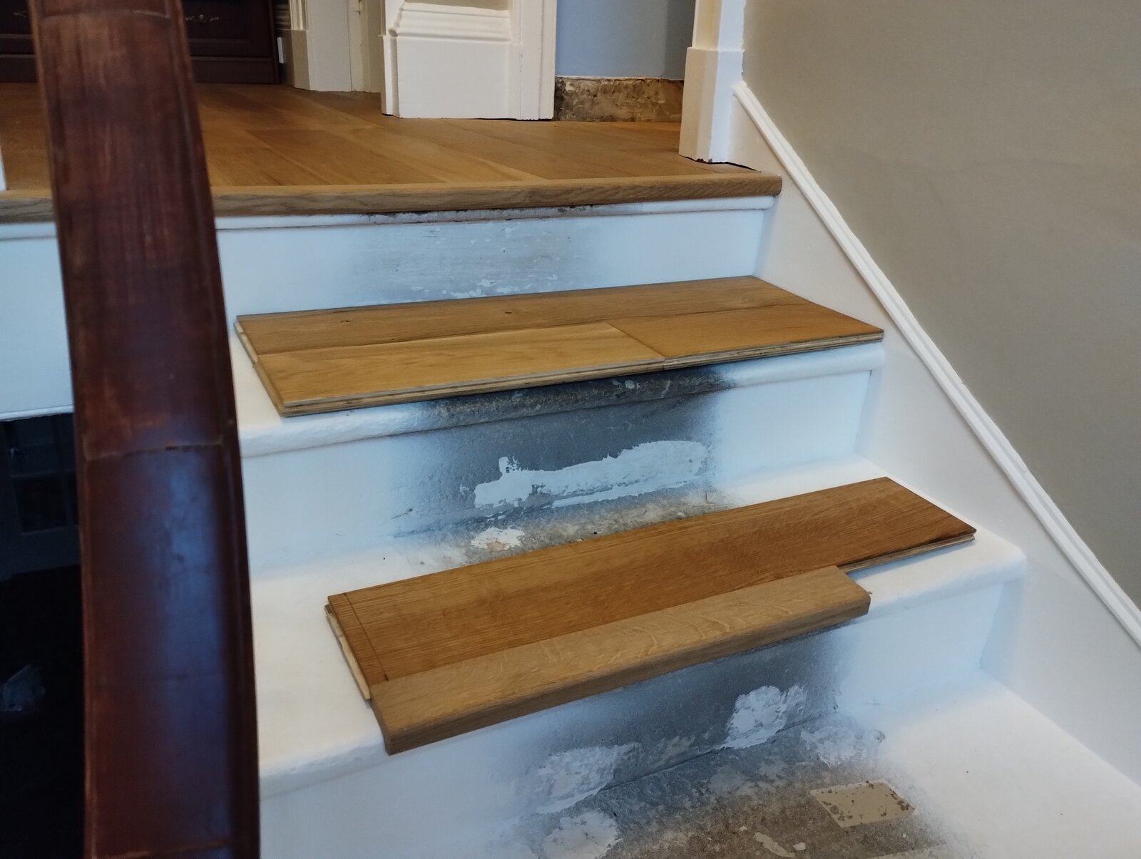

Having nearly finished all of the rooms up stairs, and with quite a bit of the eng wood flooring left, I am now considering whether I could fit this to the stairs instead. The photos below give an idea of how it might look, but the general idea was to copy the way I have done the top landing, using the flush fit T and G nosing, just fitting the wood to the treads, and painting the risers white - as you would expect its the treads that have the most damage.
There would be a fair bit of work in cutting, especially some diagonals and curves on the steps in the turn, but I think that's doable.

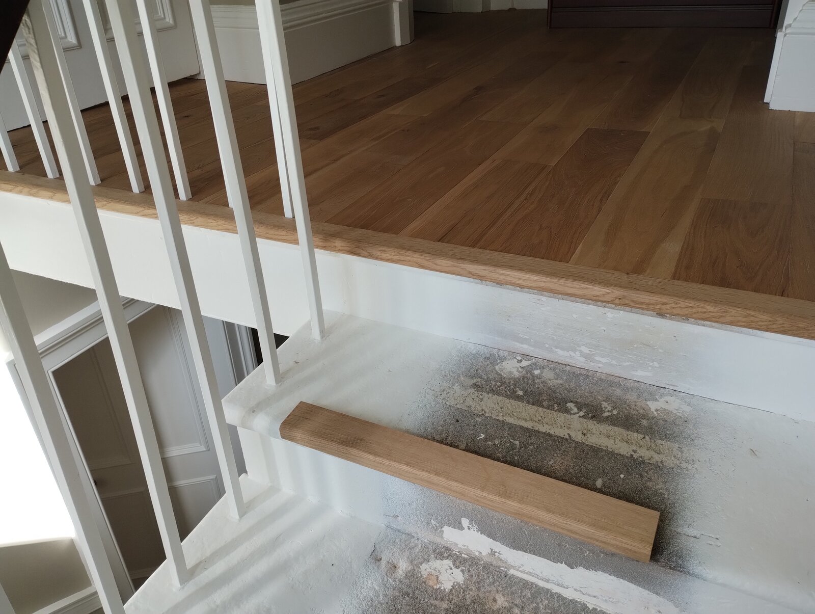

There is also the problem of the edge open edge (left side when facing). The nosing is solid ok, so a clean cut and sanding would be fine, but the cut edge of the eng wood would need to be dealt with. A few ideas here. Simplest is to just sand and paint the edge white, as a transition to the stone. Another is to try and fill the edge with oak filler (not convinced about that one but could try it on a scrap bit). Another is to edge with a veneer, or 18mm oak strip.
The main part that's outside of my previous experience, is securing the wood to the stone. I can see that there are a few different brands like Bostik Laybond, Bona, Sikabond etc, that should do this, but having never used before I don't know if these products would give a strong enough bond for a stair (from a safety point of view). I'm less concerned about the boards, which will have a lot of surface area for the bond, but the nosing might be a weak point. When I fitted the nosing on the top landing there is both adhesive and hidden screws holding it down to wood subfloor, but that's not really an option to stone.
Any thoughts or advice, much appreciated.

It sounds like more work than a stitched carpet runner...
If you want to go with the engineered flooring, perhaps use full widths and stain/seal the edges before gluing them down (potentially more waste though). I don't see a problem if you use the correct adhesive (after speaking to the manufacturer's tech team).

In the images that you posted, the runners are the same width as they go down the staircase (other than the windings).

Thoughts? Yes, just how flat are the current treads? i.e. are they worn? lf they are anything other than dead flat you'll need to address that before attempting instalation. This may require shuttering or overcladding with plywood, mechanically fixed. If the going is uneven plywoood overcladding combined with correcting the discrepancies in the going is really the only way to sort things out
Secondly, I don't think that glueing alone will be particularly safe on a staircase, in part because timber products tend to move which can lead to them detaching from a stone substrate over time. You are possibly better off considering a composite solution where the middles of the treads are glued, but the back and front edges, in the areas where mechanical fastenings such as screws can hidden beneath the risers or the nosings
Solid wood treads is another possibility because they can be drilled.and counterbored, fixed down (masonry drill, plugs and screws), pelleted and trimmed flush
