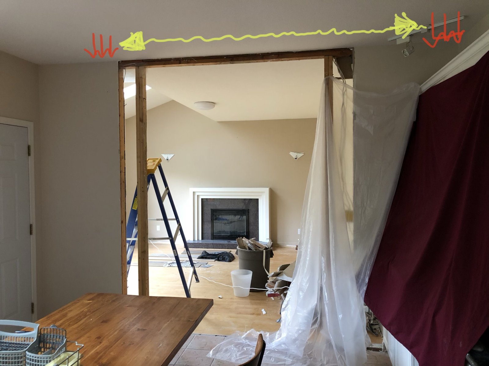

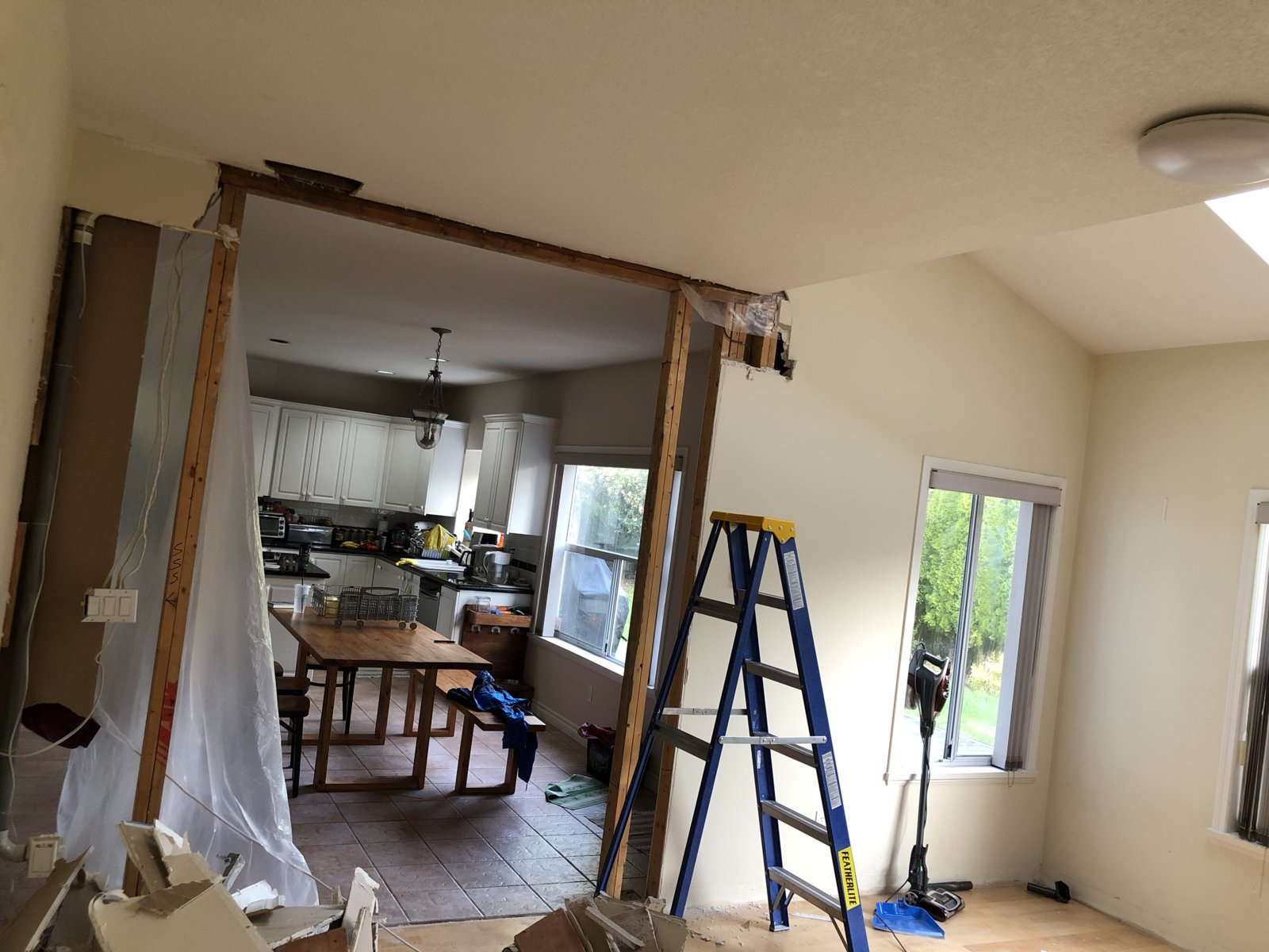

Hi, appreciate any views on the framing of this wall. (Pictures attached)
Basically, an opening, double plated, with loads on each ends. Couple notes:
+There is nothing (loads) in between the two ends (green line).
+The left side does have beam on top. The beam supports the joists for the bedroom above.
Had done a lot of research online, but nothing can address this well. Trying to see if the double plate (green marked line) can be taken out for a smooth ceiling. Thank you.
Hi,
there's a yellow line but no green lines.
however,
no, you can't remove the top plate or the double plate.

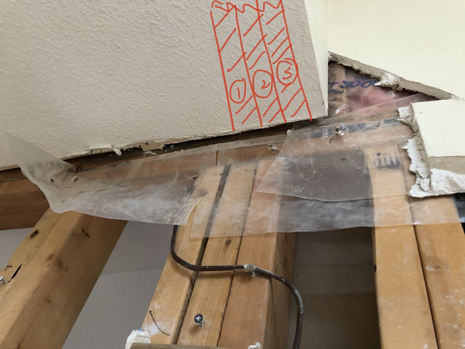

that wall was raised with the double plates tiying-in the supporting "posts" on the right - in turn, the "posts" are supporting the 1, 2, 3 beam thats carrying bedroom floor joists and studding.
dont remove any of the studs either side of the opening.
