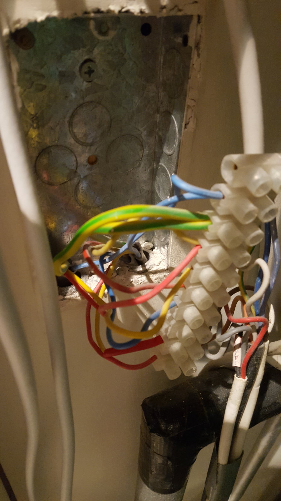

Cut through boiler cable next to the watertank.
Hi thanks for these posts
I'm so confused
I only put a nick in the blue cable (red blue yellow earth cable)
I was using a hack saw
British gas has been round tonight. Changed the cassette, checked the internal fuse, changed the pump. He tells me to get a rewire as he can't figure out what is wrong.
I've rechecked the cables, there are no other nicks present.
The wiring is as it was so what could I have damaged, how did this trip out.
There is one more cable going up to the bathroom fan isolator, I haven't taken this one out to check as it would be so hard to fish back in and it's not going to the bolier system to my knowledge.
It's the right cable, blue wireally I nicked

The photo of the terminals doesn't really help without knowing what each of the wires is connected to at the other end.
Unfortunately, there is no set way of wiring heating systems. The function assigned to each of the terminals, the colour of the wires selected for interconnecting wiring, and even the type of cables used would have been chosen by the installer according their personal preferences and the materials available, meaning every installation is different.
Is it possible that you have damaged the cables buried in the wall? didn't you say that you were cutting near the skirting? Do the cables pass behind it? Maybe the vibration alone caused a problem somewhere else.
From what I can see of the installation though, it looks very poor. I can't see an earth connection to the metal back box earth terminal top left. If that is the case, not only is it a basic electrical requirement and its absence dangerous, but a professional would never have left it like that, so I wonder what the rest is like. Also, there don't seem to be any cable clamps to secure the cables on the left either. Getting it rewired properly would seem to be good advice IMHO.

There are two issues here. One is that the heating isn't working, but even if it was, there is also the issue of the dodgy / dangerous installation shown in the photograph, unearthed exposed metal etc., and that's what can be seen. I would be seriously concerned that whoever did the work has left other undiscovered faults elsewhere, one of which maybe responsible for the current situation.
So, it really ought to be rewired in any case, or at least checked and rectified by a competent electrician. [Note; not all boiler engineers are competent electricians]
John D v2.0 is right though. It wouldn't be difficult for a boiler engineer to check the boiler in isolation from the rest of the wiring.
