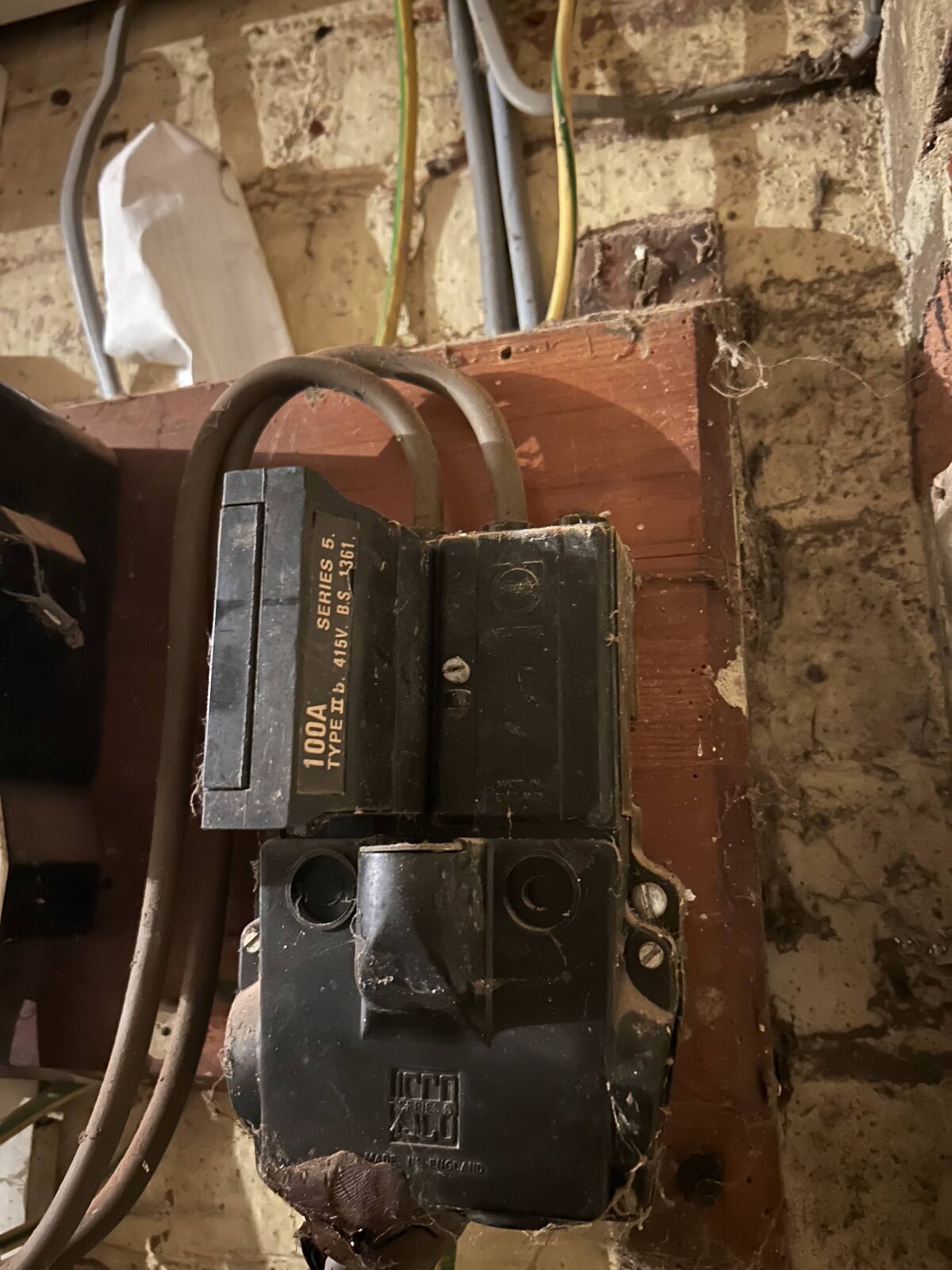

We've just acquired a hybrid car and i'm interested in whether we can get an EV charger fitted to reduce the charging time.
Our incoming supply isn't looped, we have 2 spare ways in our consumer unit and based on the markings on our cutout, i think we may have a 100amp fuse in the incoming supply. However, do the markings tell me the fuse size or is that just the max capacity of the cutout itself?
If not, as it looks like the seals have been removed, is there a cover i can remove to look at the fuse and see what size it is, or will removing the cover also pull the fuse (in which case i won't touch it!)

The 100A is typically the maximum it can be, not what it is
Can you post a photo showing your CU
100 is the max capacity of the cutout itself
No you can't remove a cover to see the actual fuse.
If you haven't got an electric shower, the supplier is likely to be ok.

The 100A label is just the maximum fuse allowed; the actual fuse might be 60A.
You are looking at it the wrong way round.
With a low supply - say 60A - and a high demand - electric showers etc. - the DNO might not allow the charger.
Do you mean that the supplier (DNO) would assume
The DNO won't assume anything.
They will require the max load of the proposed installation from whoever is installing it.
Then they will determine if that is appropriate or not, and whether additional works are required before such a load can be connected.
